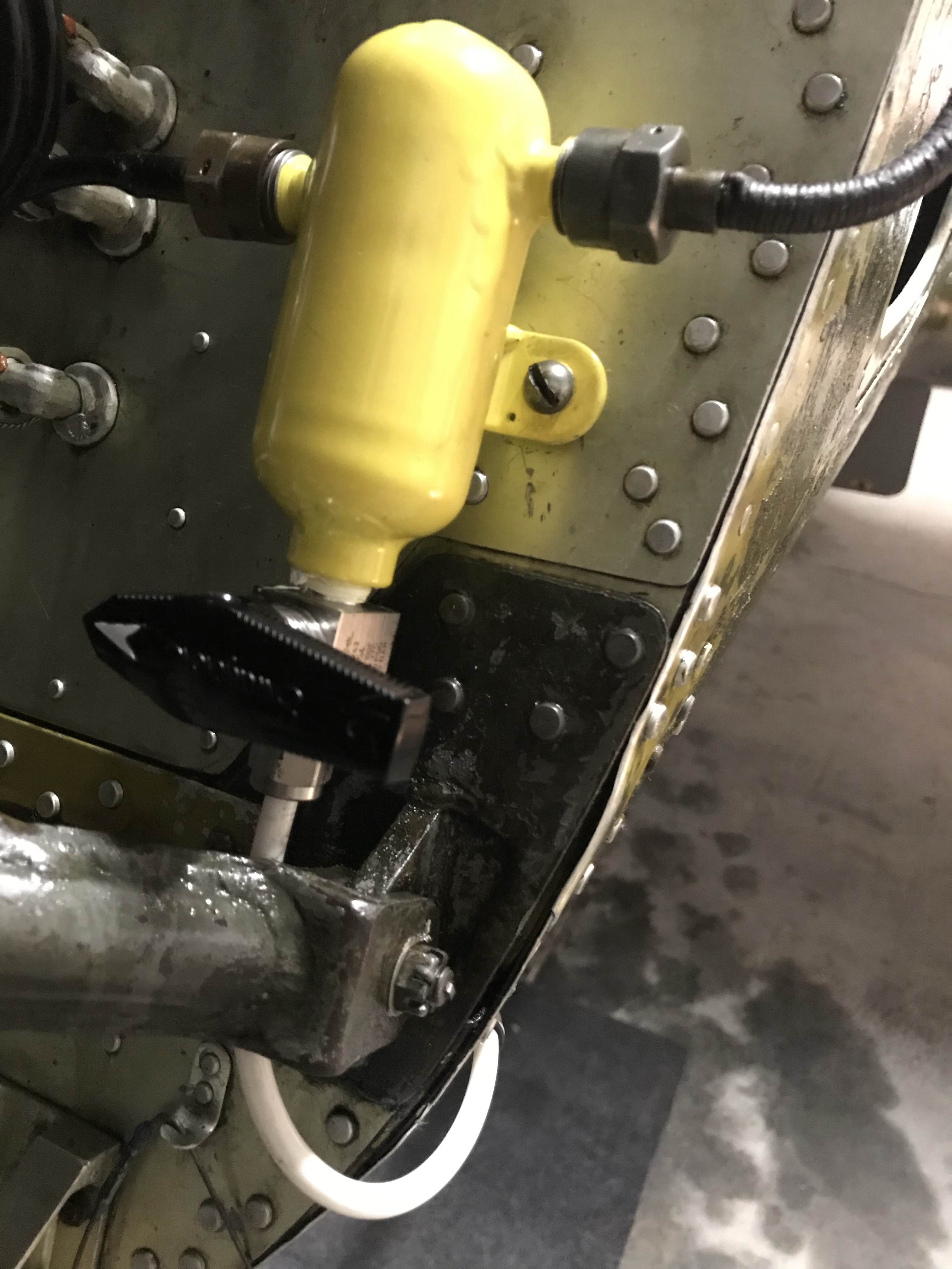

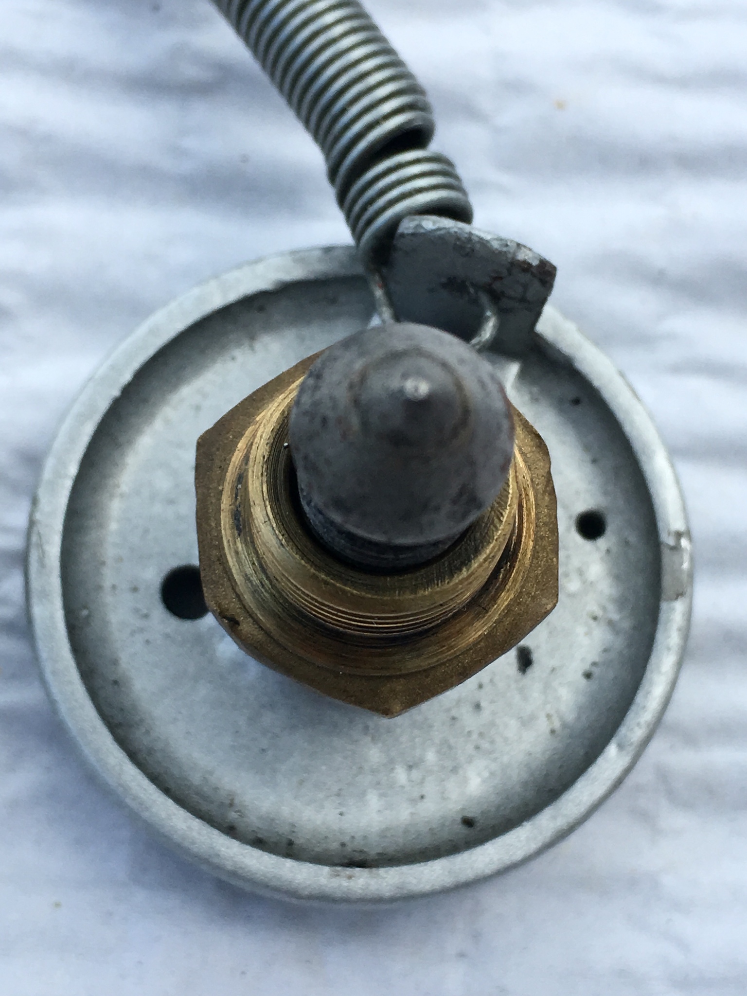

I've been dealing with a similar issue, on mine. I can charge to 50 ATMs and go fly and the compressor can't put the air back to anything higher than about 38 ATMs so I'm thinking I'm dealing with a tiny leak in the UP side somewhere. Haven't been flying for over a month due to waiting on parts, but I'm going to try and follow advice given on another Red Star site to soak the felt filter on the top of the compressor and see if it helps seal the rings. If it does, then I'm looking at a weak compressor. If not then it'll be leak detection time.
As for the snot valves. Mine started to become harder to open as they gunned up and finally started to not seal properly when closed. So I replaced mine with swagelok 1/4 turn stainless ball valves..SO MUCH NICER!!

PostPosted: Mon Dec 30, 2019 5:06 am    Post subject: Not charging much air in flight Reply with quote
That valve swap looks like the way to go.
You don’t have record of the part number for that valve handy do you. ?
Mark

pennington.construction.i
PostPosted: Mon Dec 30, 2019 5:16 am    Post subject: Not charging much air in flight Reply with quote
Dennis.
He replaced the valve on the snot valve.
Take a peek at the attached picture.
Looks pretty clean.
Mark.

PostPosted: Mon Dec 30, 2019 5:25 am    Post subject: Not charging much air in flight Reply with quote
Yes, that does look very clean. I missed the pictures. However, that does not change my comment about removing and flushing out the shot bottle.

hkgibby(at)yahoo.com
PostPosted: Mon Dec 30, 2019 5:28 am    Post subject: Not charging much air in flight Reply with quote
Your snot valve sealing brass “cone” may have a ring worn into it which prevents a proper seal and will always leak once it’s like this. Swagelok replacement valve is the answer and can also do the Main and Emerg valves and check valves on the firewall as well. Guaranteed to fix majority of pneumatic issues. Isolate and/removing of the rear gear and flap valves will solve the rest...see pic below.
Good luck- Hoot

PostPosted: Mon Dec 30, 2019 5:31 am    Post subject: Not charging much air in flight Reply with quote
You are correct.
My system ran better after soaking my snot valve in AV gas.  Per your instruction
Mark
