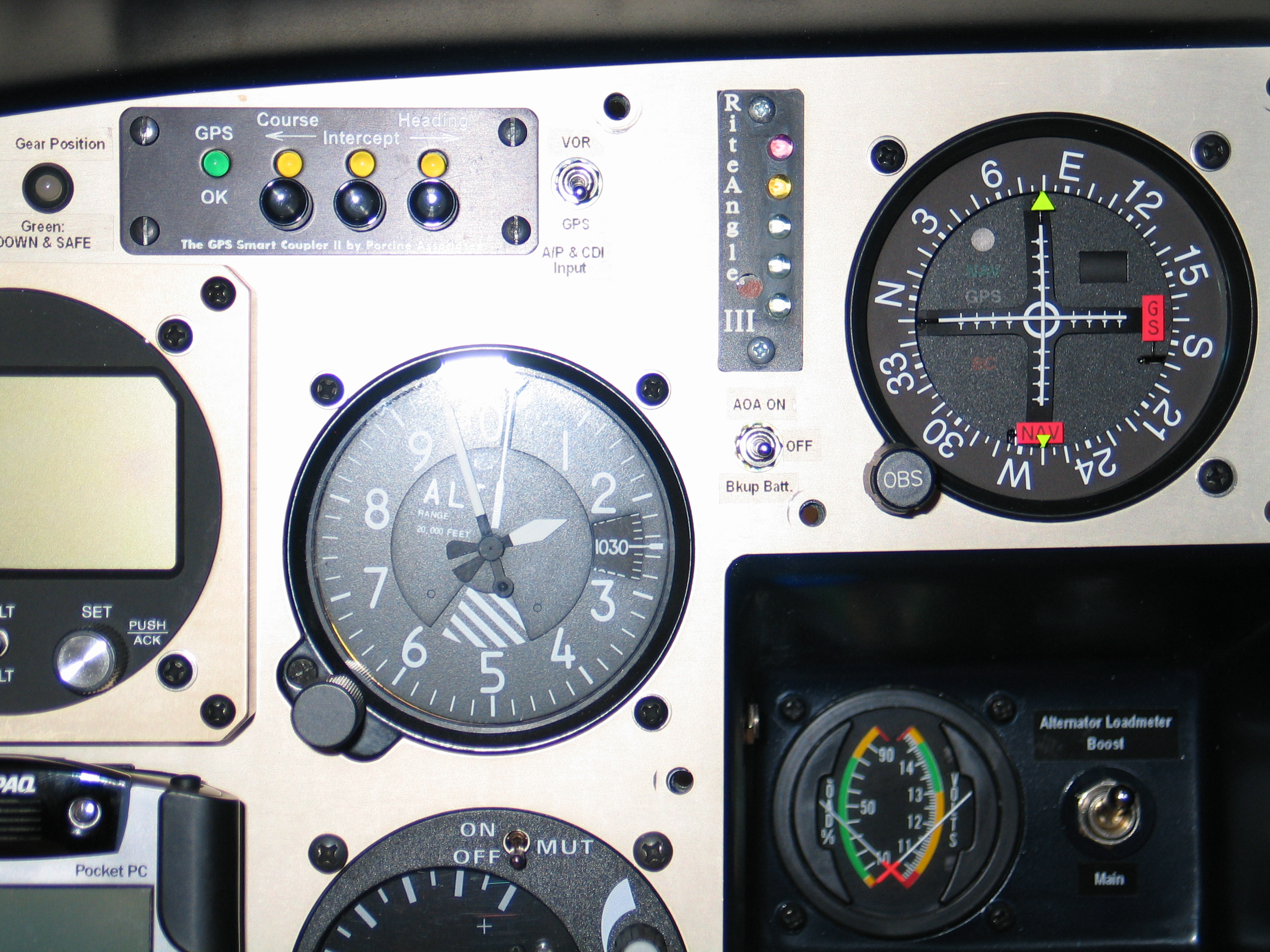

Hi Alfred,
Have you a colored Led display in the cabin? If yes, how did you route the wires etc through the wing? (N.B. I didn't build my aircraft)

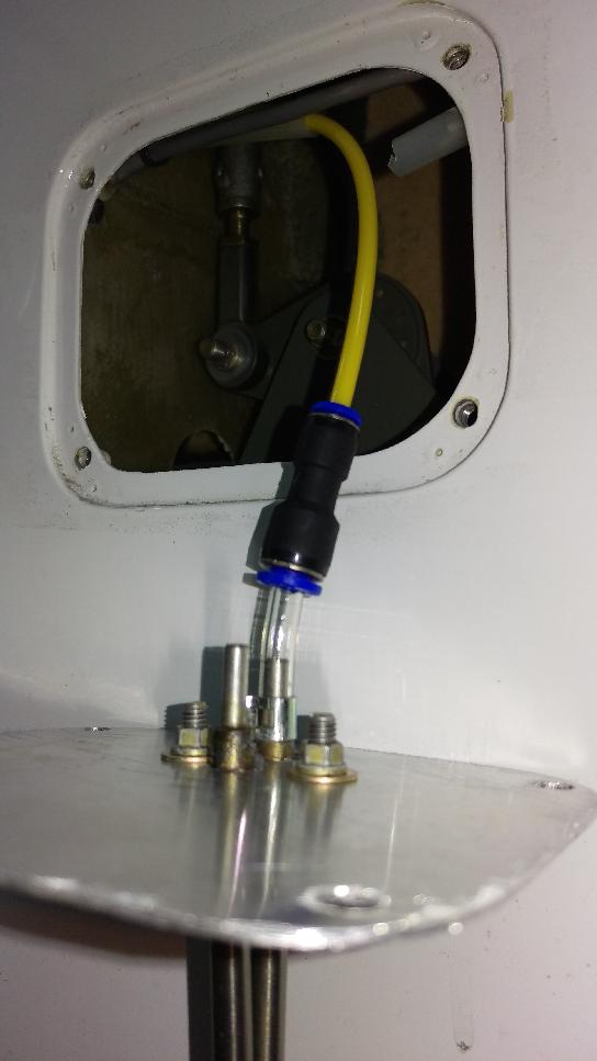

How did you feed your wires and the 2 pipe lines through the wing? Is there an accessible cavity close to the Pitot mounting position?

As I was replacing my existing non-AoA probe so I already had two tubes routed through the wing (static & dynamic pressure). I used those for dynamic pressure & AoA. I located a static pressure sensor to the fuselage instead.

Yes I have a colored LED display in the cockpit: one LED red, one amber, three green. See attached picture. The vane is mounted on the inspection cover forward of the outrigger attachment (outer flap hinge). I have the classic foam wing with a tube inside, in which the wires are routed. Alternatively you can install the wires in the flap close-out with a short tube between the aileron bellcrank access hole and the flap close-out.
Regard, Alfred

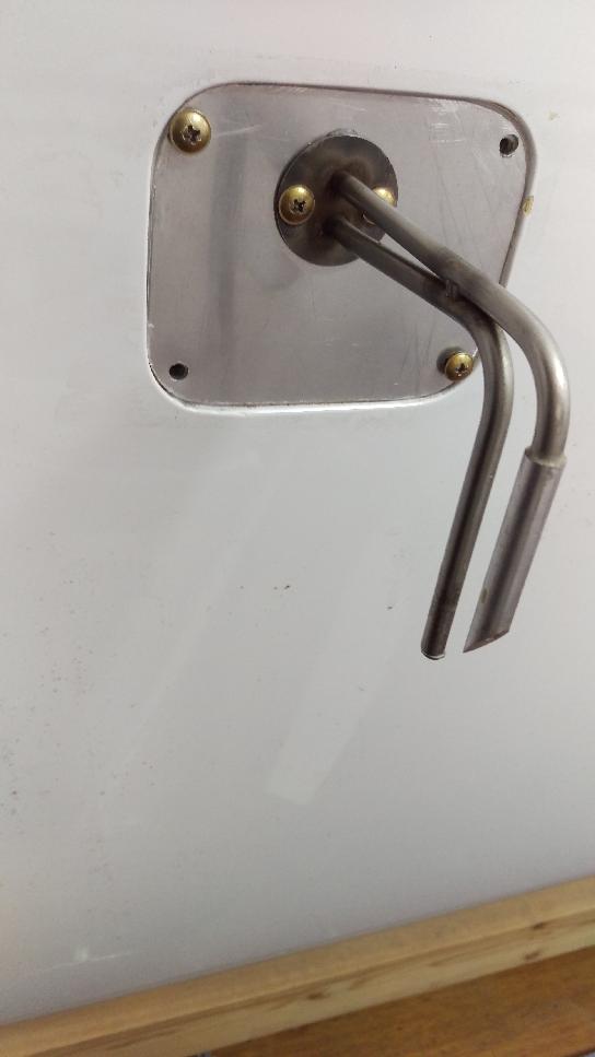

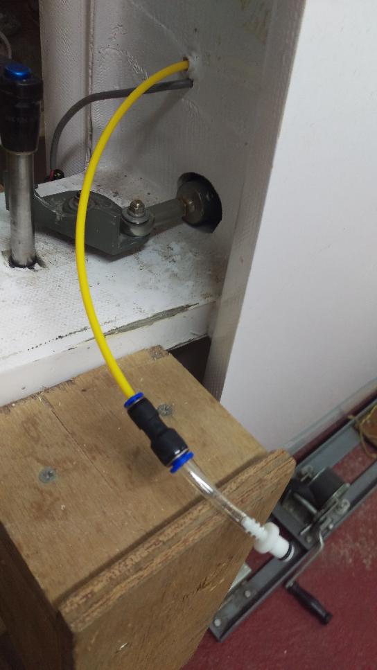

Hi James,
When Carl fitted his Dynon heated probe, he kindly gave me his original AOA probe, which I think he fabricated himself by slipping a slightly wider aluminium pipe over the original probe, and chamfering the front end to match the angle required for an AOA probe. I fitted this to the inspection panel on the starboard wing, after replacing the acrylic cover with a metal cover, and used this for my Dyson Skyview AOA gauge, and it works well. Fortunately, I had some unnecessary wiring running through the wing which I used to feed through the necessary tubing. I have attached a couple of photos.
However, I also fitted a SmartAss device after reading the article in the June 2014 LAA Magazine by David Joyce, and I must say I find the audio prompting from this great, and would thoroughly recommend it, to augment the AOA function.
Hope this helps.
