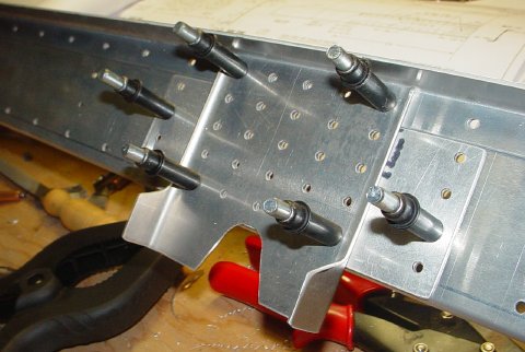

I forgot to mention that I have never built anything out of metal before.  I cut a piece of tin off the roof of the barn once.  I have 92 hrs in the tail section and half of the fuselage.  For me, it is the quality of parts I am receiving that makes my build go quickly.  Mine is truly a match and rivet quality.  My rivet lines are laser straight, rivets are flush and everything is square.  No smiles in the skins.  (Knock on wood.)  I have only had one piece that did not match up.  Below is a picture of my stabilizer rear attachment.  I did not have to drill one of those holes, nor did I have to fabricate the rear attachment.  All this was done on the machine.  You can see the time savings here alone.  My whole plane is like this.  I don't think I had to drill one hole in my firewall either.  You can see that the corners are rounded and all I had to do was clean up a few edges.  If ZAC could put out parts like this, they could hit their mark of 500 hrs.  Again, I am LUCKY in having access to the CNC machine.  Having built from these parts and the rudder from ZAC parts.  I could see that someone like myself, it would take longer than 500 hrs.
Larry Husky
Lakeview, OR
601XL / Corvair
Building Fuse
