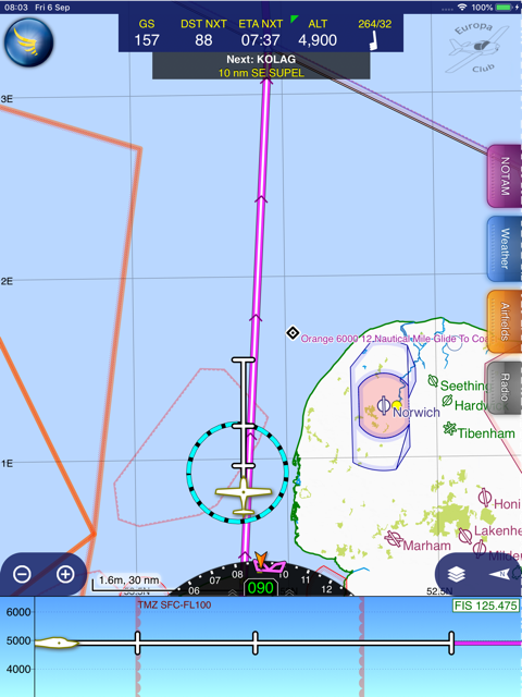

PostPosted: Thu Sep 05, 2019 11:17 pm    Post subject: Re: Glide Ratio Reply with quote
Hi David
After much testing. I decided to go with 12:1 for my XS Mono
I incorporate the distance in Sky Demon. A software feature then portrays the gliding distance available based on this assumption.
The software takes into account altitude, wind direction and topography.
A picture is worth a thousand words. See picture attached.
Bob
