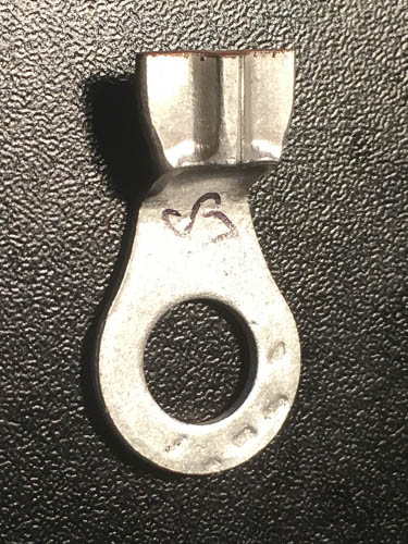

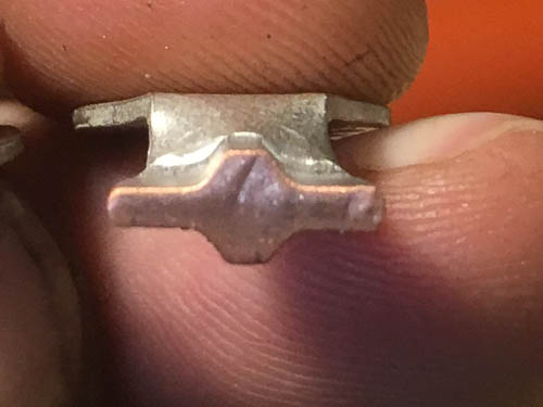

Test #1. Using jaws labeled for 8 AWG.
Hex opening in them is much smaller than the wire.
Notice how it's this weird pinched, rather than hexagonal, shape (especially well obvious on the cutaway pic). Also, crimping adds this weird "jog" to the length of the terminal. Overall though, aside from the strange shape, very good crimp. Note: on cutaway, the "spots" are dust specs I caught in the pic and noticed just now Sad. They are not crimp defects, like in test #3 below).

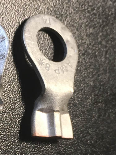

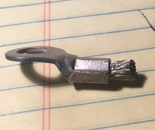

Test #2. Using jaws labeled for 6 AWG.
Opening is still smaller than the wire.
Initially, here, I got those "wings" to the crimp, too; but then I turned the crimp 90 degrees and crimped it again, "smashing them in". Notice how mangled up that whole business is (and without "smashing in" the "wings", it looks just like the #8 jaws crimp; just with thinner "wings").

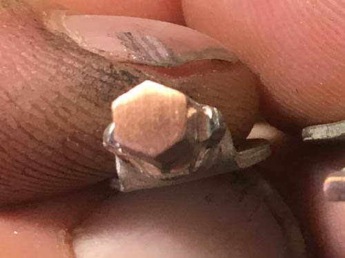

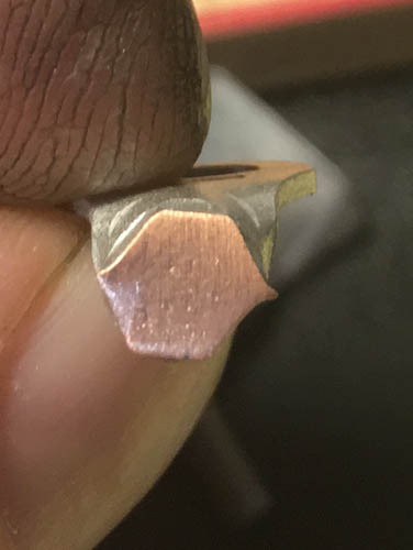

Test #2. Using jaws labeled for 4 AWG.
This procuced a nice hex, as expected; and no surprise - the opening on the jaws is just about the same size as the wire; so with added thickness of material from the terminal itself it went well.
However, notice on the cutaway you can see some "spots" - those are "cavities", so makes me thing that it could've been compressed just a tad more.
