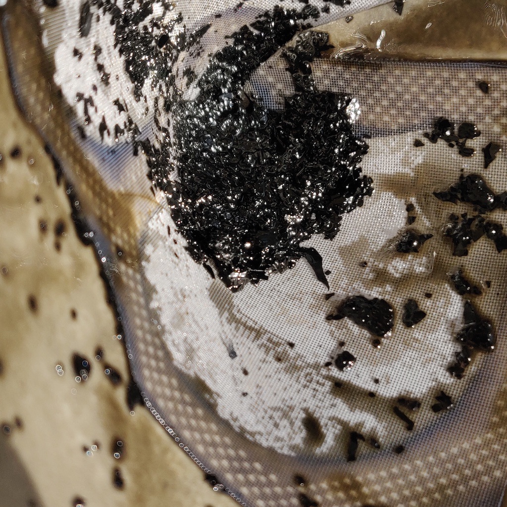

As I've written here before, this is my issue/concern. With my sortof unknown but seems to be first run based on case stamp, well-pickled from China, Housai (no logbooks), I had lots of carbon clog the sump screen about 20 hours into first flying (I installed a oil filter that had almost NO carbon flecks, and the other screens were clear). Yes, I know now that I should have been watching that sump screen like a hawk - it is easy to check/clean just about anytime.
For the last 100 hours, I've checked the sump screen every 10-15 hours, and started out with about 1 teaspoon of carbon, now down to about 1/2 teaspoon. And before anyone gets bent about the photo - that is less than 1/2 teaspoon at the bottom of a 100 micron paint filter. Smile
I am reluctant to add MMO, in case it shakes loose even more carbon, "quickly". But, before this next oil change, I will probably add a couple quarts and fly for 1-2 hours. Boroscopes of valves, etc., all look good, btw.
