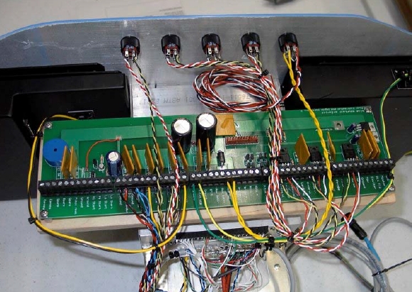

The TC aircraft world flirted with these
critters on several occasions where
I participated . . . and there were
no doubt others.
There are several power distribution
products offered to the OBAM aviation
community that feature Polyfuses.
One of the earliest examples is the
EXPBUS
[img]cid:.0[/img]

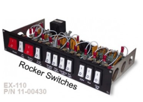

Greg Richter was a proponent of Polyfuses
in his designs. One proposal for light
aircraft power distribution took this
form:
[img]cid:.1[/img]
(We had quite a discussion about both products
which have been archived on AeroElectric.com
if anyone is interested. Search on expbus
or polyfuse.
But suffice it to say that Polyfuses are not
well suited for protection of power distribution
feeders in aircraft. They are well suited to
protection of circuitry WITHIN an electro-whizzy . . .
indeed, they're sold by the millions for that
purpose. They've alos found utility on some
automotive applications . . . like providing
electrical limit stops for power windows.
