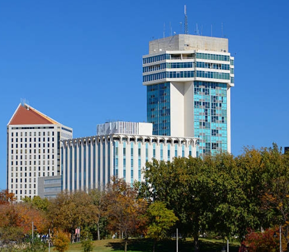

Just for grins, snatched a recent photo of
that building
[img]cid:7.1.0.9.0.20190603204853.05ddeb88(at)aeroelectric.com.0[/img]
It's still got an aluminum whisker-farm
growing out the top . . . brings back
memories. Last time I was up there it was
over 100F and no breeze . . .
