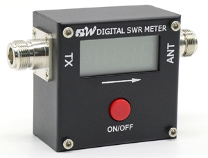

A very reasonable test tool for pursuing
this investigation is seen here:
https://tinyurl.com/y64t9nse
[img]cid:.0[/img]
(caution, there are both VHF/UHF and
HF versions . . . get the VHF/UHF
device)
You'll probably also need a two-pak
of these adapters:
https://tinyurl.com/y66wn6ua
and a short BncM to BncM jumper cable
https://tinyurl.com/y3b7lvfp
[img]cid:.0[/img]
    device)
   of these adapters:
