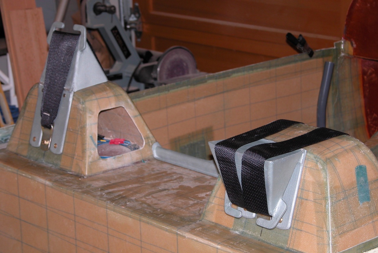

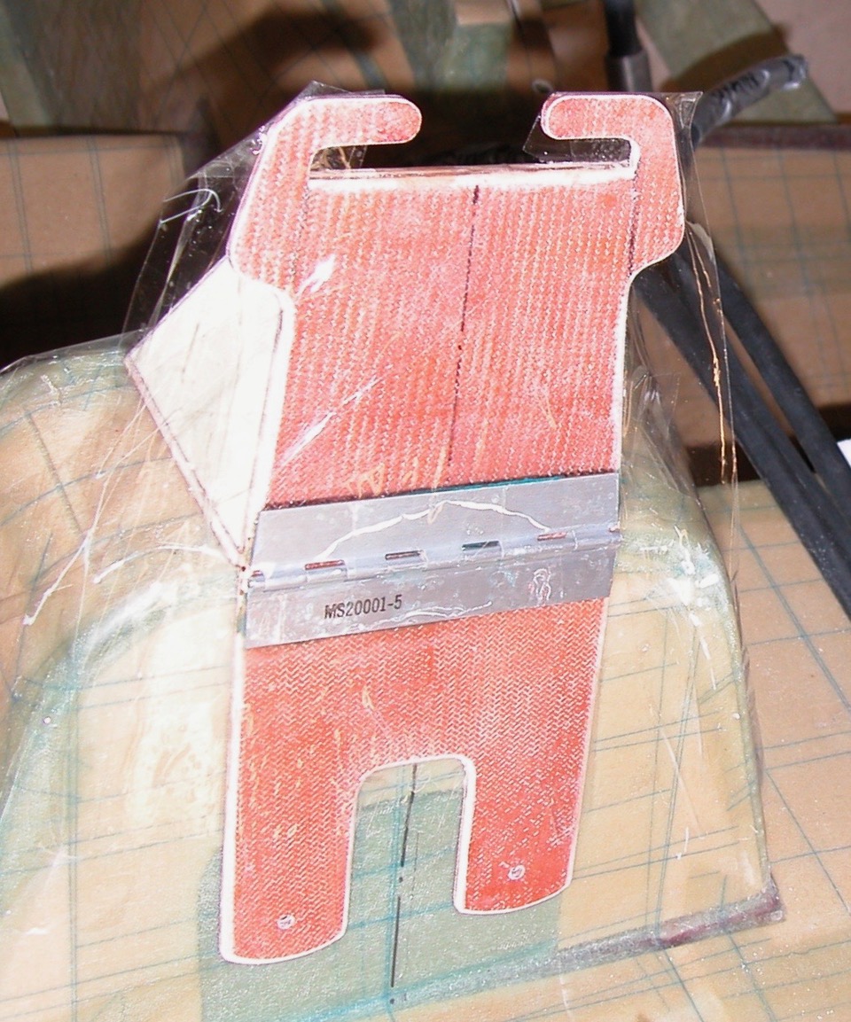

Noting that compressive spinal injuries can result from the geometry of the shoulder straps and seat back in the Europa in the event of an accident or even just a hard landing, I fabbed these hinged risers which eliminate the downward component of the resultant forces. Attached to the shoulder harness embedment, the riser was tested with a hydraulic press by applying 1500# (10 G’s, assuming 150# upper body weight) force forward across the slot which captures the straps.
In the down position, they permit normal entry and exiting; when you’re seated and slip into the shoulder straps, the straps raise the riser to the upright position…”works a treat”.
Made from scraps of 1/8” plywood, 1/8” Lastafoam, and BID, they weigh about a pound a piece…happy to share details upon request.

Hi Fred
By coincidence, I was just trying yesterday to remember who had created that mod - I’d be very grateful if you could supply some details as I am about to move on to the seats and I’m tall enough to worry about downward forces from the seatbelts!
Kind regards

Fred,
Please send details!
 Including if you have them the results of any load testing, which is currently (?) the 'sticking point' with LAA in the UK. Not that the load tests would be difficult; just need doing.
BTW up to 40g momentarily has been shown to be survivable, not that the geometry of the modification would itself take anywhere near that directly.
