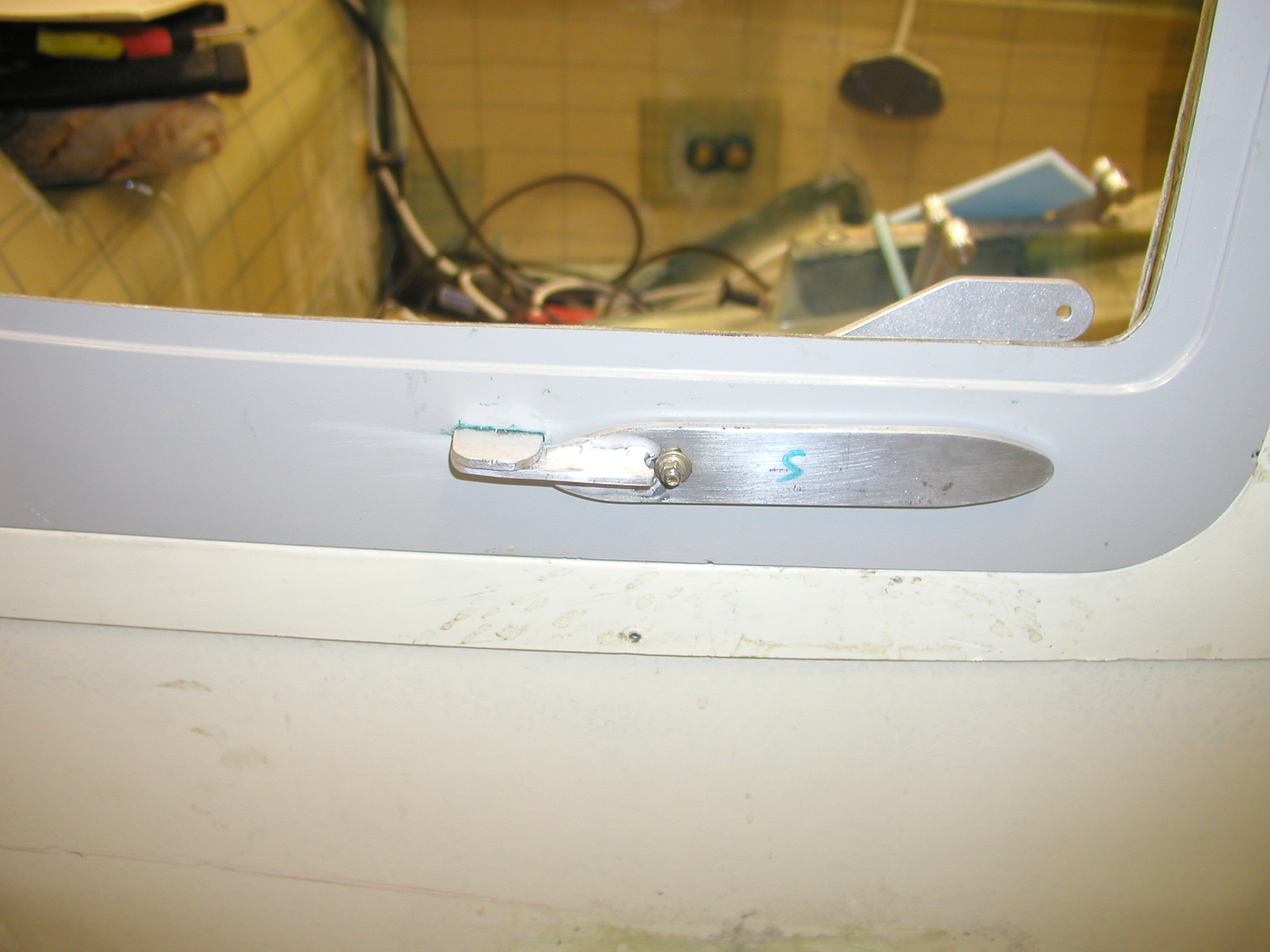

PostPosted: Thu Nov 29, 2018 3:26 am    Post subject: Re: Securing the aircraft Reply with quote
Hi what I did more from a visual point of view is added a bracket to the
Rear of the outside handle that I subsequently drilled a hole vertical down
Through both handle and bracket so a padlock could be used,
It’s a good deterrent IMO but obviously wouldn’t stop a determined toe rag
I also use a cover when left at a unattended airfield,
