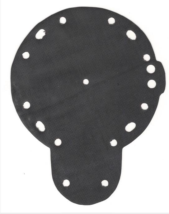

Here is a picture of a carb membrane for an M14P from a Yak52. Installed it last week.
