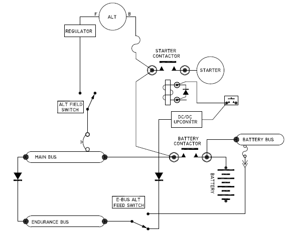

So, with the one-battery per airplane design goal in
mind and CBOTs still lurking in the wings, I would offer
the architecture below for the List's consideration:
[img]cid:.0[/img]
DC to DC up-converters are jelly-bean parts. Dozens
of candidates are available for less than $10 which
will boost 10 or so volts, depressed battery to 14v . . .
well above the roll-over voltage for potential CBOT
victims.
With the architecture shown above, the e-bus boost
feature is available only while the e-bus alternate
feed switch is in the NORMAL position . . . and only
while power is being applied to the starter contactor
via crew controlled push button.
The DC/DC converter can be of any pedigree since
(1) it's never active during normal ops (EMC issues
disappear)
(2) functionality is pre-flight tested every flight
cycle.
(3) It is not a safety of flight issue since it's
only active for tens of milliseconds during
cranking -AND- failure of the converter does
not disable any accessory neeed for comfortable
termination of flight.
(4) Since it is active for perhaps a second each
flight cycle and average utilization of the
light aircraft is less than 100 fligh cycles
per year, the service life of these devices
should exceed lifetime of the airframe.
If there is a 'downside' to this approach, I suppose
that it causes the crew to 'load' the ship's battery
for preflight ops such as ATIS and clearance collection.
But recall that we're assuming that the ship's battery
will be sized and maintained to meet design goals. In
the normal world, cranking the engine takes perhaps 5%
of battery capacity. Preflight ops of electro-whizzies
should require no more than that. That energy will be
replaced in the first few minutes of flight.
I humbly suggest that the technique cited above
will deal with 100% of CBOT issues at zero cost of
ownership beyond initial purchase and installation
of the system and zero impact on system reliability
and performance. It also encourages the owner to
conduct due diligence in the maintenance of the
ship's battery since there are NO standby batteries
tending to lull one into a false sense of system
reliability.
Cogent arguments pro and con are most welcome.

Bob,
That looks very clever. I think that it will work.
Is my logic here correct? For my plane, which has two alternators and no endurance bus, I would create an "EFIS" bus, running only the EFIS, and fed via two diodes, one to the main bus and the second to the DC/DC upverter.
For those of us who don't live and breathe this stuff, can you post a few typical part numbers for the upverter and the diodes? Or typical specs?
Thank you for attending to this issue.

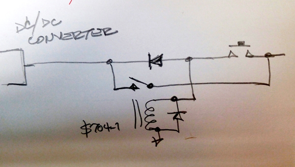

Am I correct in assuming that the right hand side of the start push button should be tied through a fuse to the main bus?
[img]cid:part1.C616506B.5E3BB379(at)gmail.com[/img]
victims.
    disappear)
    cycle.
reliability.
I like it; I might try it out on my old RV-4 electrical system. It's a pretty simple, crude system, but the Matronics  fuel flow meter reboots on startup. Only potential downside I can see is that some avionics systems may well draw a total of 5 or 6 amps. If battery voltage drops down in the 8-9 volt range, you could see an additional 8 or 10 amps of load on the start PB. There are some planes out there that have the start PB  feeding a starter with built-in solenoid/contactor; in those cases, the PB may be pretty heavily loaded.
I toyed with the idea of using one of those 'switchers' to replace the isolation diode if I'd used a dual battery system (instead of the dual alternator system chosen) on my electronic injected engine installation.
Charlie

Clever idea, Bob -- I like it!
As Charlie mentioned, the current drawn by the DC-DC boost converter could be significant, and would of course increase with decreasing supply voltage. There's also the likelihood of substantial inrush current at start-up. Unless an adequately beefy start switch is specified, its contacts might suffer from making and breaking this load.
This problem might be mitigated by powering the DC-DC boost converter either from the load side of the starter contactor (in parallel with the starter) or via a cube-type automotive relay. This would also simplify adding this design as a retrofit, since the start switch wiring/CB/fuse would not have to be upgraded to carry the boost converter's supply current.
A bit of eBay searching resulted in several potential candidates for the boost converter. These first two are quite small and conveniently packaged; they appear to be the same unit in different enclosures. Power output might be marginal and their 11V max input might be an issue:
not really a hard-over concern. at 100 flight
cycles per year max, even a marginally 'over taxed'
switch would have a good service life.
Inrush to the dc/dc converter itself wouldn't
be bad either. Remember, the converter is simply
shouldering a load that is already powered up.
I wired it as shown so that in the milliseconds after
start switch closure until the contactor closes, the
converter has time to come up and shoulder the load.
Another feature to be explored is drop out delay in
the starter contactor caused by slow decay of coil
current through the catch diode. When the start
button is release, boost drive goes away.
The start button is held until the engine catches
and starter current drops dramatically. Hopefully
battery voltage will have returned to a value that
supports appliances vulnerable to CBOT.

I am pondering some other power switching protocols with
a goal of seamless integration into the z-figures. But
if puss came to shove, one could simply add an "E-BUS BOOST"
switch that is turned on before engine start and turned
off afterward.
I have one of these for testing https://tinyurl.com/ybqnl8fj
I would set this critter to 15 volts with a 0.7 volt diode
drop to give an e-bus boost of 14.3 volts or thereabouts.
This would be about 2 volts higher than the open circuit
on an SVLA battery.
I'll measure it's ramp up time to make sure it will shoulder
the e-bus in the time it takes for a starter contactor
to close. Don't wait on me for this tho. I'm hip deep in
older commitments. Wanted to give you guys the heads-up
just in case the sum total of our efforts can outpace
what I can offer individually just now.

Bob Nuckolls wrote:
I wired it as shown so that in the milliseconds after start switch closure until the contactor closes, the converter has time to come up and shoulder the load.
That makes perfect sense. My suggestion would have caused the DC/DC converter to start up as the bus voltage was sagging, losing the time advantage inherent in your schematic.
I would set this critter to 15 volts with a 0.7 volt diode drop to give an e-bus boost of 14.3 volts or thereabouts. This would be about 2 volts higher than the open circuit on an SVLA battery.
I saw those too... The 10V minimum input seemed possibly marginal, though you might find that they're happy to work below that level. The converter at this link claims to operate down to 5V and to output 6A.
That said, Joe's comment about exaggerated Chinese specs is right on. Amperes in China seem to contain about half as many electrons as amperes in the rest of the world!
Bob Nuckolls wrote:
Another feature to be explored is drop out delay in the starter contactor caused by slow decay of coil current through the catch diode. When the start button is released, boost drive goes away.
The start button is held until the engine catches and starter current drops dramatically. Hopefully battery voltage will have returned to a value that supports appliances vulnerable to CBOT.
If this proved to be a problem, we could craft a system that sequences start events. The attached schematic is my first pass at it. I used a TLC3704 quad comparator (for its push-pull outputs), two relays and a handful of jelly-bean parts. It's a bit of a dog's breakfast, but it should work.
When the start switch is pressed, Q1 turns on, completing a ground path for K1 to energize. The output of comparator U1.1 immediately goes high, which in turn (through the diode-OR network of D2 and D3) causes the output of comparator U1.4 to go low, energizing K2 through Q3, which powers the DC/DC boost converter to support essential avionics. C2 charges through R4, taking about 100mS to reach 7.6V, whereupon the output of comparator U1.2 goes low, energizing K1 through Q2, which in turn energizes the engine starter contactor. C3 charges through blocking diode D1, causing the output of comparator U1.3 to go high, reinforcing the signal at U1.4 pin 10.
When the start switch is released, R1 immdiately turns off Q1, causing K1 to drop out, cutting off the engine starter contactor. R1 also turns off the output of U1.1, but the high at U1.4 pin 10 is held by the output of U1.3. C2 discharges through R4 and the output of U1.1, causing the output of U1.2 to go high (this has no effect, since Q1 has already turned off K1). C3 discharges through R5; after about 100mS C3 drops below 4.4V and the output of U1.3 goes low, causing the output of U1.4 to go high, turning off Q3, K2 and the DC/DC boost converter.
Critiques welcome!

PostPosted: Fri Oct 12, 2018 9:23 am    Post subject: A brown-out alternative? Reply with quote
At 12:40 AM 10/12/2018, you wrote:
--> AeroElectric-List message posted by: "Eric Page" <edpav8r(at)yahoo.com>
Good work. Now my concern is that when the starter button
is released, does the boost disappear too soon? i.e. before
the starter contactor releases and unloads the battery?
If this is a demonstrated concern, power to the dc/dc
converter might be simply conditioned with a relay thusly:
[img]cid:7.1.0.9.0.20181012121531.05b282e8(at)aeroelectric.com.0[/img]
The S704 relay will have its own drop-out
characteristic which can be crafted to be
LONGER than the starter contactor. If the diode
alone doesn't offer a suitable delay, replace
it with a capacitor . . . no need to 'tailor'
it to any close tolerance . . . 100mS of
dropout delay would not be out of line.
 Filesize:  139.05 KB

Eric Page
Joined: 15 Feb 2017
Posts: 279
PostPosted: Fri Oct 12, 2018 1:59 pm    Post subject: Re: A brown-out alternative? Reply with quote
Bob Nuckolls wrote:
Now my concern is that when the starter button is released, does the boost disappear too soon? i.e. before the starter contactor releases and unloads the battery?
The circuit does delay shut-off of the boost converter.
Press start button: boost converter powers on immediately, then after ~100mS delay, engine starter spins.
Release start button: engine starter stops immediately, then after ~100mS delay, boost converter shuts off.
The starter-on and booster-off delays are easily customized by adjusting the values of R4 and R5, respectively.
However, your last drawing is certainly a simpler, lower-parts-count solution! Ah well, I still enjoyed thinking it through...
Eric
PostPosted: Sat Oct 13, 2018 7:46 am    Post subject: A brown-out alternative? Reply with quote
That's the only way to get 'better' . . . better being
defined as steps toward the elegant solution.
Used to really p-o my techs when I would ask, "okay,
you got it working to spec . . . now . . . how many
parts can you take out and still meet the spec?
Problem was that it was almost never a simple
goal of part reduction, it often called for
an alternate approach.
In this case, I'd like to evolve an approach
that appeals to the largest audience. Especially
those with limited hands-on, DIY skills for
electronic fabrication. Using a relay to achieve
sequencing goals is pretty crude . . . but the
simplicity is appealing.

PostPosted: Sat Oct 13, 2018 10:07 am    Post subject: A brown-out alternative? Reply with quote
WHOOPS LEFT HAND SIDE?
On Sat, Oct 13, 2018 at 2:00 PM FLYaDIVE <flyadive(at)gmail.com (flyadive(at)gmail.com)> wrote:
Bob:
Just a quickie...
Looking at the schematic...
B+ coming in on the Right Hand Side?
If so, wouldn't the relay be energized all the time the B+ is turned on?
And the momentary switch not being required?
Barry
On Fri, Oct 12, 2018 at 1:28 PM Robert L. Nuckolls, III <nuckolls.bob(at)aeroelectric.com (nuckolls.bob(at)aeroelectric.com)> wrote:
--> AeroElectric-List message posted by: "Eric Page" <edpav8r(at)yahoo.com (edpav8r(at)yahoo.com)>
 Filesize:  139.05 KB
 Viewed:  48263 Time(s)
 Filesize:  139.05 KB
BARRY CHECK 6
Joined: 15 Mar 2011
Posts: 738
PostPosted: Sat Oct 13, 2018 10:13 am    Post subject: A brown-out alternative? Reply with quote
Bob:
Just a quickie...
Barry
 Filesize:  139.05 KB
 Filesize:  139.05 KB
donvansanten(at)gmail.com
PostPosted: Sat Oct 13, 2018 10:27 am    Post subject: A brown-out alternative? Reply with quote
Barry, B+ is on the right side and I belive the momentary switch is the starter switch.
On Sat, Oct 13, 2018, 11:13 FLYaDIVE <flyadive(at)gmail.com (flyadive(at)gmail.com)> wrote:
Bob:
Just a quickie...
Barry
