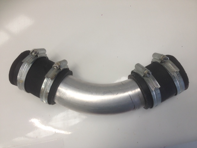

PostPosted: Sat Sep 01, 2018 3:26 am    Post subject: Aluminium Fuel Pipe Reply with quote
Hi Rob,Thanks for your email. Just confirm this pipe is for the XS model or Monowheel with the Mod to the fuel intake with larger baggage capacity. The fuel flows through the side intake, down the cobra white plastic and then the pipe, I supply.
See photo.
If that is what you want then I need your address and I will charge you through PayPal £25 plus postage.

UK LAA approved. £25 plus postage
See UK Europa Club website for details under:
https://www.theeuropaclub.org/the-club/sales-and-spares-member-adverts/xs-aluminium-fuel-bend

[img]cid:0C635558-4372-4DCB-8F11-995DE6577FD8[/img]

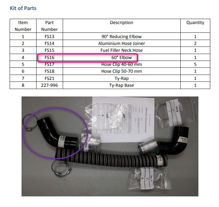

PostPosted: Fri Sep 07, 2018 11:14 am    Post subject: Aluminium Fuel Pipe Reply with quote
Europa also supply a silicone elbow (FS16) as part of Mod 79 (http://www.europa-aircraft.co.uk/updates/mods.php) or (http://www.europa-aircraft.co.uk/upload/Modification%20Bulletin%20No%2079%20(Issue%2003).pdf)
It's about GBP46 + shipping + VAT... might be worth a call...?

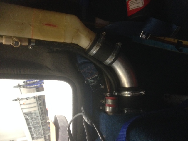

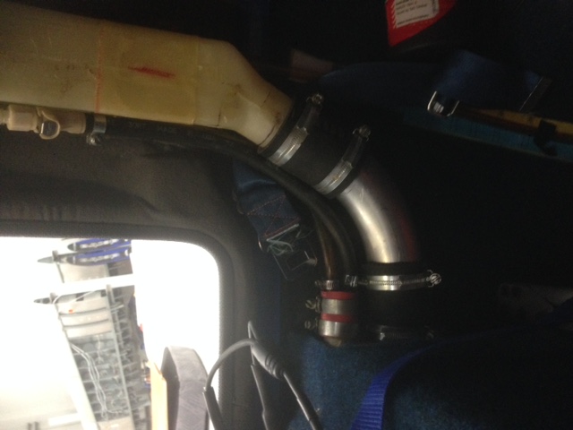

PostPosted: Sun Oct 07, 2018 1:10 am    Post subject: Re: Aluminium Fuel Pipe Reply with quote
Roland wrote:
I got a 60° elbow silicone fuel resistant hose with 15cm legs manufactured from Samco (bought via Merlin Motorsports) to replace the original rubber hose. The legs can be cut to length if need be. It costs 67,96 GBP + VAT + shipping.
This way you avoid additional connections. The fuel smell in the Cockpit was gone.
Hi Roland, do you pictures available that demonstrate how these are fitted? I guess you meant that you can do with the rubber joining? If so, I really like that approach.
What's the ID of the hose that you ordered? Reason for asking is that you mention 15cm legs, where Merlin's website only shows that length of 102mm ID, so I'm a bit puzzled now. How much length of legs did you actually end up in your install?
