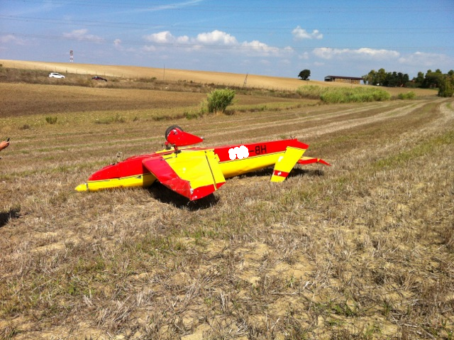

I can confirm the 406 does work, I had a friend of mine where the plane flipped over on an emergency landing
[img]cid:part1.7A666E52.5E6642DB(at)gmx.net[/img]

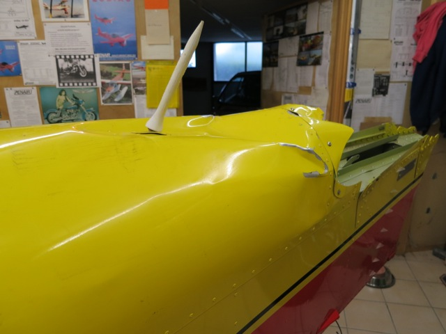

His antenna was on the top before the fin
[img]cid:part2.AAB1ED83.50E780AC(at)gmx.net[/img]
and even being inverted and antenna partly damaged the SAR helicopter was on site in a very short time!
Cheers Werner
