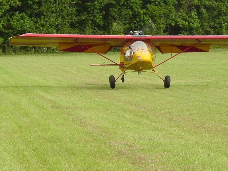

Attached is a picture of John Hauck using his flaps to "jump off the ground" at John B.'s Nauga Field in Louisiana. Notice his left hand on the flap handle.
 Filesize:  265.58 KB
 Viewed:  17046 Time(s)

PostPosted: Tue Aug 07, 2018 4:28 pm    Post subject: Firestar/HKS First Flight Reply with quote
Thanks for posting that photo, George A. Brings back some fond memories of
days gone by.
Yep, I had just snatched the flap handle all the way down and the MKIII was
popping off the grass. She didn't roll far before she was airborne.

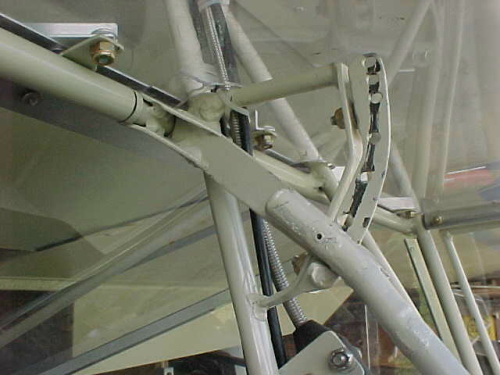

A few thoughts on drooping the flaps/ailerons: when I redid my cabin top, I relocated the flap mechanism down a few inches, and redid the linkage in the process. You can see in the picture that I have 3 holes close together for the area of normal flight. I use the bottom one for takeoff because it droops the ailerons a couple of degrees, barely enough to affect the trim. Doesn't seem to make much difference one way or another. The middle one (of the top 3) is for normal cruise. In this hole the flaps and ailerons are at the same angle. The top one is for normal cruise when carrying a passenger. Since all of the pilot/passenger weight in a MKIII is ahead of the CG, reflexing the flaps a couple of degrees means you don't need to use as much elevator trim when carrying a passenger.
As John said, drooping or reflexing the ailerons is done in minute amounts. A little bit goes a long way, and the same is true for the flaps: moving the flap lever between these three top holes makes very little difference. Moving the flap lever down to the lower ones requires progressively a lot more up elevator trim to compensate.
The link gives a lot more details http://oh2fly.net/oldpoops/pg3.htm
 Filesize:  64.84 KB
Rex Rodebush

It was a great idea and I confess I stole it from Richard a few years ago also. I did it a little differently with a spring loaded pin in a hole to set the flaps. see pictures.
 Filesize:  90.66 KB
 Viewed:  16976 Time(s)
 Filesize:  137.82 KB
