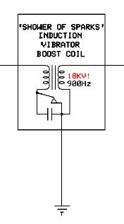

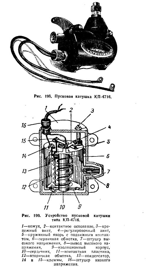

PostPosted: Thu Jun 21, 2018 6:44 am    Post subject: Re: Booster Coil needed please Reply with quote
Chris,
If the points are burned out and the performance deprecated then possibly the internal capacitor (or more likely its connections) across the points has failed; hence the arcing and lack of output.
I've attached a couple of images - a simple schematic of the KP-4716 function and a cross-sectional Russian drawing showing the internal layout, with what looks like a waxed paper/foil capacitor (13). If it is of that construction then it will neither like prolonged exposure to heat or moisture.
Hope this is of some help.
Brgds, Rob R

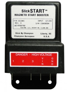

PostPosted: Thu Jun 21, 2018 2:39 pm    Post subject: Booster Coil needed please Reply with quote
This is what I installed on my 50 after the shower of sparks failed. Works great.
Doc
