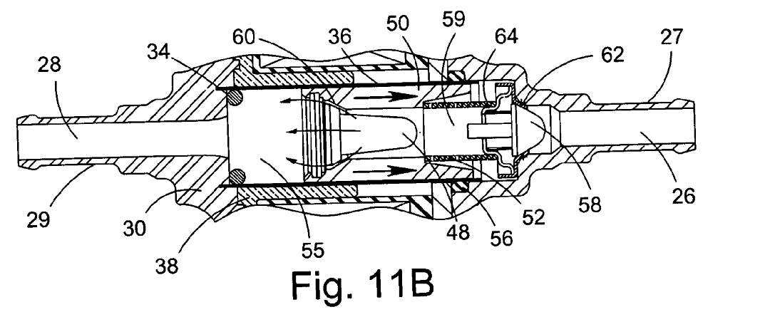

Hmmmm . . . that's a strange one. Those pumps
are strange creatures that don't behave like
what we would expect of a motor driven device.
The 'thumping' noise is a piston being magnetically
driven to compress a spring. The piston is hollow
and has check valves in each end. The 'power stroke'
compresses the spring and reduces pressure on the inlet
side. Fuel is forced past the inlet check valve
filling the piston. At the end of the power pulse,
spring pressure works to return the piston to
its resting position, increasing pressure on
the fuel which closes the inlet valve and opens
the outlet valve. Spring force and piston motion
pushes fuel out of the pump.
[img]cid:.0[/img]
Output pressure is purely a function of spring
force. Output flow is purely a function of how
much flow leaves the pump at the calibrated
pressure.

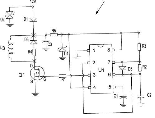

Hmmmm . . . the modern putt-putt pumps do have
solid state exciters for the motor coil . . .
I've been pondering the potential for the
electronics to go into some kind of 'crowbar'
condition during the brownout transient . . .
Here's an exemplar circuit snatched from patent
application 2005/0089418A1:
[img]cid:.0[/img]
Good ol' 555 and a FET . . . hard to see how
this might present the symptom . . .
It this a consistent phenomenon . . . pops
fuse every time?
 Filesize:  55.82 KB

nuckolls.bob(at)aeroelect wrote:
I've been pondering the potential for the electronics to go into some kind of 'crowbar' condition during the brownout transient . . .
Here's an exemplar circuit snatched from patent application 2005/0089418A1:
Link to the patent: https://goo.gl/nLh81H
Reading through the patent description, two possibilities, both admittedly remote, come to mind:
1. TVS diode D2 has seen too much abuse and has failed short. The brief current spike that results when power is applied is sufficient to blow the fuse but not to blow D2 clear.
2. MOSFET Q1 has failed short. The patent application says this about the solenoid coil: “In a preferred embodiment, [the] coil is made of 21 gauge magnet wire and is a 2mH inductor with a resistance of 1.4 ohms.” With Q1 shorted, this would draw >8A at 12V, easily blowing a 5A fuse.
The first failure would probably present as a dead short to a continuity meter across the pump’s supply wires. The second might not register as a short, but would measure as a very low resistance. Either way, putting a meter across the pump would prove or debunk my theory.
Eric

For the benefit of those following via email echo, in my previous post, I meant TVS diode D2, not D4. I've edited my original post on the forum to correct this error.
Eric
1. TVS diode D4 has seen too much abuse and has failed short. The brief current spike that results when power is applied is sufficient to blow the fuse but not to blow D4 clear.
If a junction device goes catastrophic it generally
dead shorts or blows open (usually scattering bits
of plastic around). If this diode was shorted,
it would pop the fuse immediately on application
of battery power.
I like this one . . . but again, the differential
is that the fuse would blow immediately upon
application of battery power . . . and not
wait for the starter to engage.
If a junction device goes catastrophic it generally dead shorts or blows open (usually scattering bits of plastic around). If this diode was shorted, it would pop the fuse immediately on application of battery power.
I like this one . . . but again, the differential is that the fuse would blow immediately upon application of battery power . . . and not wait for the starter to engage.
Aaah, yes, of course. I think I got led astray when Joe wrote that the fuse blew upon engine cranking. The fuel pump would obviously already be running by then.
Unless these aircraft somehow have an unintentional path by which the starter or its contactor circuit can draw current through the pump fuse, I’m out of ideas.
Eric

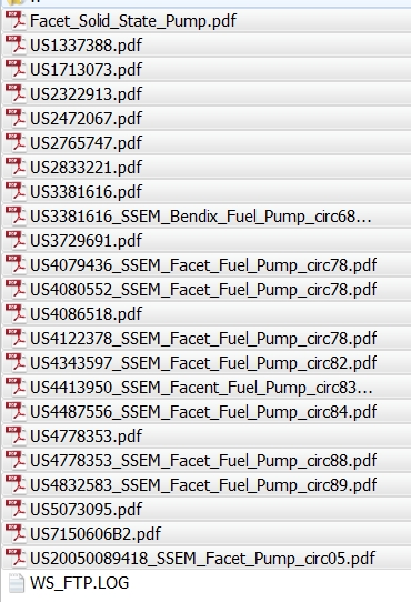

I do have Fact pumps: Both the very old 20+ year old and newer 8 year old styles. I can hook then up to a heavy duty power supply and play with the voltage and see what results we get. Won't be able to do it till next week though.
No Facet pump is driven by the classic
DC motor with a rotating shaft. The Facet
pumps have roots in Bendix designs that
date back to 1920 or earlier. These
are solenoid driven pistons, springs
and check valves that produce one
'squirt' of fuel for each 'thump'
of the solenoid motor. Here's a
partial listing of patents describing
the history of these pumps.
[img]cid:.0[/img]

Good data . . . and I think some pieces are
falling into place.
The 555 astable multivibrator driving the pump's
fet is set up to turn the fet on hard and apply
full 12v to a coil with about 1 ohm resistance.
Under normal ops, this produces a power pulse to
the 'spring winder' on the order of 12A but
only for a few tens of milliseconds out
of every cycle such that AVERAGE current
flowing is low . . . 1 to 2A.
I'm thinking the 555 multi-vibrator becomes
uncertain during a brown out event . . . and
produces a longer power pulse. Recall that
unlike breakers, fuses can be 'hammered' with
repeated over-loads.
Running a pump on the bench with a variable
supply would confirm out-of-spec operation
for the pump's electronics during the brown-out
event.
It would be easy to design a pulse generator
that would stay in spec down to much lower
voltages . . . but this is probably not
a situation that would get Faucet's attention.
