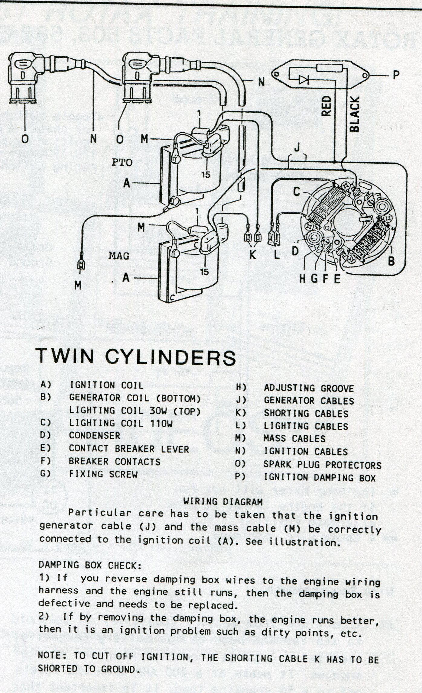

OK, the company is gone and I can play on the 'puter. You can see in the wiring diagram that the generator coil goes to both sets of points via the coils (and the dampening box) via J & K. (These diagrams are from OLD catalogs. I never throw that stuff away)

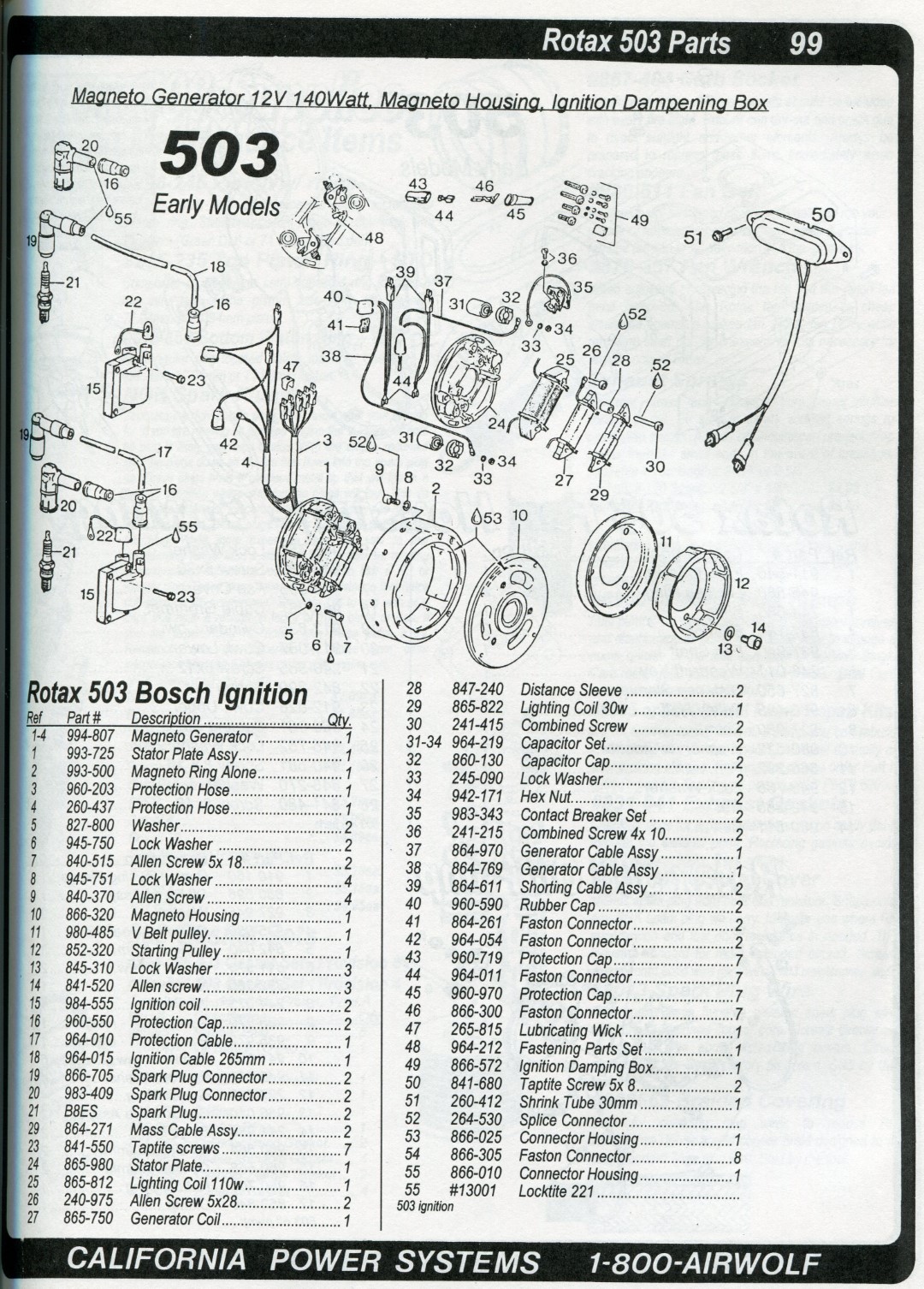

Next diagram; on the Bosch 503 magneto, #27 is the generator coil that goes to the points. #29 is the 30W lighting coil, which is what you will hook the Atom to, which will drive your experimental back up ignition, and the wires for that ought to be green, and green/black.
I am assuming that maybe this is one of those deals where you get a spark every time each piston is close to TDC and BDC, with the BDC spark just a wasted spark. But I have never tried this with a Rotax twin; only with a 277 single. None of this may even work at all. You are exploring new territory.
