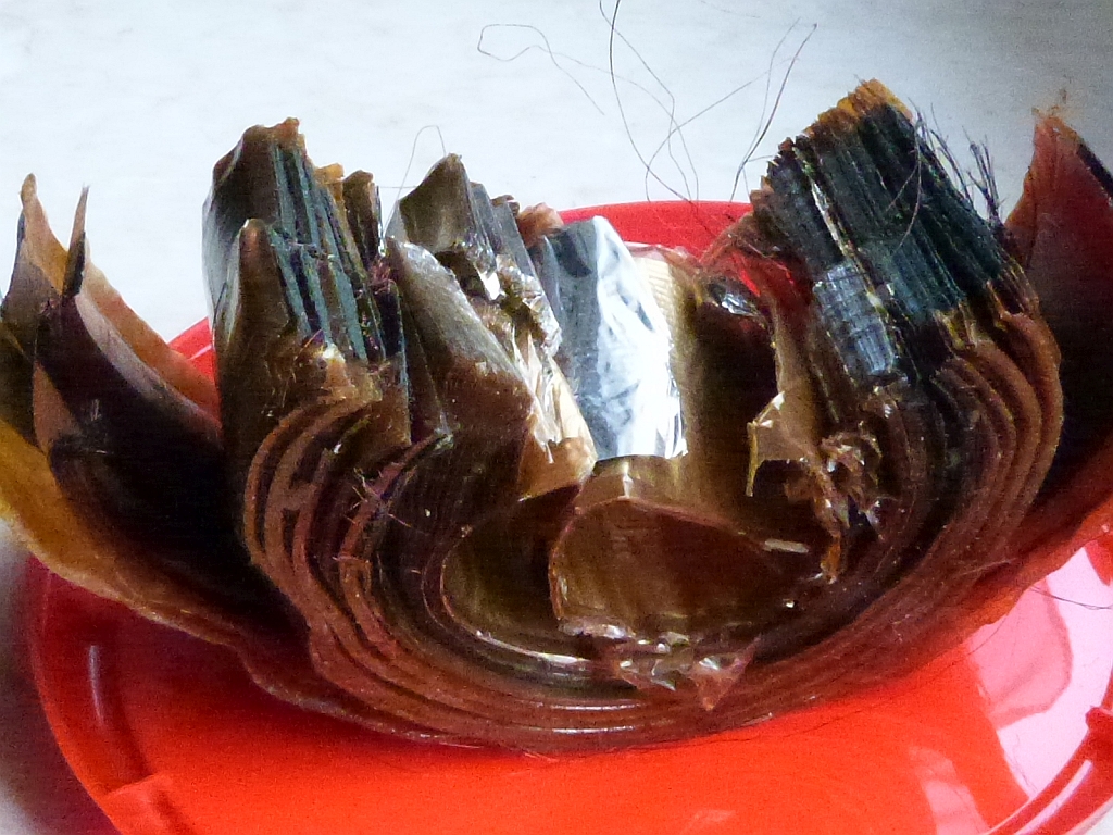

Ernest – with your huge experience in these matters, possibly you could explain why you think I'm wrong!

I'm sorry, but that is not correct! But over the last 25 years, I have experienced coil problems on at least as many aircraft. Logic will tell you that a coil failure in one magneto will leave the engine running perfectly well on the other magneto with a slight power loss. The practicality is different, and the engine will stop totally if the coil failure is serious. Of course it will then restart, but enough to give the pilot, and indeed any passengers, a fright.
Our own view is that, as has been said, the magneto gets very hot in operation. And of course the coil is inside, and worse still, the capacitor is inside the coil, which is intrinsically getting hot with the current going through the coil. In order to partially overcome this problem, we have developed coils with an external capacitor which will run rather cooler, and have had very satisfactory results with them. The capacitor is small; bonded to the outside of the coil and makes no difference to installation of the coil inside the magneto.

A coil failure in a magneto will feel the same as simply grounding the mag, or turning the mag "off." In other words, a coil failure with both mags "on" or "not grounded," will feel like nothing, other than, say, a five percent loss of performance. It won't cause a total engine failure. However, it is entirely possible for both magnetos to have intermittently failing coils. One is tired, and the other quits when it gets hot, so the engine stumbles, terrifying the pilot and passenger. The brief engine stumble rattles the coil enough for it to correct it's internal short, and the engine smooths out. Or, one has a spark plug wire problem on one mag, and a failing coil on the other. The engine runs fine, until it gets good and hot and the coil associated with the good spark plug wires fails. Terrifying!
Magnetos get very hot in use. Has anyone fashioned dedicated cooling blast tubes to the magnetos? What does the Sukhoi use, if anything?
We did the auto plug conversion, and immediately were rewarded with a better running engine. The auto plug conversion will reduce the weight of your airplane by a couple of pounds, which is also of benefit. The cost of the kit is nominal.

I have a really hard time accepting that a coil failure in one mag. can cause the other mag to fail.
Have had only one definite coil failure. Occurred during pre-flight power & mag. check on a 1340 with American Bosch mags. Went dead as a doornail on that one but other just fine. New coil installed and back to normal.
Have had two instances of the Huosai wake up call (2 sec. of silence). Two different aircraft & engines, x-country at around 7500 ft. throttle fully open trying to maintain about 65% power, mixture up to throttle (max. lean). Maybe too lean!
Since then with a large throttle opening at altitude I don't go quite as lean and have not (so far) had a recurrence.
Don't know for sure but???????

I don't think you're wrong. I agree with you. I didn't see your post. I was responding to the original post.

I believe that the coil failure actually fires the spark plug prematurely burning the fuel charge while it’s in the intake position that causes a small burn back through the intake system consuming the fuel charge and that’s why the engine quits because it has no fuel for a second or two. George Coy

What exactly happens when a magneto coil fails? How would a mag fire a
spark plug prematurely, of the mag fires when the points open?
Can anyone explain this?
On Tue, Feb 20, 2018 at 10:18 AM, George Coy <george.coy(at)gmail.com> wrote:
[quote] I believe that the coil failure actually fires the spark plug prematurely

We had the stumble , followed Richards advice, all sorted. Other opinions will extend the solving of your problem until you adopt Richards solution.

Ok, so to add to the story.....
On Sunday I pulled the two magneto coils out of my machine.
I did a simple continuity test on the bench with a multimeter across the primary and then the secondary windings of both coils thinking I could at least compare the readings. The coil from the right magneto tested open circuit intermittently on the secondary winding. To be honest I had planned to put them in the oven at home to cook while the War Office was at work so I wasn't expecting to find a fault so easily.
I am going to replace the faulty coil tomorrow and see how he goes from there.
There are many on here with brains bigger than mine so can I put a theory up for comment?
If the coil on my RH mag failed, like it has in the secondary (high tension) winding, could that send a burst of HT energy down the P lead, and jump the terminals of one of the 3 switches in that circuit, back down the LH mag P lead to the primary winding of the LH magneto coil, disrupting the magnetic flux of the 'good' mag?
Thoughts??

Yep, George's theory sounds plausible. If the primary circuit winding went open circuit at the right time then the magnetic flux would collapse and one plug could fire prematurely. That could consume the charge in the intake pipes and the engine would hesitate until it is refreshed, but wouldn't there also be a backfire out the carb?
In our case George's theory doesn't fit what was observed. It is the secondary winding that is intermittently open circuit and there was no backfire. Also, when the engine restarted, there was a big cloud of smoke as the unburnt fuel in the cylinders was consumed.
Please don't misunderstand me here, I am not claiming to be right about my theory either but here is my reasoning...
At the time of our event he was 800' up, 700mm manifold pressure and 70%RPM, dirty side down in a stable cruise enjoying the scenery.
The pilot reported the engine quit, "Just like someone had turned the mags off." When he returned to the airfield I had him do an extensive ground run where of course the engine performed flawlessly.
My first reaction was that it was a fuel issue, but I went through the fuel system with a fine tooth comb and I found nothing amiss. Sunday here was a 29C (84F) clear day and no other normal signs so carb ice can be ruled out.
In the Yak-52, if you ignore the cylinders themselves, there are only four components in common with both magnetos.
1. The ignition harness,
2 & 3. The mag switch in each cockpit,
4. The 'Start Selector' switch in the rear cockpit.
Cross firing in a harness usually causes rough running, not a dead cut so I discounted that as a possibility. Whatever goes wrong in one magneto somehow effects what happens in the other one, hence my thoughts about the cross arcing across a switch.
I have been working on round engines for many years now but I definitely don't claim to be an expert. I have a good engineers understanding of how they work and how to fix them, although most of my experience is on P&W engines. I suspect the solution to finding the cause here is to find the man with a good designers knowledge of how these Russian lumps tick.
It would be nice to pin this down to a demonstrable, repeatable defect and come up with a permanent fix....

wlannon(at)shaw.ca
PostPosted: Mon Feb 26, 2018 10:07 pm    Post subject: Engine stumble in flight Reply with quote
Looigi, et al;
George, Jan, Mark, Richard and Vic I believe are all on the right track. I
think all believe the capacitor (condenser) is the source of the problem and
after a considerable time "back to the books" I most certainly agree.
Like you all my time spent working on and flying radials has been on P&W
engines almost invariably with Bendix mags. Over 60 years (85 four days
ago) and never heard of such a problem!
I knew the capacitor was there to inhibit arcing of the points but really
had no idea how it worked (electrical is not my long suite). In the Bendix
mags. the primary
capacitor is wired in parallel with the points. Capacitors (so I read) can
be subject to leakage depending on charge level, capacitor type, size, high
temperatures. age, etc.
As Vic or Richard pointed out being buried between the coil windings seems
like the worst possible place to install it. I can't picture how it can be
wired in parallel
in such a location.
The scenario I think goes like this: The cap. is fully charged and for some
reason leaks across the plates. That charge by-passes the points and
energizes the primary/secondary circuit firing spark plugs totally out of
sync. Apparently the cap. can release that full charge in a millisecond
and then go back to normal.
For what it's worth;
Walt
j.mevis(at)computer.org
PostPosted: Mon Feb 26, 2018 11:30 pm    Post subject: Engine stumble in flight Reply with quote
Hello Walt,
The capacitor does more than avoiding sparks on the points.
It also must help the primary circuit to swing up the energy:
Dielectric energy in the capacitor is transfered into magnetic energy in
the coil and vice versa.
Comparable to what happens into an oscillator circuit.
So indeed, the good working of the capacitor is a must for a flawless coil
functioning.
Nobody knows why the Russians implemented an internal capacitor but they
must have had their reasons for that.
This internal capacitor is not much more than two tiny sheets of metal
wrapped up with insulation material in between.
The frustrating thing about this problem is that we¹ll never know exactly
what happens until someone knowledgeable finds the time/money to have a
thorough look at it in a lab.
Thanks for your input,
Jan
seems
be
wired in parallel
in such a location.
some
Walt

Remember, the alu foil capacitor is wound between primary and secondary windings within the coil - the worst place to put a capacitor. My guess is that the dielectric material and materials in the coil wires may age and since the electrical properties of components will become unsuitable to operate.
I figured the capacitor was wound into the coil but wasn't sure and yes it's not the best place to have it located...Thanks Vic

PostPosted: Tue Mar 06, 2018 3:46 am    Post subject: Re: Engine stumble in flight Reply with quote
In the photo you can see the aluminium foil of the capacitor, the primary windings are not there, just the HT wires around it.
There are a lot of good ideas in this thread, we certainly know effects from HT harness and sparkplug troubles. But I can tell you, nothing of that all is depending on time and temperature like a failed coil cum capacitor. When we had this stumble first time for real we were thinking along old mogas from last season that may have gone duff. So we had avgas for next flight - and that took us some more flights till we realized that time was that matters. It was about half an hour each time till that stumble showed and could be induced spectacularly on the ground after landing, setting revs to min. 80 percent: You cannot fail to notice for sure !! With a cold engine NOTHING showed when doing the mag test in preflight. So it became crystal clear after realizing the critical time lapse for the effect that the real problem was the coil. I could demonstrate that anytime in my oven by watching the spark length with the hot coil ! A cold bad coil produces exactly the same spark like a good one.
Just why the engine misses for a complete second on all cylinders in flight is not totally logic to me. Burning into the inlet system with an open valve is hard to imagine. You usually get no ignition without compression in a gasoline engine. While that effect is not yet well explained I continue to be worried about a situation when the engine may not pick up again after that stumble !
Vic
