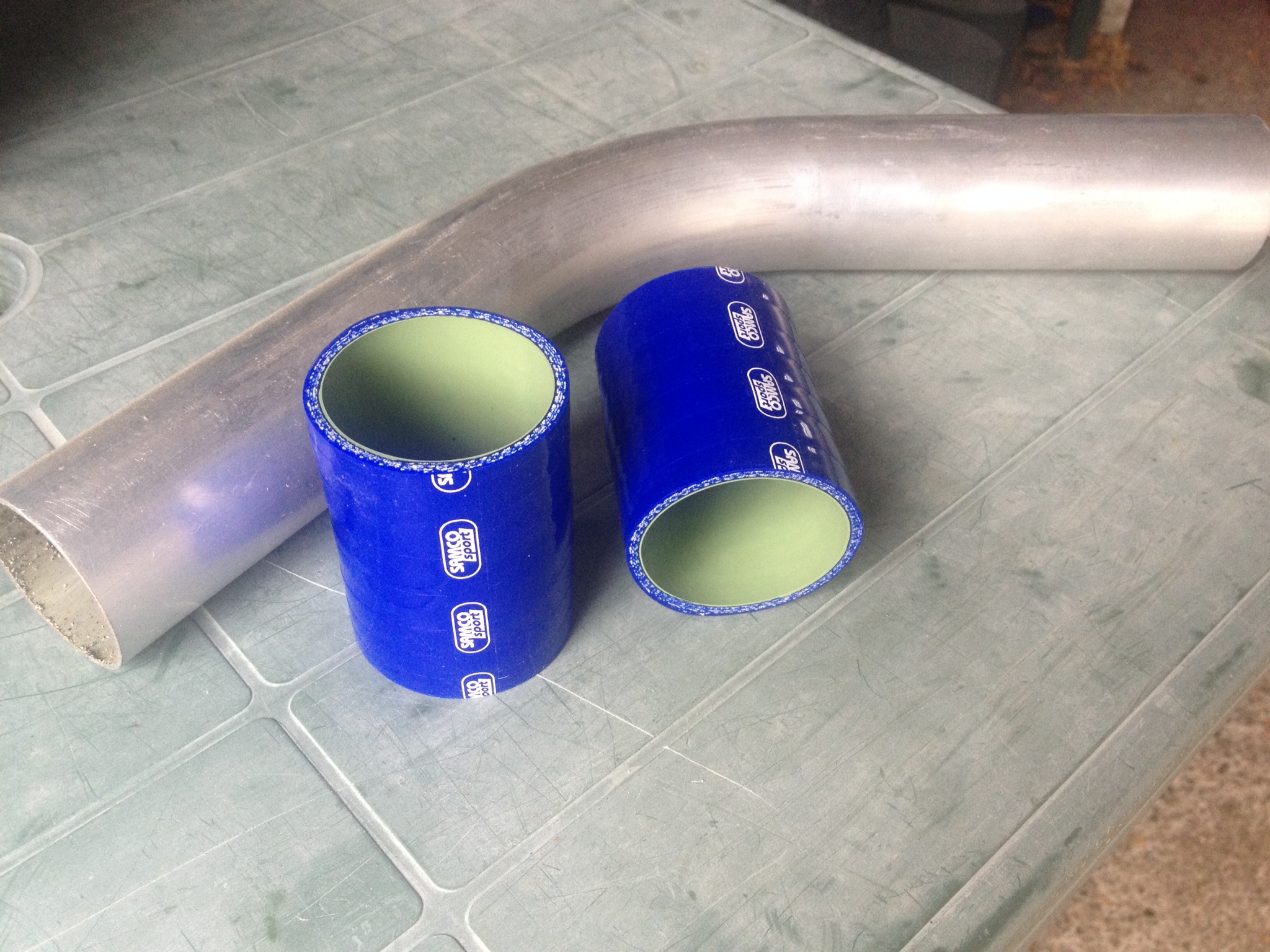

To: Builders/Owners interested in the Aluminium Fuel Elbow.
Hi All
Brian Davies has kindly applied to the UKLAA for Modifications approval regarding the fuel filler elbow from the cobra to the tank. These should be signed off shortly.
He has presented two options, one being the 53 degree aluminium pipe I supply and the other the AutoSilicon 60 degree hose.
There is a considerable price difference regarding the two systems.
Before ordering the aluminium pipes I need a firm commitment from you as I don’t want to end up with unsold pipes. If you decide not to go with the aluminium pipe then I entirely understand.
The cost of the aluminium pipe would be £25 each plus postage within UK as I can transport them there myself, although the cost is not a lot less from sending them direct from NZ.
This is double the cost of the AutoSilicon 60 degree pipe which is £12.42 each plus postage.
http://www.autosiliconehoses.com/
Four fuel Clips and hose couplings are an added cost for the builder/owner in both options.
http://www.merlinmotorsport.co.uk/
Please email me if you still would like the Aluminium Tube.

This is a 60 deg aluminium elbow as listed on ASH;
http://www.autosiliconehoses.com/silicone-hose-shop/alloy-stainless-steel-pipes/60-alloy-elbows.html
And this one is a 60 deg silicone elbow also on ASH.
http://www.autosiliconehoses.com/silicone-hose-shop/performance-silicone-hoses/60-silicone-elbows.html
I’ve no idea if either or both are suitable for fuel or not, I just saw them on their website. Doesn’t affect me anyway as I have one of Tim’s elbows (which are very good!)

Actually re. the ASH silicone hose above I don’t think is made of the right stuff to be fuel resistant.
This one from Merlin probably is (same material as the coupling hose that Brian is putting in the mod) - but just by looking I’m not sure if the elbows would be long enough? Doh!
https://www.merlinmotorsport.co.uk/p/samco-profuel-60-degree-silicone-hose-elbow-pe60

I think the 60 degree elbow you mention may be OK but it still needs to be connected at both ends using some form of fuel proof connector. However this elbow is NOT the subject of the standard mod being proposed and approved by the LAA at present.
That Standard Mod from Brian Davies which WILL be approved, uses either an aluminium (aluminum) elbow supplied by Tim Ward in NZ or a 60 degree aluminium elbow available from http://www.autosiliconehoses.com/ In both cases the elbow is connected to tank and Cobra using ProFuel (fuel proof) hoses and clips.

Thanks Pete, I’m fine with it - I’ve already got one of Tim’s aluminium elbows which I bought from him a few years ago and never got around to fitting! I’ve ordered a pair of the silicone hose couplers exactly as specified by Brian in the standard mod which are on back order.
Incidentally my black factory hose, on inspection was in perfect order - but as the topic is current I may as well take a few minutes to bring it up to the best specification.....!

Hi Pete,I found the 60 degree elbow from the “Silicon Hoses� list (AutoSilicon Website) down the left hand side of the silicon hose products. Custom built products? Hard to find, I know!
Brian Davies recommended these as an alternative to my aluminium pipe and is trying to get UKLAA approval from Andy, along with the aluminium pipe. Not sure if the material is suitable as I read they are coolant hoses. However I will leave that to the experts to decide, as there are different combinations of materials they can make them from to resist fuel. See links. Price may differ though.
After my email to builder/owners, expressing an interest in the aluminium pipe alternative, and stating the alternative AutoSilicon product, all have gone for the aluminium pipe.
I have 35 on order to post soon. The 53 degrees makes an excellent join for the rubber couplings to the tank and cobra. The 60 degree AutoSilicon pipe may be hard to completely seal adequately, not sure?
I have not had a problem with the aluminium pipe alternative.

FWIW I ordered the 60° Samco Profuel Silicone hose https://www.merlinmotorsport.co.uk/p/samco-profuel-60-degree-silicone-hose-elbow-pe60
Normally the legs from the bend measure 102 mm, but I got them to manufacture one with 152 mm legs for 67,96 GBP + VAT for me.
This way I'd only have two connections rather than four. However I understand, that the LAA only approves the Mod with the aluminium pipe.

The LAA have issued LAA Standard Mod 14809 to permit the use of an aluminium elbow with a bend angle of between 45 degrees and 60 degrees to suit individual aircraft as there is build variation that can affect this angle. As Profuel fuel proof hose is not immediately available the mod also permits the continued use of lengths of the original factory supplied hose, subject to an annual inspection. This mod should permit the return to service of any Europa with a failed original rubber hose and also enable those of us that have had aluminium elbows fitted for a number of years to record the standard mod in their inspection logs.
If you want to fit a Profuel silicone elbow when they become available you will have to apply for an individual mod for your aircraft. Probably the quickest way to do this would be for one person to apply for a prototype mod and then others can use the Repeat Mod system. This works when you are prepared to install an identical mod. I am sorry it was not possible to include this option in the standard mod as we don’t have an LAA aircraft with one fitted to form the basis of the standard mod.

PostPosted: Fri Feb 09, 2018 4:32 am    Post subject: Re: Aluminium Elbow Reply with quote
Samco silicone connectors arrived. Time to get the tool box out!
Thanks again Brian.
