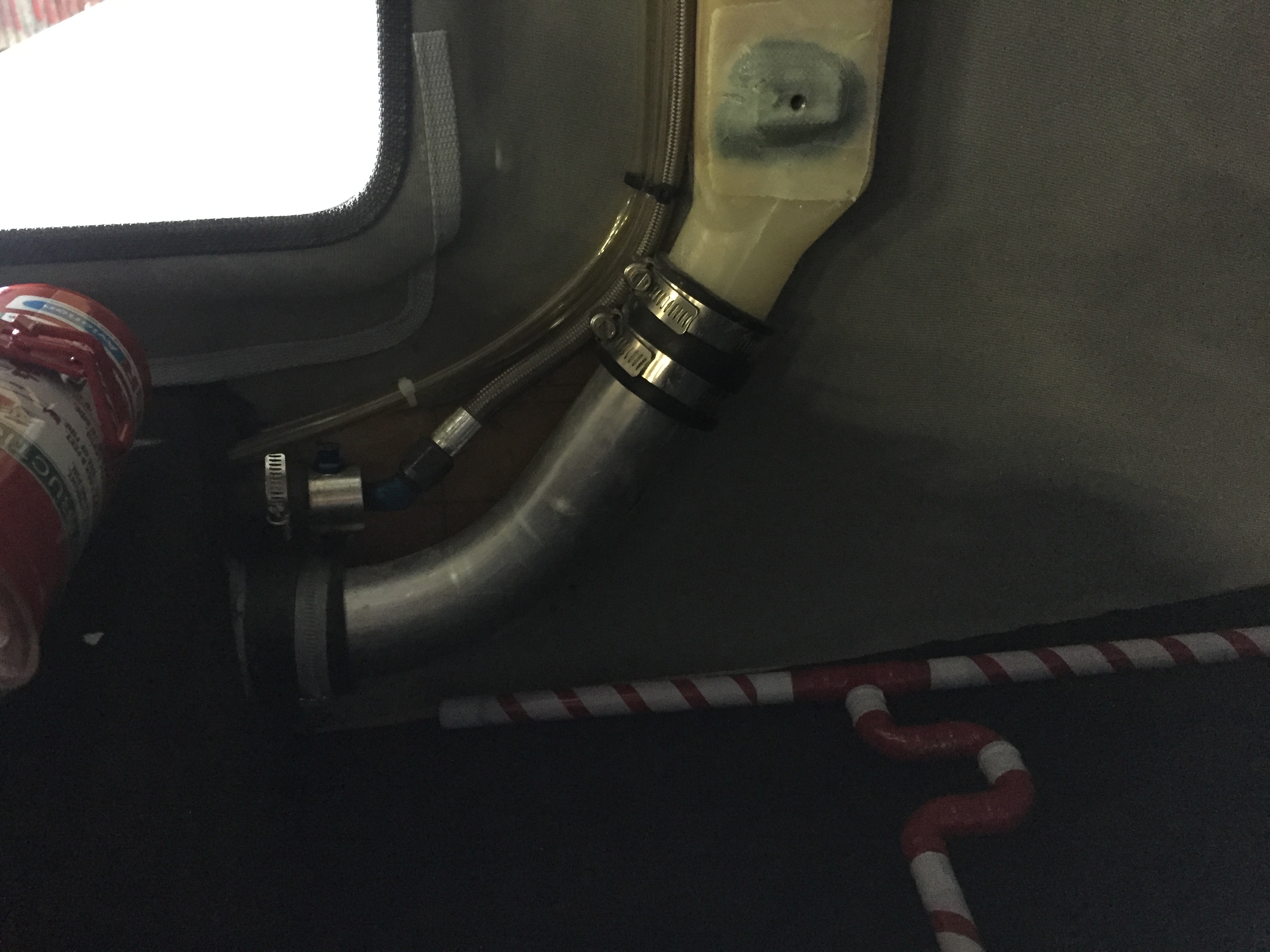

PostPosted: Sun Dec 31, 2017 2:15 am    Post subject: LAA Airworthiness Alert. AIL December 2017 All Europas Reply with quote
That’s identical to mine fitted three years ago.
Dave G-LDVO

On 31 Dec 2017, at 09:19, carlp101 <cparkinson(at)cisc-uk.com> wrote:
Here's the aluminium elbow fitted to my plane. I just had to replace the joining tubes with fluro lined versions.
Carl
