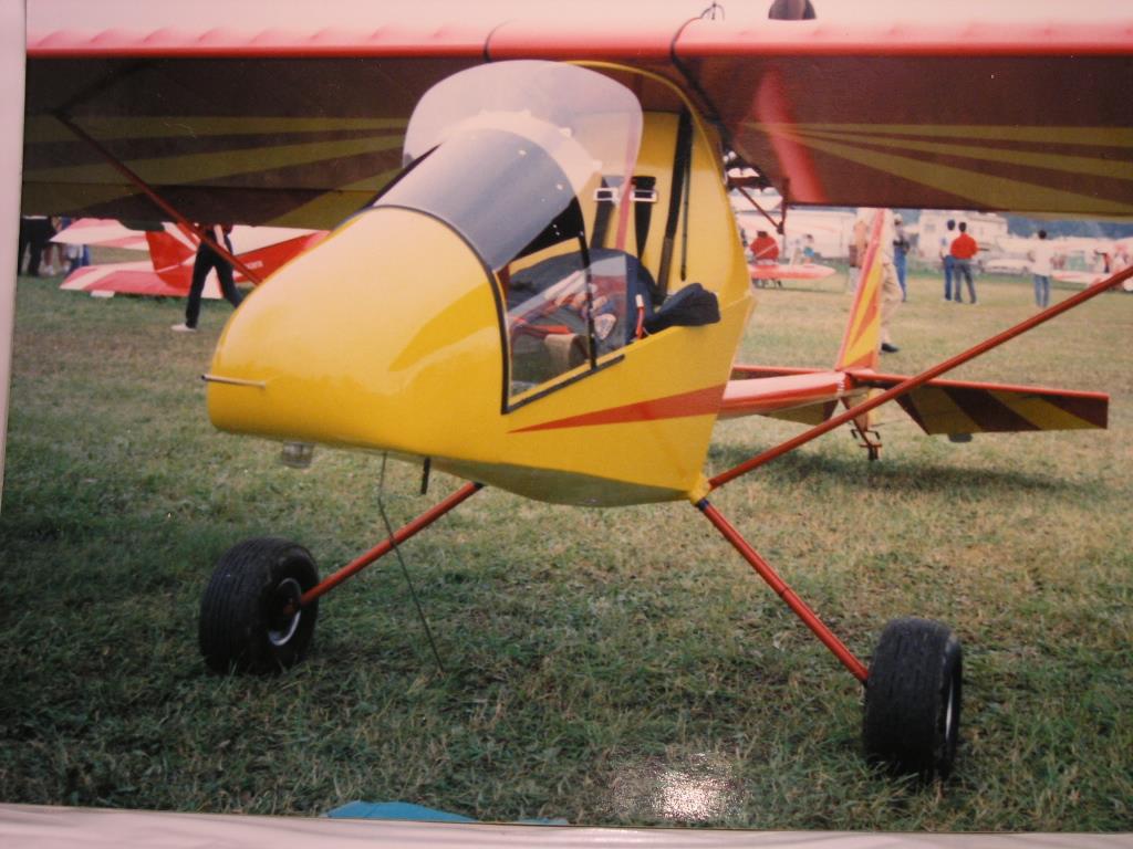

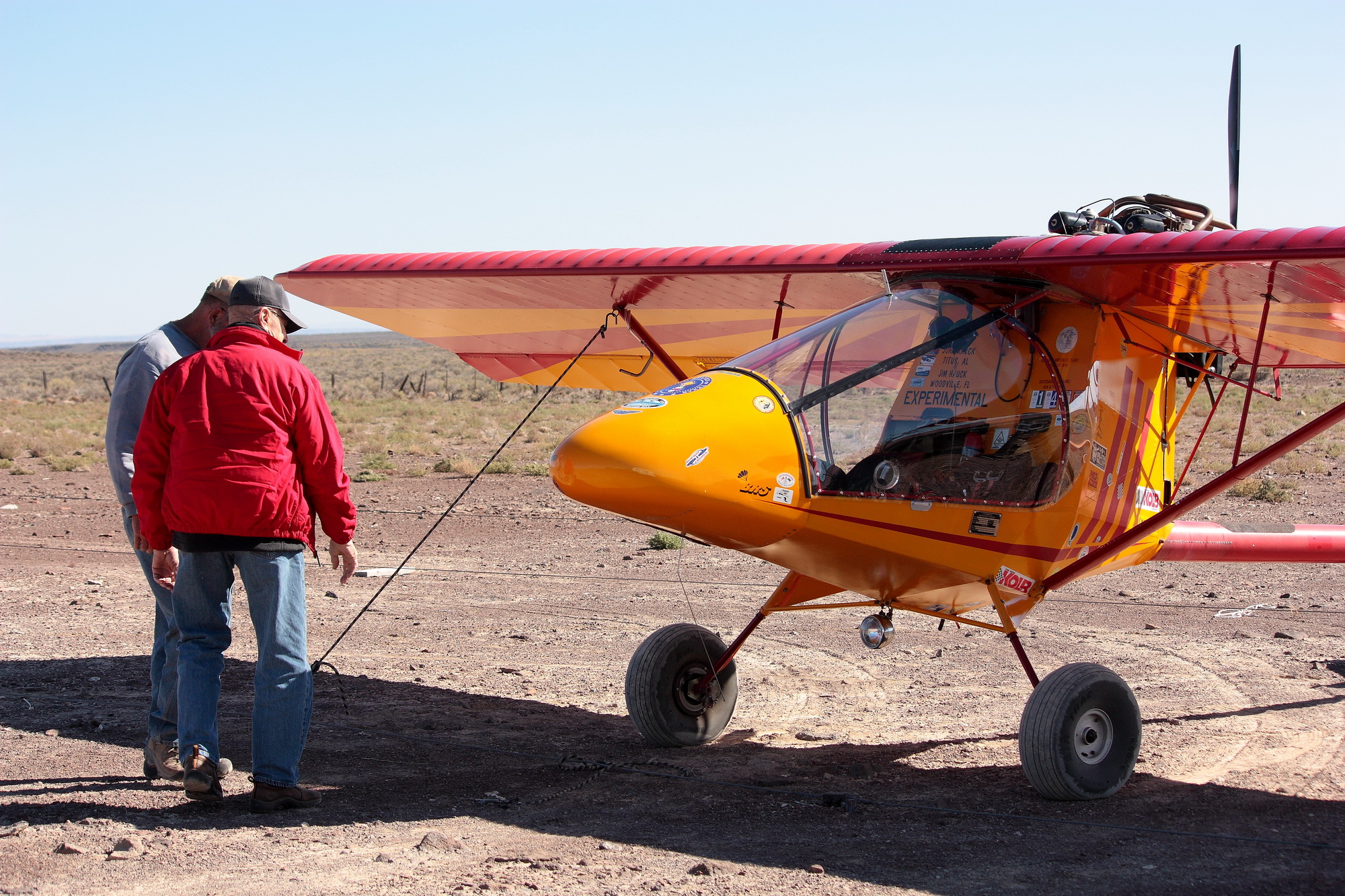

Looking at Richard's pics of gear legs; has anyone ever made a set of
steel legs that don't have any taper? In the RV-x world, the Harmon
Rockets use titanium legs with no taper, but supposedly, titanium's
flexing characteristics are different enough from steel that they can
get away with no taper. Making an axle adapter to fit the fatter leg
cross section wouldn't be that big a deal, but I'm not sure about
transferring extra impulse load directly into the gear sockets if using
non-tapered gear.

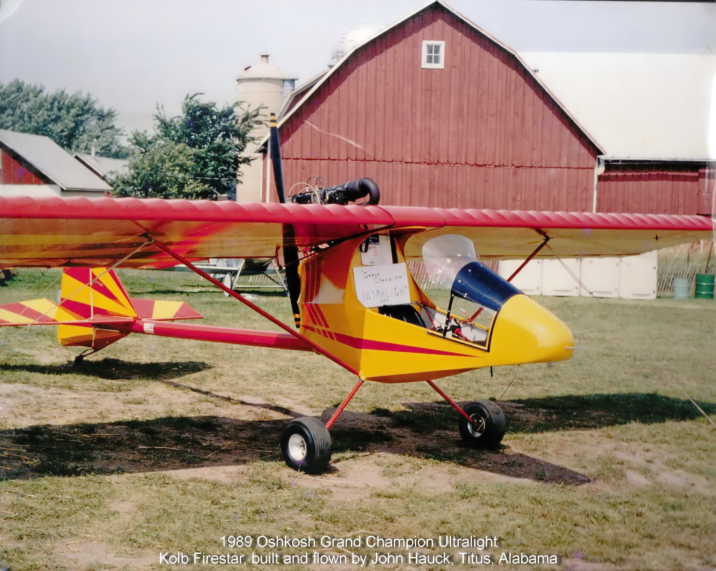

PostPosted: Sun Oct 29, 2017 12:34 pm    Post subject: First Flights Completed! (gear leg question) Reply with quote
Yes, sir. We have been flying Kolbs off heat treated 4130 steel legs for
more than 30 years.

PostPosted: Sun Oct 29, 2017 2:03 pm    Post subject: First Flights Completed! (gear leg question) Reply with quote
I think so. The reason we "lost" 7075 alum legs 30 years ago.

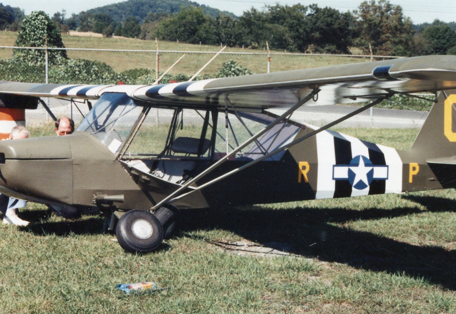

PostPosted: Sun Oct 29, 2017 2:36 pm    Post subject: First Flights Completed! (gear leg question) Reply with quote
Thanks, John, for both the info & the pics. Getting the nose (& wing
angle of attack) up is the primary reason I was asking. Much easier to
fab a set of legs without taper. I even looked at just making them
longer, but to get any height benefit, they'd need to be quite a bit
longer on the old Mk I; the angle is fairly shallow compared to the pics
you posted.

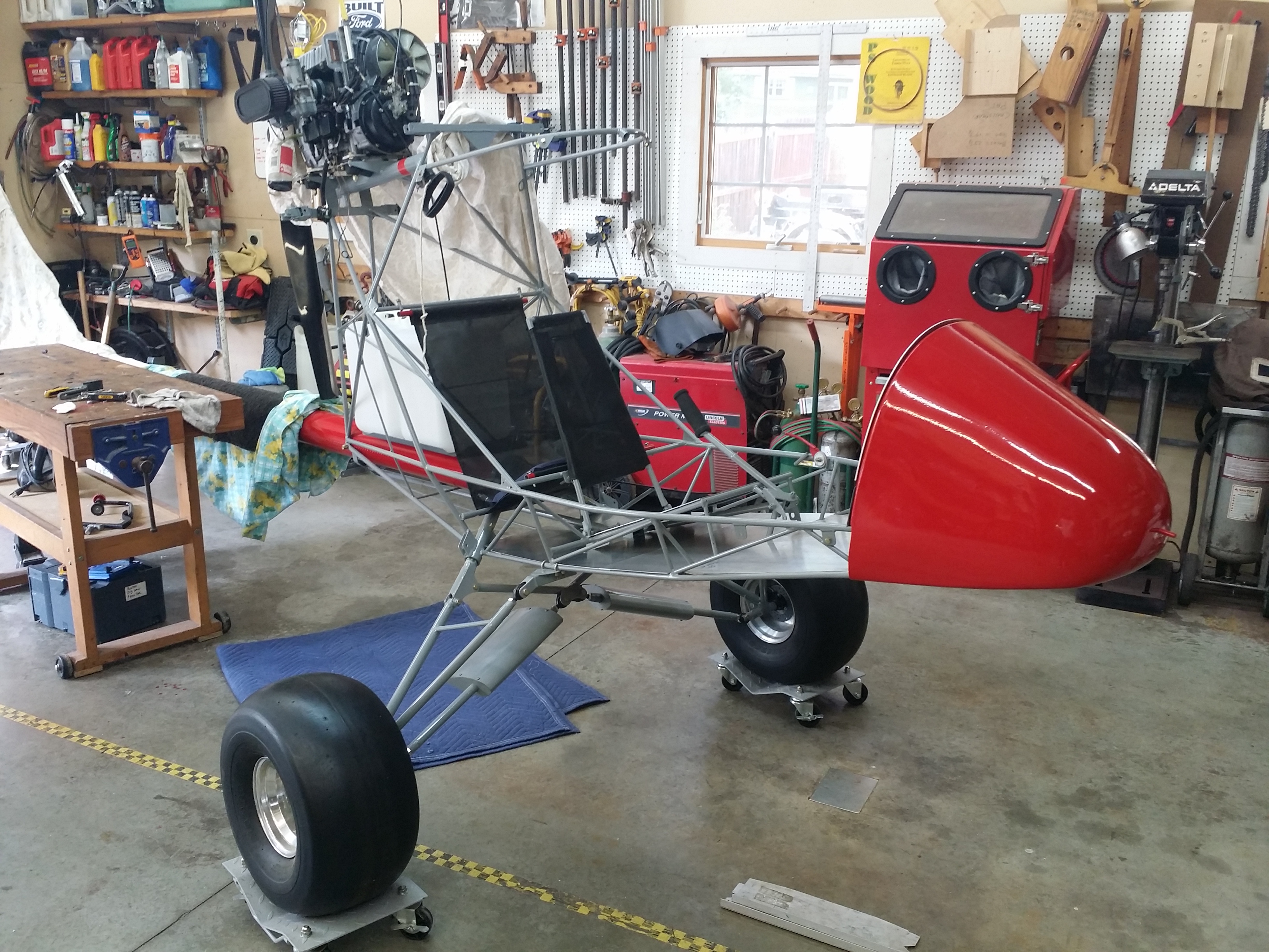

PostPosted: Mon Oct 30, 2017 8:15 am    Post subject: Re: First Flights Completed! (gear leg question) Reply with quote
A buddy of mine is trying this setup for off airport operation. Too much fabrication for me, but I like it. ...Bob

PostPosted: Mon Oct 30, 2017 9:35 am    Post subject: First Flights Completed! (gear leg question) Reply with quote
" A buddy of mine is trying this setup for off airport operation. Too much fabrication for me, but I like it. ...Bob"
Fabrication???? There's a month's worth of ENGINEERING that has to be done on that setup long before the first piece of metal is cut Smile !
I am 1000% in favor of innovation and tinkering, but in cases like this where primary structure is involved the innovation has to be balanced with engineering done by someone with training. The exotic setup in that photo MAY BE really well done, and properly engineered. I have no idea if it is or not, and I am not quaified to say if it is engineered well. But I can say that there either has been, or has to be, a fair amount of analysis made on how those landing loads are put into the fuselage structure, and whether the FORWARD fuselage attachment can take those loads without bending the lower longerons or cross members. The REAR mounting ties in with the standard Kolb socket tube, so it is LIKELY OK.
I hope it works, and I hope that the Super Cub tyle bungee arrangement delivers the result that is being pursued.
Reminds me, I owe the Kolb List a photo of two of my landing gear setup. I used the extra long steel legs from a Kolb Slingshot, and mounted a set of Desser 21 inch LSA bush tires. John H was right, I'll need a ladder to get in the darn thing ! I will actually have to make up some sort of step, or stirrup somewhere to get in it.
But it will give me a very high ground angle for the shortest possibe takeoff.

PostPosted: Fri Dec 08, 2017 11:52 am    Post subject: Re: First Flights Completed! (gear leg question) Reply with quote
I do not like it. The spreader bar attaches to the New Extension well below the longeron and the original gear leg socket. Picture the side loads if you ever get that thing crossed up, or even worse, in a ground loop.
For example, you touch down while fighting a strong right crosswind, and maybe the nose swings right and the tail goes left. You begin a ground loop to the right. With the normal gear, not a big deal. With this arrangement, the gear loads are transferred to the spreader bar, with the associated loads trying to pull the left New Extension under the belly, and push the right side New Extension up toward the underside of the wing.
I say this because this is very similar to how Jessie Anglin (mis) designed the spreader bar attachment brackets on the Anglin J-6 Karatoo - which kit I built - and which damaged the gear twice on a couple of landings where I got it sideways a bit, and then one day I was doing a touch and go and the left brake locked up. (My bad. The return valve in the master cylinder was not set properly) The airplane did a high speed ground loop to the left, the right main gear ended up under the left gear, the left main gear was up against the left wing strut. Check the pictures... Not a smiley face day.
Got an engineer friend to look at the plans and how it was originally built, and his response was "Well, no damm wonder..." He redesigned it to get everything aligned, I spent the winter rebuilding it, and the next time it ground looped, it was a non-event. (aside from the laughs of the watchers)
The attachment points for the spreader bar need to be in alignment with the lower longeron so that they cannot exert any twisting moment to anything. The loads need to be transmitted directly.
Looking at the picture, the attach points for the spreader bar need to be in line between the clevis pin hole for the lift strut and the opposite axle shock strut point attach to make it non-twisty, which means brackets welded to the lower cross bar of the landing gear A-Frame about an inch or so inside the longeron and tied into the main landing gear tube.
And for Dan; the reason those gear legs are supposed to go all the way up to the top as far as possible - if you drop it in hard enough, the gear legs will kink the tube they are inserted in. The early Firestars had legs that only went a bit beyond the retaining bolt hole; after enough guys kinked that socket tube, Kolb started making the gear legs longer. So if you have slid the gear legs down about 4 inches, you can take a magic marker and put a mark on the side of the tube where the gear leg tops out. When the day comes that you drop it in, that is where the kink will be.
Sorry to be the list wet blanket, but that's how I see it.
