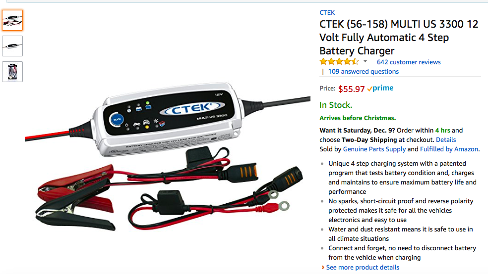

PostPosted: Thu Dec 07, 2017 9:47 am    Post subject: Battery charger/minder/tender Reply with quote
I have been using this charger on all my vehicles and Odessey Batt. Works fantastic.
https://www.amazon.com/gp/product/B000FQBWCY/ref=oh_aui_search_detailpage?ie=UTF8&psc=1
Do not archive.[img]cid:AE7045B5-F16F-429A-9A63-F6C6B1880499[/img]

PostPosted: Thu Dec 07, 2017 10:02 am    Post subject: Battery charger/minder/tender Reply with quote
Funny you should list that one Rob.
I bought 2 of those for at home. Used one to recharge my
Odyssey in the RV-14 while I was building it and testing the
panel. It is a really nice charger. I liked it so much that
I bought another to keep on my truck all winter as I've
had the battery drain on me 4 times now.
These are pretty nice chargers and if you're on a budget,
I'd say they would work good for your odyssey also.
Tim

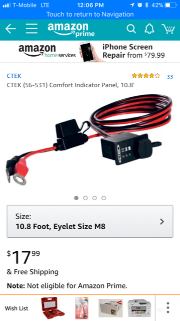

PostPosted: Wed Dec 20, 2017 11:08 am    Post subject: Battery charger/minder/tender Reply with quote
You might add this to your order for an easy plugin on installed on the baggage compartment.
[img]cid:697077F6-7308-4237-BBF8-456C31819EC8[/img]
On Dec 16, 2017, at 2:51 PM, Ed Godfrey <egodfrey(at)ameritech.net (egodfrey(at)ameritech.net)> wrote:
To all of the folks who provided suggestions, thanks. I will be putting the CTEK charger on my Christmas list. Thanks.
Ed Godfrey
