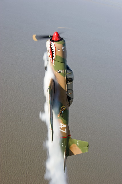

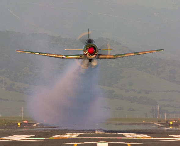

Smoke. Bill Blackwell installed the system on my personal bird a year ago, and it puts out copious amounts of smoke. The important thing is the pressure....make sure to use a pump that will deliver at least 60 psi and adjust the flow valve and restrictors at the injectors to get the optimum burn....nozzle placement doesn't seem to make a lot of difference in Bill's experience.
