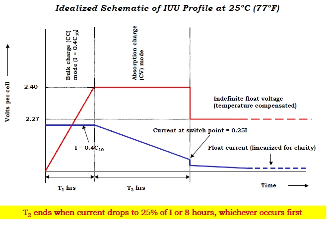

Hawkjer-Enersys manual on Odyssey batteries:
[img]cid:.0[/img]
It sounds like the power management philosophy for
the 'secondary power sources' could use some
refinement. Without detailed schematics describing
just how electrons are being herded through the
system, it's not possible to offer a detailed
assessment.
The take-away from this exercise was predicted
by one of my heros:
"When you can measure what you are speaking about, and
express it in numbers, you know something about it; but
when you cannot measure it, when you cannot express it in
numbers, your knowledge is of a meagre and unsatisfactory
kind; it may be the beginning of knowledge, but you have
scarcely in your thoughts advanced to the stage of science,
whatever the matter may be." -Lord Kelvin- 1864
