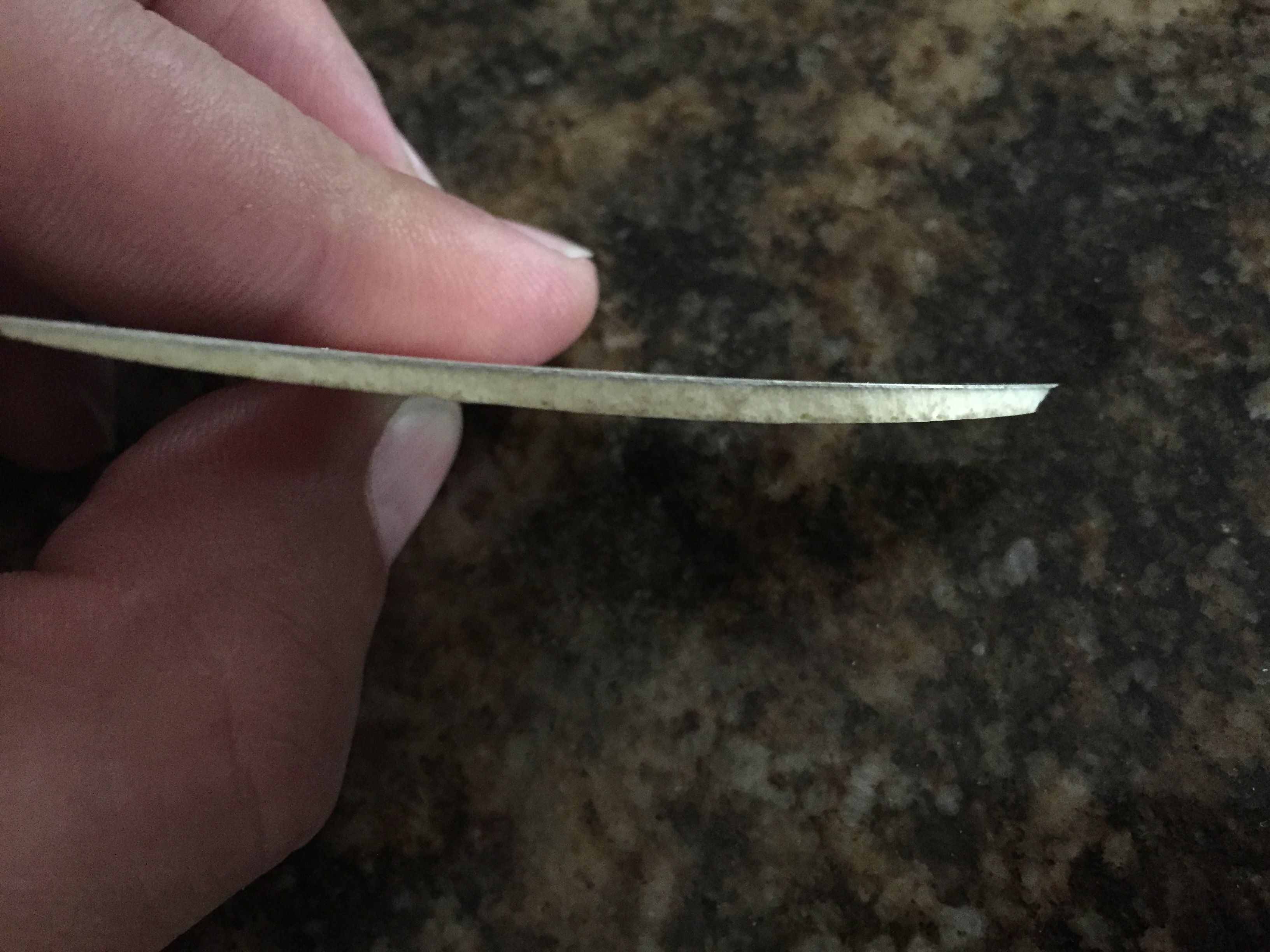

I'm attaching a pic of a snapped off pice of what I think is the filler. I do believe that this is the case in most if not all of the bubbles that are on the wing.
I want to thank everyone that replied so far. You guys gave me allot to think about and yes, depending on what I find once I open all the bubbles, I may decide to take it to a professional.
However, I am still interested in what materials (filler, resin, etc) are suggested for working with as it pertains to the Europa. I would like to learn about this stuff and unfortunately the best way I learn is hands on and by making mistakes. Not on the airplane in this case, but practicing on the "bench".
So if anyone does have experience with a certain resin, filler, etc that he/she would recommend, please let me know the brand/type/manufactures and I'll start my research/learning.

One other thing that Im curious about. Per the attached pic of the pice I snapped off, I concluded that in this case, the bond between the cloth and filler has failed. However, based on what I have read so far, I'm a bit taken back by the thickness of the filler that snapped off. It is way thicker than what is suggested in the manual, as I read it.
Do you guys agree or is that normal?

It is possible that the filler delaminated because it did not adhere properly to the fiberglass. To prevent that, we used a clean dry cloth (old sock) to rub a very small amount of resin on the fiberglass just before spreading the Expancel.
Yes, the photo you attached shows pretty thick filler. For some reason we did not receive the original post with photos of the damaged areas so we don’t know where that came from. Filler used to blend two areas where one is proud of the other can be somewhat thick, so areas where fairings are glued to the wing near the wing root can have more buildup than other areas. Normally it should not be as thick as the piece in your photo.
