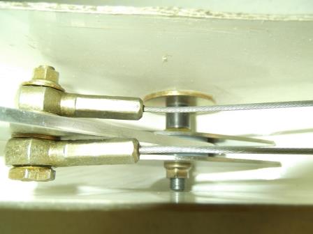

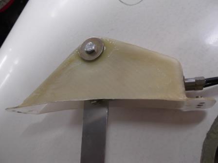

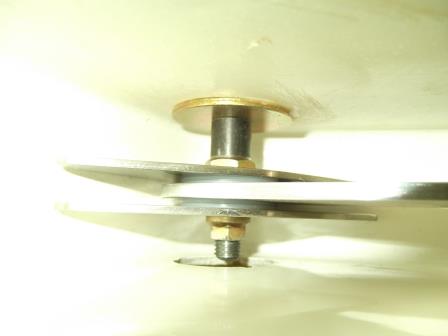

Hi Richard
Attached are pictures of my throttle box.
I found the original design less than satisfactory and made the following changes:
a) Bolt is clamped to box with a large washer either side of the box, a spacer tube and a nut with Loctite to stop rotation.
b) I made two aluminium plates, shaped to fit the box. These stop any rotation and provide a good flat surface for the nylon washers - 2 each side of the lever.
Have not tested in anger yet by it has a really smooth action and the friction is easily adjusted to counter the carb spring by tightening the stiff nut.
More importantly, despite many, many operations of the lever back and forwards, the friction never changes.

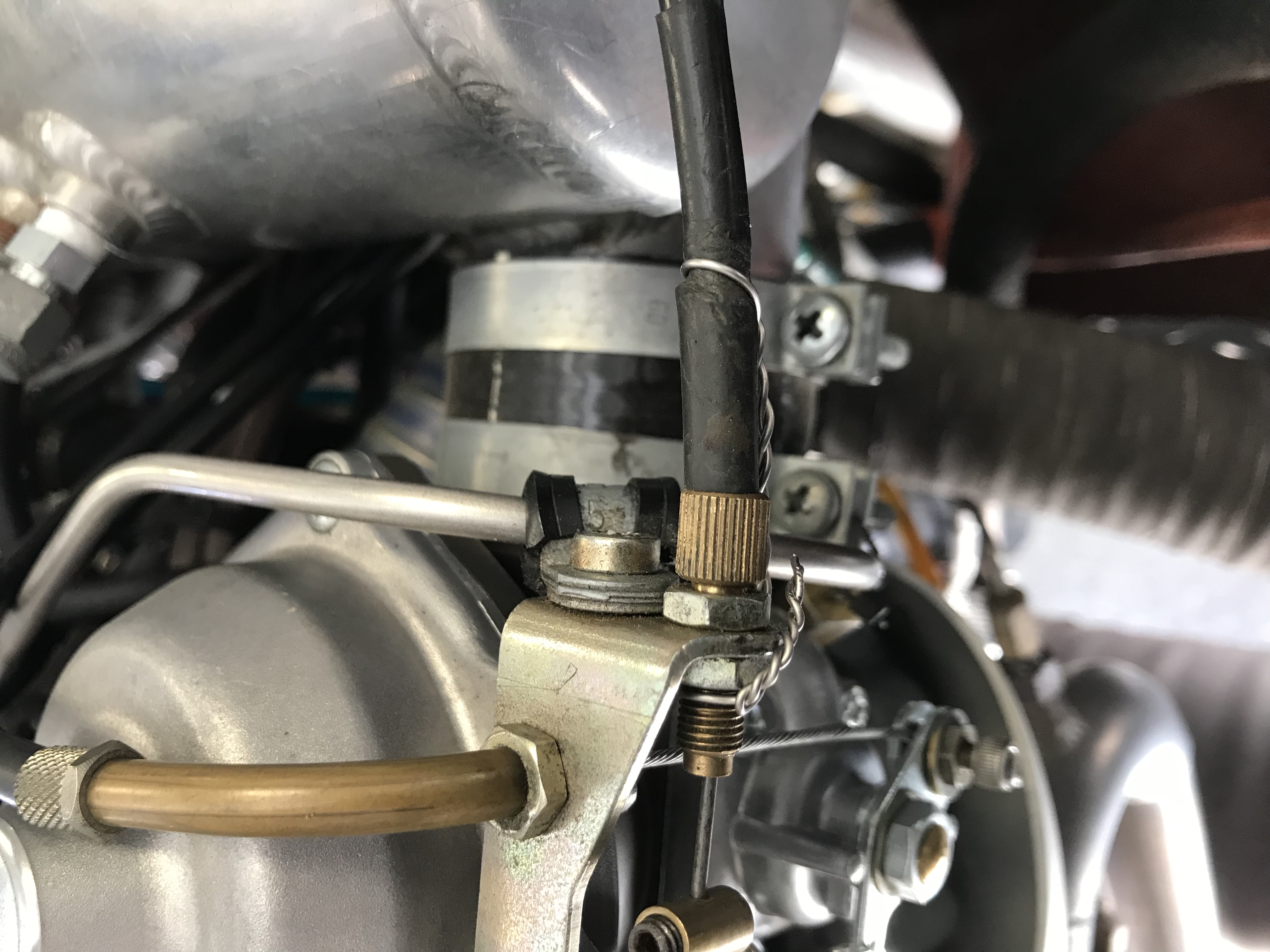

erichdtrombley(at)juno.co
PostPosted: Sat Nov 25, 2017 6:11 pm    Post subject: Throttle cables Reply with quote
Hi Richard,
Attached is a photo of the cable attachment at the carb. As I did not purchase the Europa firewall forward kit, I made up my own bits. I used bicycle brake parts for the cable sheath cut to length. As the O.D was slightly smaller, I used heat shrink tubing on the end to make up the difference, and then safety wired it in place. At the throttle box I used a bicycle cable adjuster and just attached it with a nut to the box. Let me know if you have any other questions.
Erich Trombley
