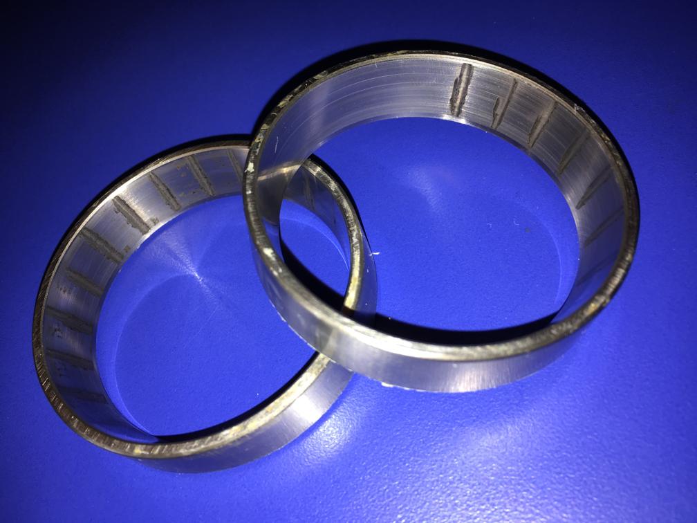

Here's a picture of some of the cups I just changed.  I change them when they have even just one of the marks on the inner surface.  So obviously these are toast.
My plane sat in 2016 from April to October.  I suspect that may have something to do with these marks.  I'll be paying closer attention next year.  All the bearings in both MLGs and one side of NLG were replaced.
The rollers had corresponding marks.

Thanks for posting the pics and part number recap for the people who want to
save this for future reference!
Those marks almost have to not be from USAGE wear, but from sitting wear.
Notice how they are only on 1/2 of the race...that seems to indicate,
in my non-expert opinion, that either that is the side that all the weight
was on, or that was the side that had not much weight and therefore
had enough of a gap that moisture got in.
I would think that these went bad strictly from sitting too long with
moisture around.  Was this still somewhat near the ocean?
I bet if you had flown regularly you wouldn't have seen this.
The unevenness of the marks also make me wonder if maybe the
bearings were just slightly loose.  That's just thinking out loud...not
that I'd advise you to do anything different.
Anyway, very interesting.  If you scotchbrite those marks, do they polish
off? I wonder how deep they go.

Ya l think ya got it narrowed down there Wink.
It was parked for engine work for spring/summer 2016. It sat in a hangar in San Jose, so probably less salt air than Watsonville but still maybe some.  I’ve heard the rule of thumb is within 30 miles of salt water. But then it’s lived at WVI since 2007 without any real corrosion anywhere to speak of.
The marks aren’t gonna polish out.  They’re significant.

Do you recall which grease you were using while the airplane set? Just curious as I’m getting ready to repack (hopefully not replace!) my bearings.
I’ve got Aeroshell 5 in them now. The supplied wheels and bearings from Cleveland had Mobil SHC 100 installed in them from the factory.
I’m wanting to look at the corrosion inhibitors in each available grease going forward.
Phil

I had Shell 5 in the mains and SHC100 in the nose. The nose failed one of
the two. All the mains failed.
--Dave
