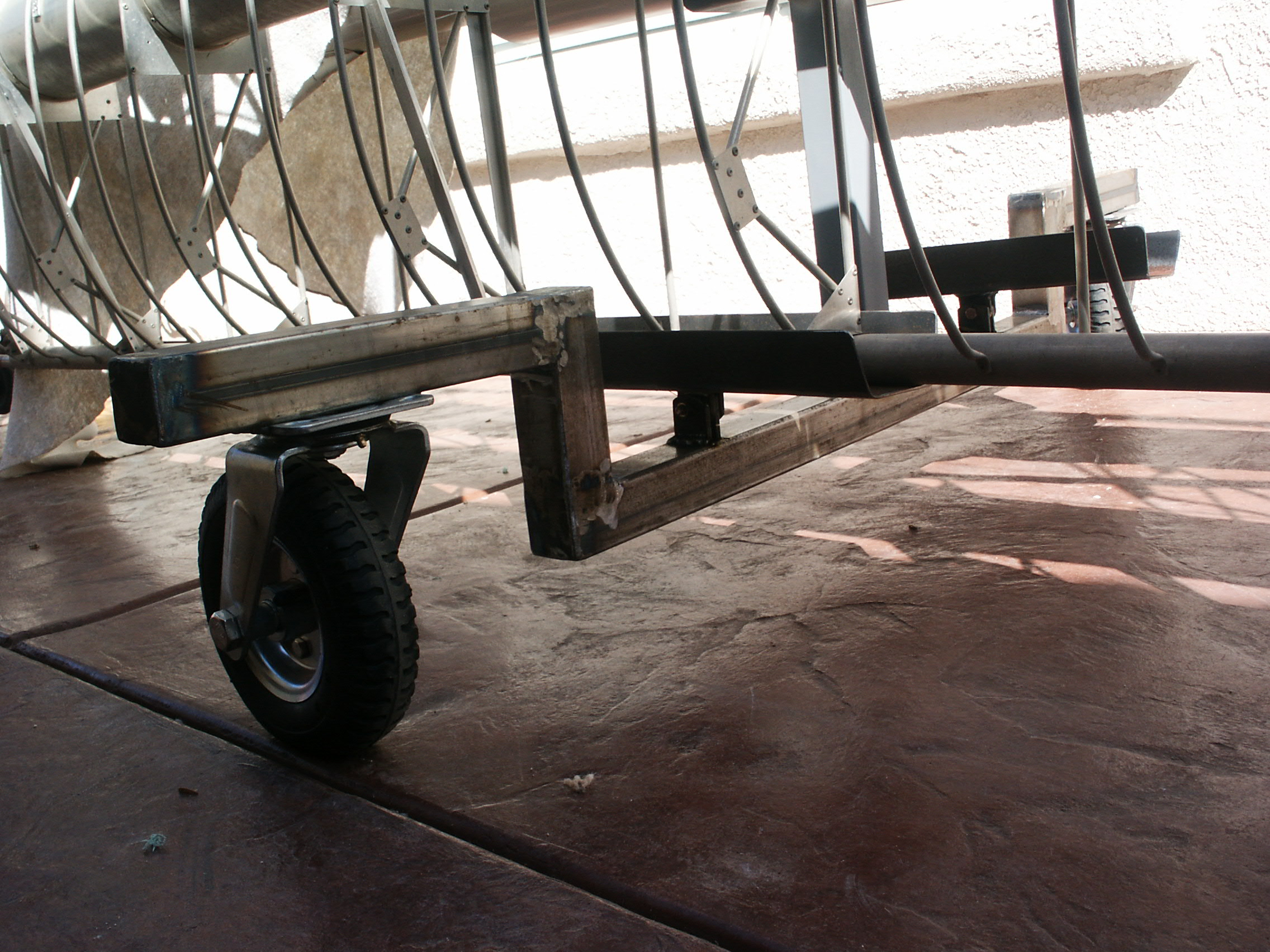

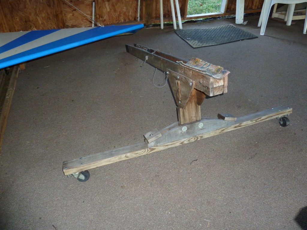

I have this one photo of a boom/wing caster assembly. I'd like to see a tailwheel hook for moving the plane when the wings are folded.
 Filesize:  94.85 KB
 Viewed:  14873 Time(s)

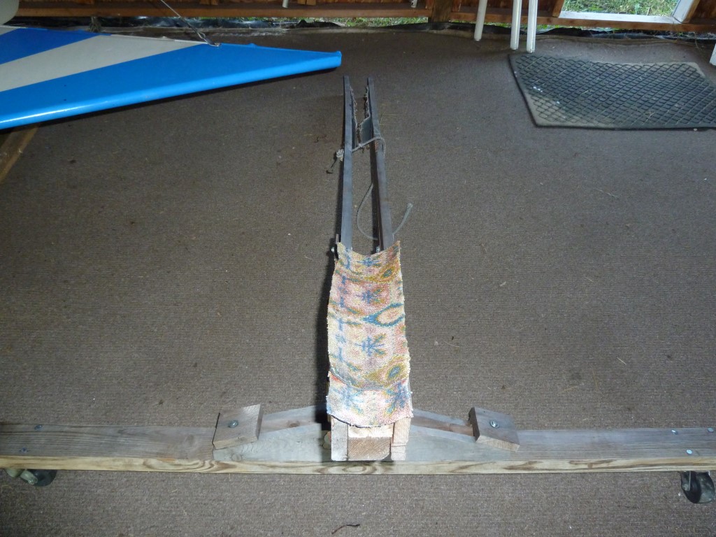

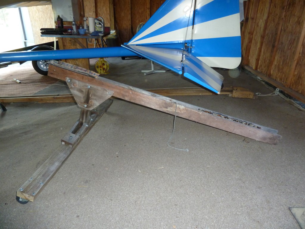

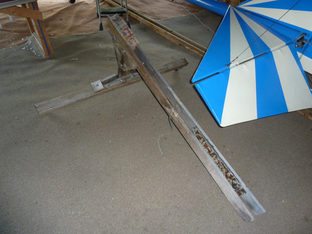

PostPosted: Sun Nov 05, 2017 4:33 pm    Post subject: Re: Wing support dolly Reply with quote
Vince designed this for his FSII, we are using it on the FF, and it works good. A little explanation is in order: the two 1x4's lay on either side of the lower fin, and above the tail wheel, including above the arms that come out at the base of the rudder. The rest of it extends foreward so that the 2x4 with the castors on it is about even with the forward end of the vertical fin.
Notice the rope that goes through one of the 1x4's about half way along: the rope goes through the opening just behind the aft fuselage ring where the elevator and rudder horns are, goes down to below the lower fin, and back up where it is passed through the rope loop and tied off to secure that section.
Up at the front end, there is carpet to pad things, you also lay carpet over the boom tube and tie that all together with a rope wrapped around it.
The two ends of the 1x4's stick out the back beyond the rudder a bit and you can use them to pick up the tail of the airplane or guide it around. The aft ends of the 1x4's have carpet padding on the inside to protect the fabric on the lower fin and the rudder.
It is a bit tricky to get it in place the first few times, especially by yourself, but it works good once the airplane is tied to it. And when you fold the wings, it keeps the leading edges up away from the ground.
You do want to have the horizontal stab tied up alongside the vertical fin before you start trying to get the dolly into position.

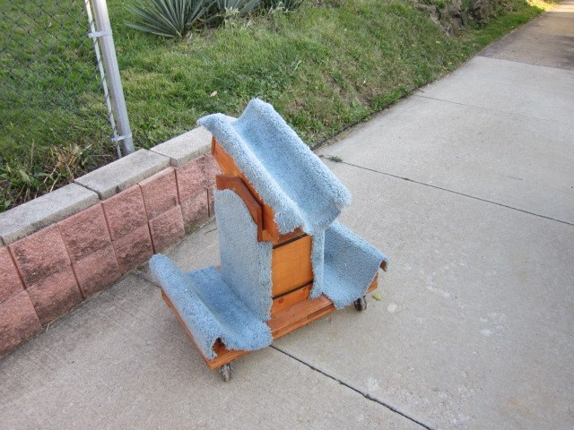

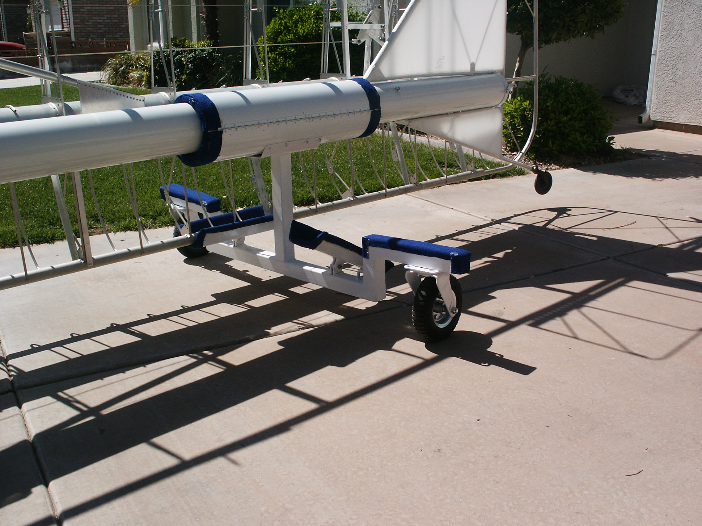

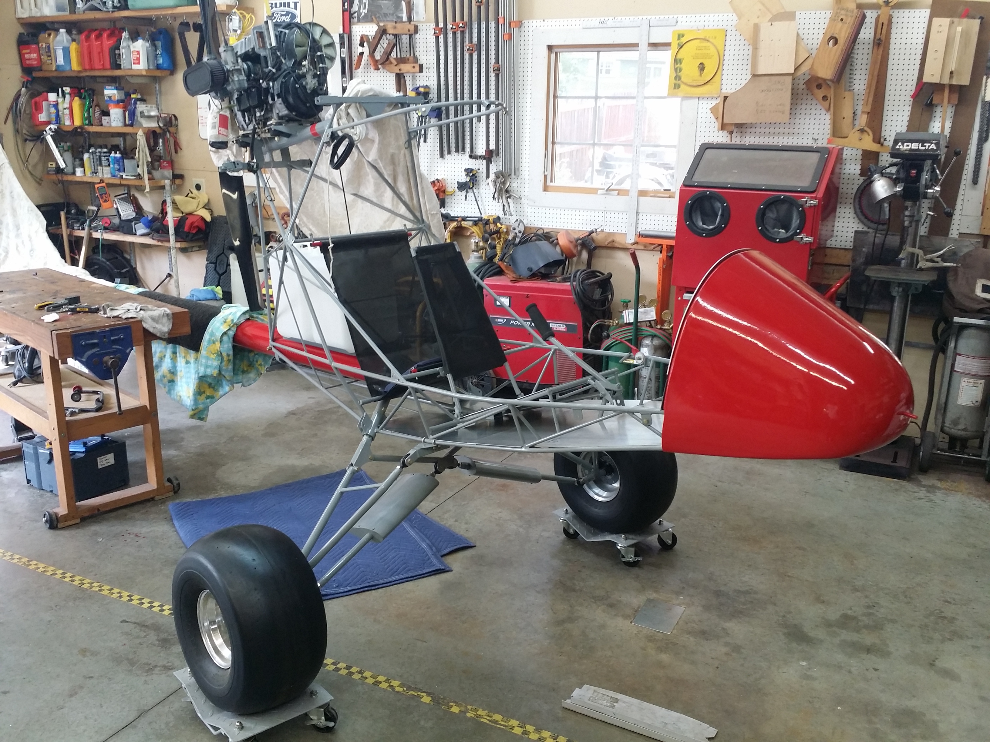

PostPosted: Thu Nov 16, 2017 11:42 am    Post subject: Wing support dolly Reply with quote
Here is what I built a long time ago.  The second picture shows it being built and before paint and upholstery.  The round hinged tube is an 8” diameter PVC water pipe given to me by our local water department.  (They give away short pieces).  The wing supports rock back and forth to allow for full support of the leading edge.  The wheels are Harbor Freights.  The upholstery is heavy duty fabric, foam and a hot glue gun.
Mike Welch
[img]cid:EACD94F7-0D41-450F-B533-5D1ADF6CC3DF[/img]
[img]cid:E2E26A45-2B5D-42E8-B1CB-A234EC6B7C46[/img]

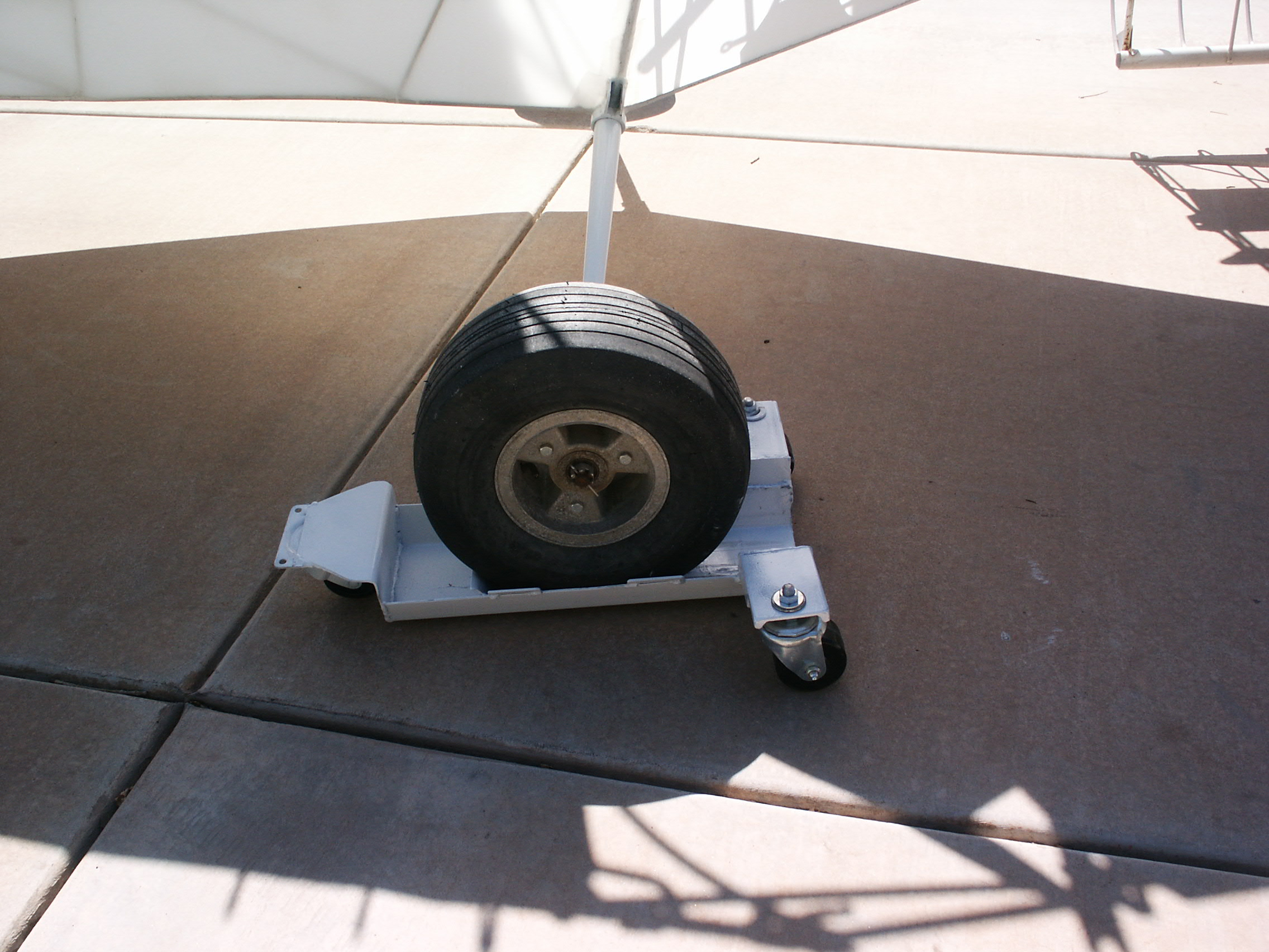

I made these for the front wheels.
Mike W.
[img]cid:3AA0F59F-F2C7-4085-8A27-F351E220A02A[/img]
 Filesize:  638.52 KB
 Viewed:  14697 Time(s)
