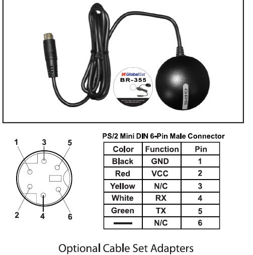

I have been using one of these with no issues:
GlobalSat BR-355 Serial GPS Receiver

I have 2 of the BR-355's as well.
I only mentioned the GPS18 because it's one that may be
more familiar to some people, and can do 9600 baud.
That said, my advice for you is this if you go the BR-355 route:
Contact GlobalSat...they will sell you a 9600 baud version of
the BR-355. I bought 2 of them from them last year. I have one
of them in my RV-14, in fact, set up with a switch to be the backup
GPS for my TruTrak. They're a good little GPS that you can
buy for under $50. I don't think you NEED 9600 baud for the
TruTrak, but I'd go that route if at all possible.

PostPosted: Wed Nov 01, 2017 3:35 pm    Post subject: ipad gps Reply with quote
I found this on the internet doing a search for BR-355 pin-out.
You can get the connector at digikey or mouser electronics.
This DIN connector is the same as that used on the OLD PS-2 Mouse / Keyboard (Pre - USB)
Jim C

PostPosted: Thu Nov 02, 2017 7:11 am    Post subject: ipad gps Reply with quote
Power may be the hardest part about the BR-355. I can't remember for
sure but I think it runs on 5V. So I had to throw together a simple
5V regulator that I mounted nearby and ran 12V into that.
That's one thing about the Garmin GPS 18...I'm not sure if it reduces
the 12V in the lighter plug, or if it's 12V all the way to the puck,
but it may eliminate one step of getting something that works.
https://buy.garmin.com/en-US/US/p/27594
For the BR-355, I cut the connector right off, wired it to a DB9,
and hooked up my own power module to power it.
Tim

PostPosted: Thu Nov 02, 2017 7:29 am    Post subject: ipad gps Reply with quote
I have a Garmin puck feeding my ELT running off of a 5V DC-DC converter: Recom Power R-78W5.0-0.5
Mouser has it for under $8.40.
The puck comes with a cigarette lighter adapter, but the 5V converter is much smaller.
Lenny

PostPosted: Thu Nov 02, 2017 7:42 am    Post subject: ipad gps Reply with quote
Exactly. If you get a puck, plan to just chop the cable up anyway. In the end you can make it smaller and lighter and not have to deal with anyone’s special plug.
Tim

for APRS tracking and wanted to be able to use 9600 baud for
that. I also feed my TruTrak as a secondary GPS.
Hot tip: There's a magnet in the case that you can pull the
sticker off and then use a screwdriver to pry the magnet out
of it. I didn't want a magnet anywhere near my plane.
Once the magnet is out, the puck weighs almost nothing and you
can secure it with velcro somewhere. I have one in a wingtip
and one under the VS fairing and both work perfectly.
Something like that DC-DC converter you found will work well.
I think I have that on one of them, and on the other I used
an LM7805 5V regulator similar to this, along with a couple
other components:
https://www.sparkfun.com/products/107
cheap to do either way.
Lenny's DC-DC converter I think is this one:
https://www.mouser.com/ProductDetail/RECOM/R-78W50-05/?qs=T0XSgvH75d6ym%2FmhBy%252boCA%3D%3D&gclid=CjwKCAjwhOvPBRBxEiwAx2nhLm6kZTNFsk-7LUrrI2uK_jNuTKkH5mIPGaB6Xfr_sIi4wxc-4RUORRoClb4QAvD_BwE
It's also cheap and simple. You don't need a lot of wattage
to drive this GPS. His can use source voltages of 6.5 to 32V,
so may be a real nice option. Your GPS would be one of the
last things in the panel to die if you lose power, and would
be one of the better power-spike survivors at 32V.
Tim

--> RV10-List message posted by: Tim Olson <Tim(at)MyRV10.com>
Tim
On 11/01/2017 05:44 PM, Albert wrote:
This from TruTraks Installation Information: The Garmin 496 was wired to Pin 7.
Pin 7 is Primary Serial Input. Baud rate selectable 1200, 2400, 4800 or 9600 baud. Automatically decodes NMEA-0183, Garmin Aviation Format, or Apollo/UPSAT MovingMap or GPSS format. Provides directional reference to the autopilot.
How does the Global Sat BR-355 get power and how does the GPS signal come out of it? The picture looks like it has a USB connector. Does it have a serial connector also? I'm very interested because it looks like that might be all that I need.
