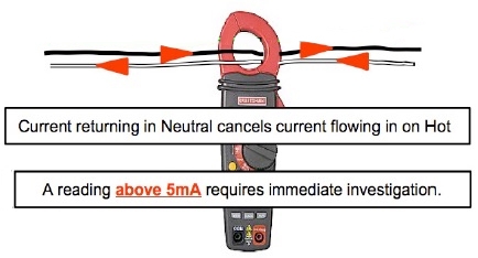

You could use such an instrument to detect wiring faults
by running BOTH supply loop wires thorough the aperture.
[img]cid:.0[/img]
During normal operation, the current flowing in the outbound
wire (hot) exactly equals the current on the return (neutral)
wire. Snapping the ammeter over a properly operating power
pair will show a net current reading of zero.
Now, assuming there is some leakage current from hot to
a remote ground, there will be an imbalance in the hot
vs. neutral conductors. If this current exceeds something
on the order of 5 MILLIAMPERES, the magnitude of leakage
is considered hazardous. Most service instruments are
not sensitive enough to detect/measure leakage currents
this small.

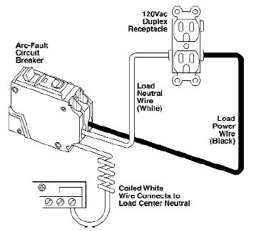

The illustration above shows how the leakage is
monitored by passing both paths through the same
aperture. Making this happen in a GFI breaker
requires that both the hot and neutral wires pass
through the breaker.
[img]cid:.1[/img]
This illustration shows that instead of taking
the neutral wire right to the panel ground bus, it
goes to a terminal on the breaker. So not only
will this breaker have TWO terminals for house
wiring, a 'pigtail' routed the panel ground bus
completes the neutral path.

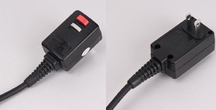

Many appliances like hair dryers and pressure
washers have GFIs built right into the plug on
the end of the cord.
[img]cid:.2[/img]
Note that many end-of-cord GFIs don't feature a third prong
for safety ground . . . it's not needed to monitor and
react to an IMBALANCE of current flow on the hot/neutral
pair.

2nd Question:
In using a clamp on meter as depicted, assuming it can detect 5ma leak, will the meter show an absolute number? or will it show a positive value for leakage on the hot leg and a negative value for the neutral leg?
That would be convenient Very Happy
John

2nd Question:
There is no 'polarity' to an AC measurement so
yes, a sensitive, clamp-on ammeter would only
display absolute value of the imbalance.
