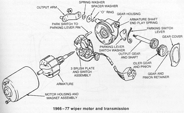

A simple DC motor spins at high speed. It drives a worm gear that greatly reduces speed while multiplying torque. The gear train turns an arm or cam with an eccentric lobe or pin, which makes the wiper arm oscillate.
Much cheaper and easier to implement than a stepper or servo motor, as no complex motor drive circuitry is required.
See attached exploded diagram.
