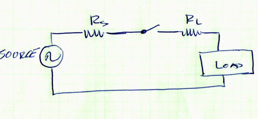

Okay, let's talk about 'inrush' currents.
[img]cid:.0[/img]
Here's a simple model of an inrush-energy study that will
suffice for this discussion. In reality, the model is
much more complex with features (inductances and capacitances)
combined with dynamics of the power source and timing . . .
if you close a switch at the exact instant the AC voltage
is at its peak, then MAXIMUM inrush currents can be expected.
On the other hand, if you can somehow close the switch while
the incoming voltage is zero . . . then inrush effects on
the switch will be . . . uh . . . almost zero.
I show two resistances, Rs which is the source resistance.
This component sets the maximum current that can flow if a
dead short is placed across the source. It also set the
requirements for 'interrupt current ratings' on circuit
breakers and fuses.
Then I've show a load resistance Rl which is controlled
by the configuration of your products input components,
in this case . . . a combined ballast and power supply.
The ballast mfgr has quoted a rather impressive inrush
current number . . . which is only partly significant.
Consider a range CAPACITORS sized from picofarads
to farads. The exact instant that your switch contacts
close, the inrush current will be V(applied)/Rs+Rl and
may very well be on the order of 100 amps . . . which
says NOTHING about the size of the capacitor, only that
V is applied over the total resitance for some period of
time after contact closure.
If C is picofarads, the DURATION of the inrush event is
very short, perhaps measured in picoseconds. If C is
Farads (like some of those capacitors favored by
installers of mobile gray-matter mashers) then the
duration of inrush event is orders of magnitude more
severe.
The ability of a switch to manage that event has roots
in contact mass, spring rates of closing forces and
velocity of the moving contact mass as it crashes into it's
stationary mate.
Contact bounce is an inevitable feature of ALL mechanical
switches. Further, the severity of bounce is only loosely
related to the switches pedigree. Here's a study I did
on a system with mil-spec, sealed relays that were GOING
to stick irrespective of how well the device was
built.
http://tinyurl.com/pstsggm
As you can see in this article, the sticking
wasn't even a high energy event. The relays were being
used in a situation well inside their catalog ratings . . .
but a combination of capacitance and PROPAGATION delay
down and back over a crude coaxial feed line stacked
up to offer the 'perfect low energy relay welder'.
The 100A inrush value offered by your supplier simply
acknowledges that there is some capacitive component
across the input to their product . . . but no help
for how large it might be.
Obviously, the COMBINATION of that inrush energy event
and contact bounce on your switch of choice has produced
a condition prone to sticking.
What kind of switch are we talking about? How long does
it take to produce a failure event? Have you been able to
duplicate the sticking even in a laboratory environment?
Are there a lot of fielded devices that may need
upgrading? One sure bet for fixing the problem and staying
with your existing switch is to add some electronics behind
the panel . . . perhaps a solid state relay with ZERO CROSSING
detection that reduces inrush to a minimum.
http://tinyurl.com/y7rst4a6
http://tinyurl.com/y8g8zyj9
Another possibility is to change the switch. Just a
difference in brand for the same physical switch
can make a big difference. Adding to Rl in the
inrush loop, either inrush limiter or perhaps just
a 3 ohm, 5 watt resistor (1A running current across
three ohms is 3 volts drop, 3W dissipated . . . but
a reduction in inrush MAGNITUDE by a factor of 3
or more . . . with an insignificant change in
over all performance.
Making the elegant decision demands more data. Perhaps
'scope traces on the inrush event. A study of bounce
characteristics of the switch. Better data on exactly
what the inputs to your loads look like will help.
But it seems likely that a change in brand/style
of switch is the shortest path and perhaps even
doable as a field retrofit. The elegant equation
demands a lot more 'numbers'

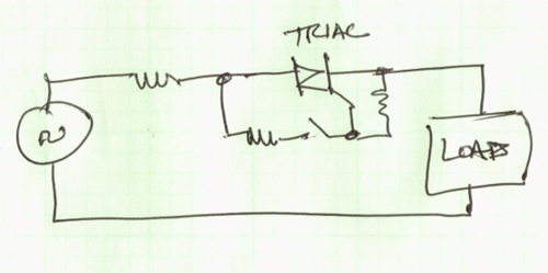

While on a patient transfer from Wichita today I
had a brain-fart that might be the simplest
solution. You could craft your own buffer
circuit for the switch from a triac and a couple
resistors like this.
[img]cid:.0[/img]
This could be nothing more than two resistors
soldered together with the triac, lead wires
attached and then coated in some insulating
encapsulant . . . maybe RTV, E6000 or thixotropic
epoxy. In technical terms this is known as a
"Kludge".
This would reduce stresses on your switch to mere
tens of milliamps and then only for tens of
microseconds at each re-triggering event just
after the ac wave form zero-crossing. Even if the
switch were close at the top of the wave form,
current through the switch and its series resistor
would be limited to an amp or so and again, for
tens of microseconds.
This buffer for your switch contacts raises
potential for a new failure mode. . . corrosion
over time on switch contacts causing them
to STOP conducting . . . not enough 'cleansing
current' flowing during each switch closure
to keep them free of oxides. But that risk
is generally years out into the future.

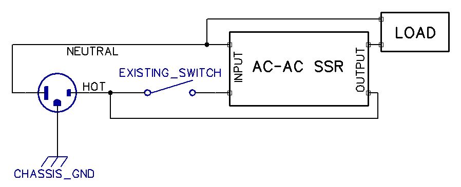

Upon reflection, the SSR that I linked to won't work without some redesign of the machine's circuitry, as it needs a DC input. The easiest retrofit for Jon to do would be to use an AC-AC SSR and control it with the existing switch that's already in the machine.
Here's an eBay search for parts that will work: http://preview.tinyurl.com/ybqcog6g
These SSRs are available from 10A to 100A; just change the eBay search term.
If using a known-source part is an issue, here's a Digi-Key search for AC-AC zero-cross SSRs, 5A or greater, sorted by price: http://preview.tinyurl.com/yamzd5vc
Connect as shown in the attached diagram.
Eric
