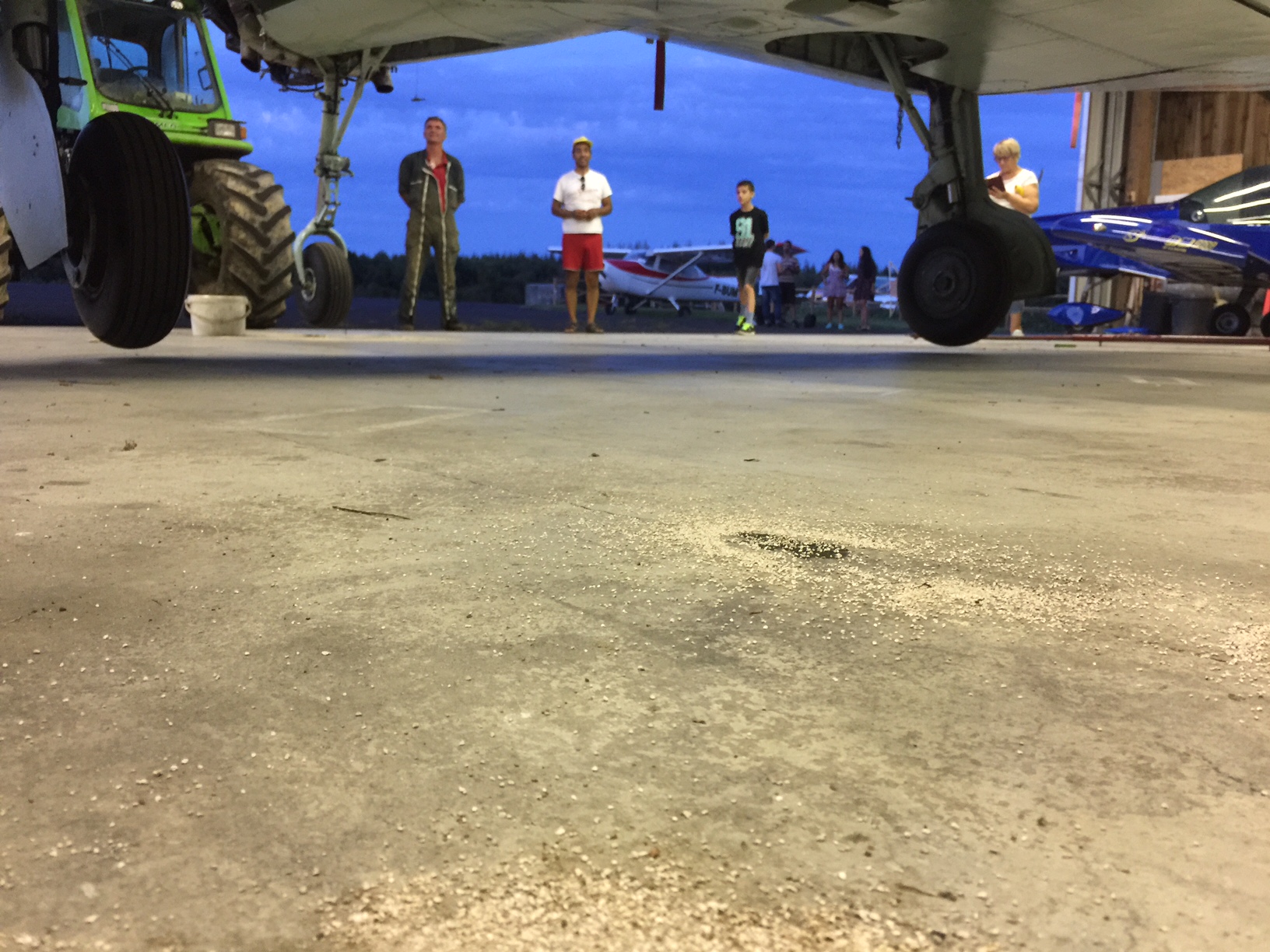

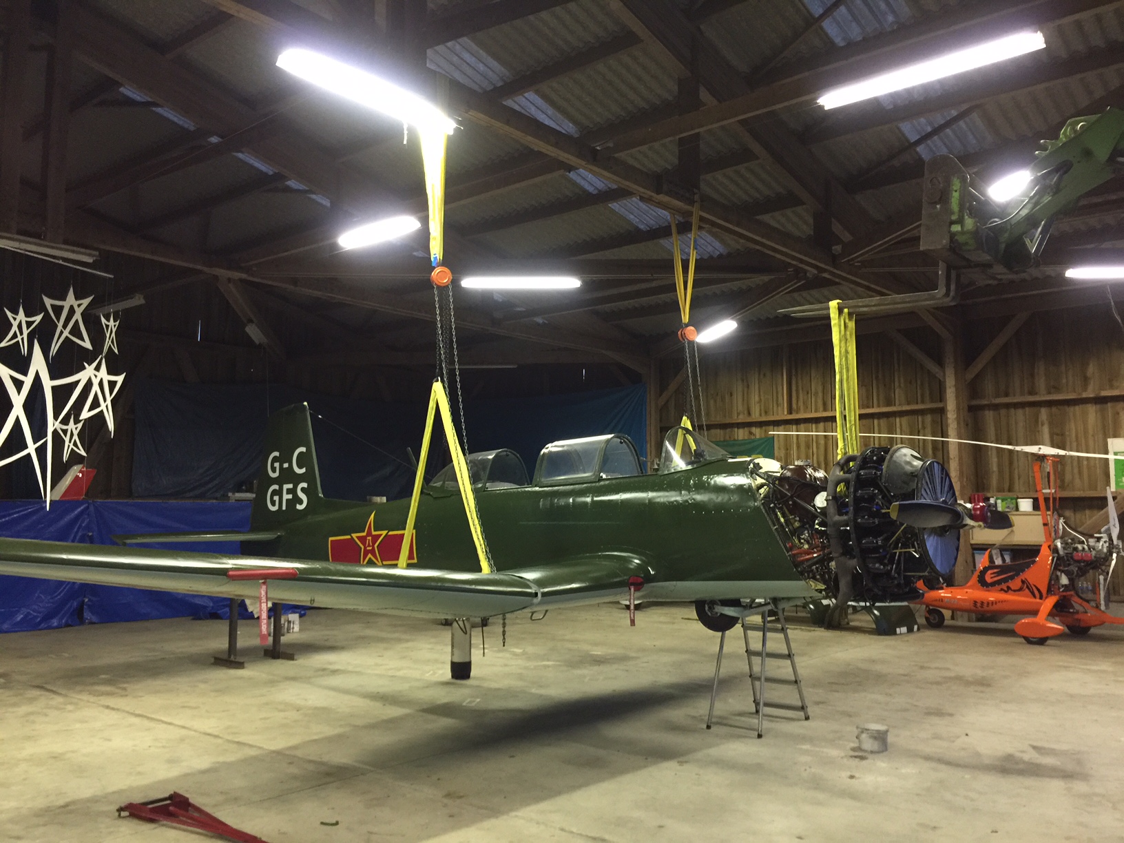

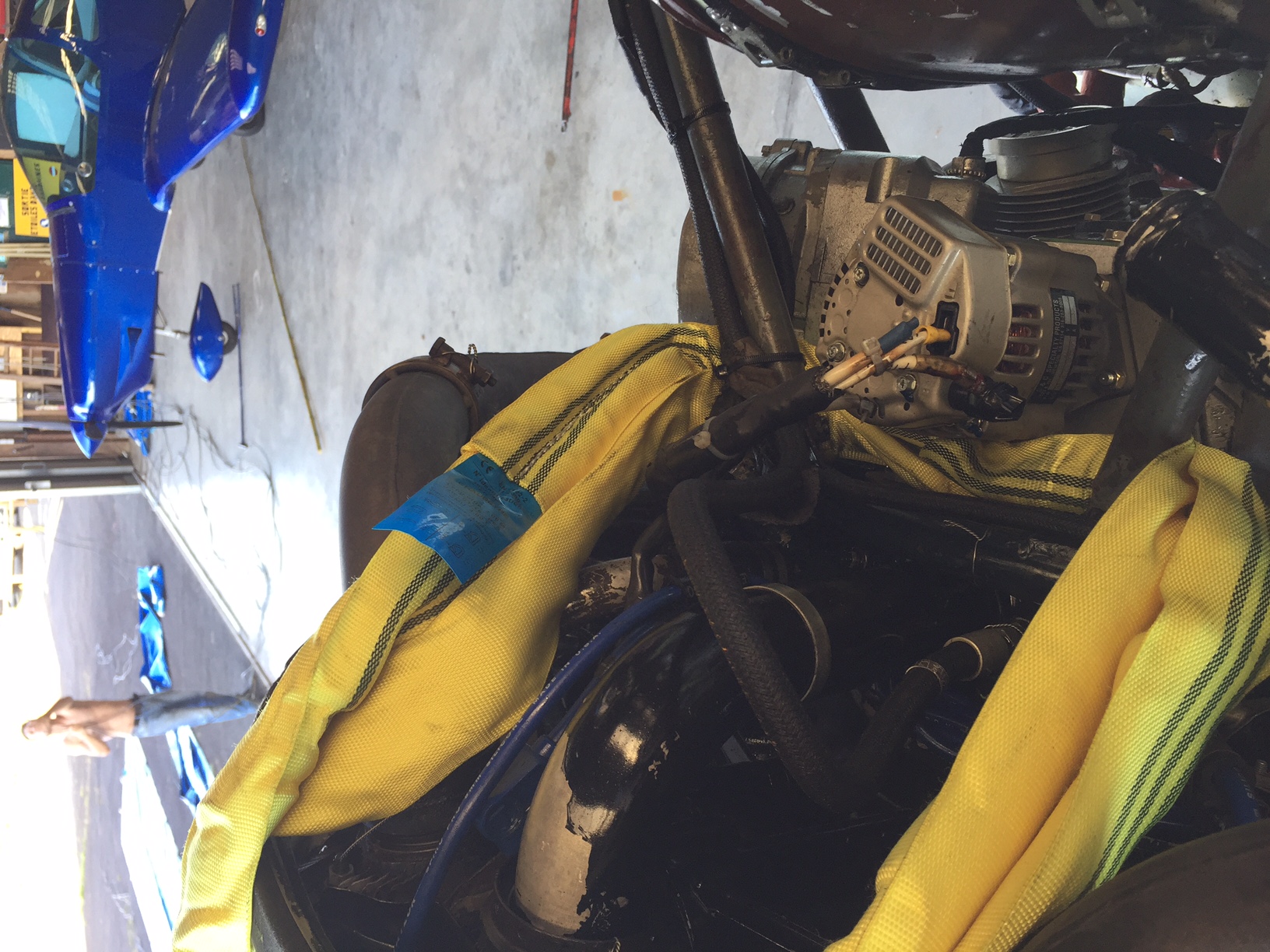

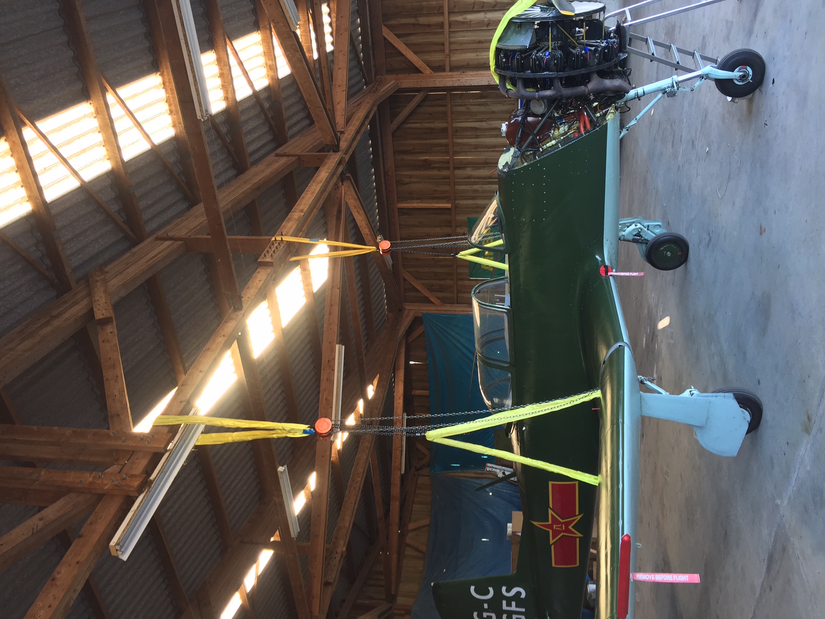

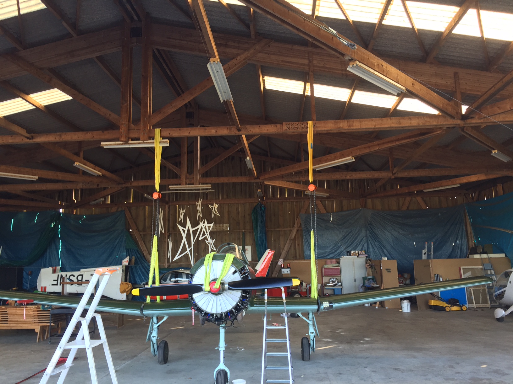

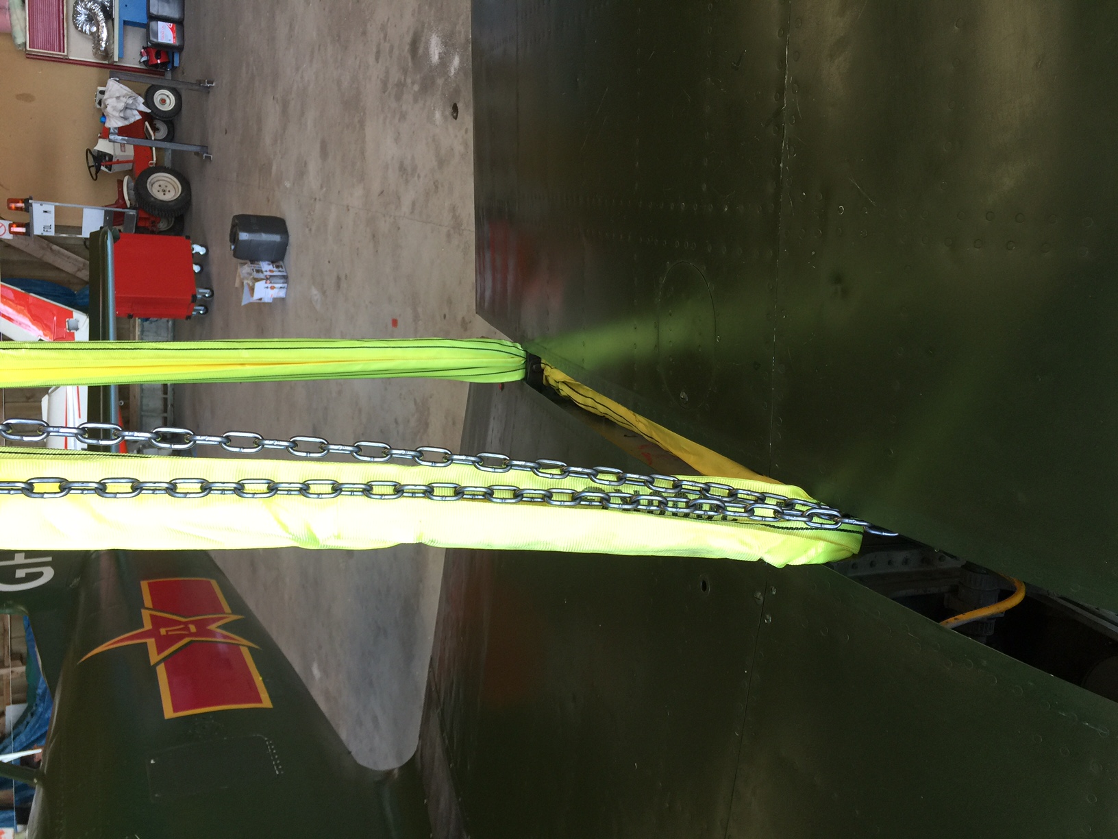

PostPosted: Tue Aug 22, 2017 10:30 pm    Post subject: Re: Cj6 lift off without jacks Reply with quote
Hello ,
Finlay we succeed to raise the Nanchang without jacks and tested the gear without any damage to the plane:
-remove the fairing between the dihedral and horizontal fixed part of the wing.
- you will find 4 mounting brackets with safety nuts , put a sling (4000lbs)below the 2 upper ones to avoid to damage hoses ans wires. Do the same for other side
- remove engine fairing and put a sling (4000lbs) bellow 2 upper bars of he engine mount as close as possible to the engine (in front of the generator)
- use 3 come-along chain attached to the frame of the hangar the both for wing will have to support about 1000lbs each, the nose one will have to support about 600lbs. check the resistance of the hangar frame is enough.
- raise slowly and silmutaneously with friends.
the plane is very stable and you can climb on it carefully.

Hello ,
wing.
generator)
Fly safe
