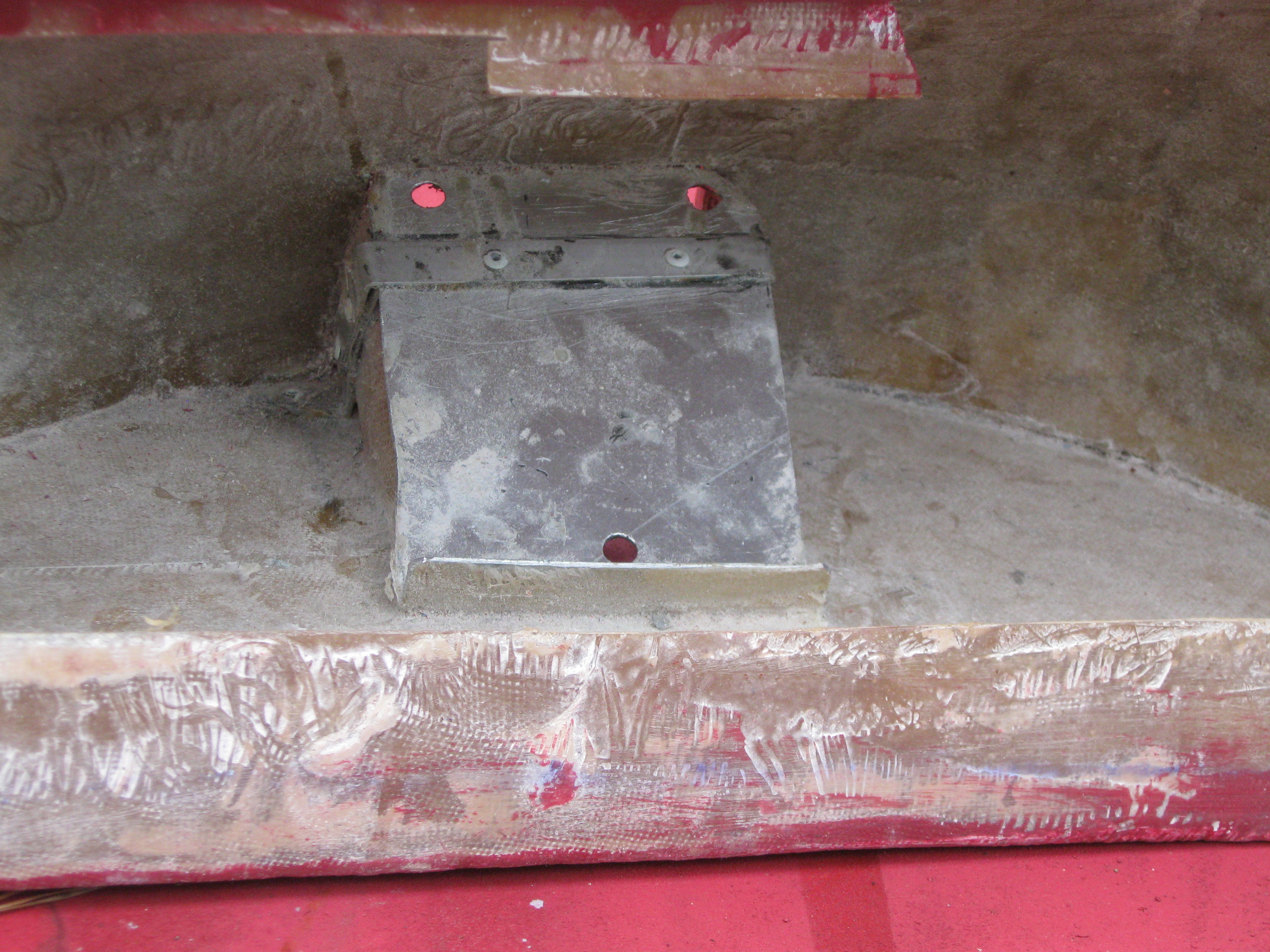

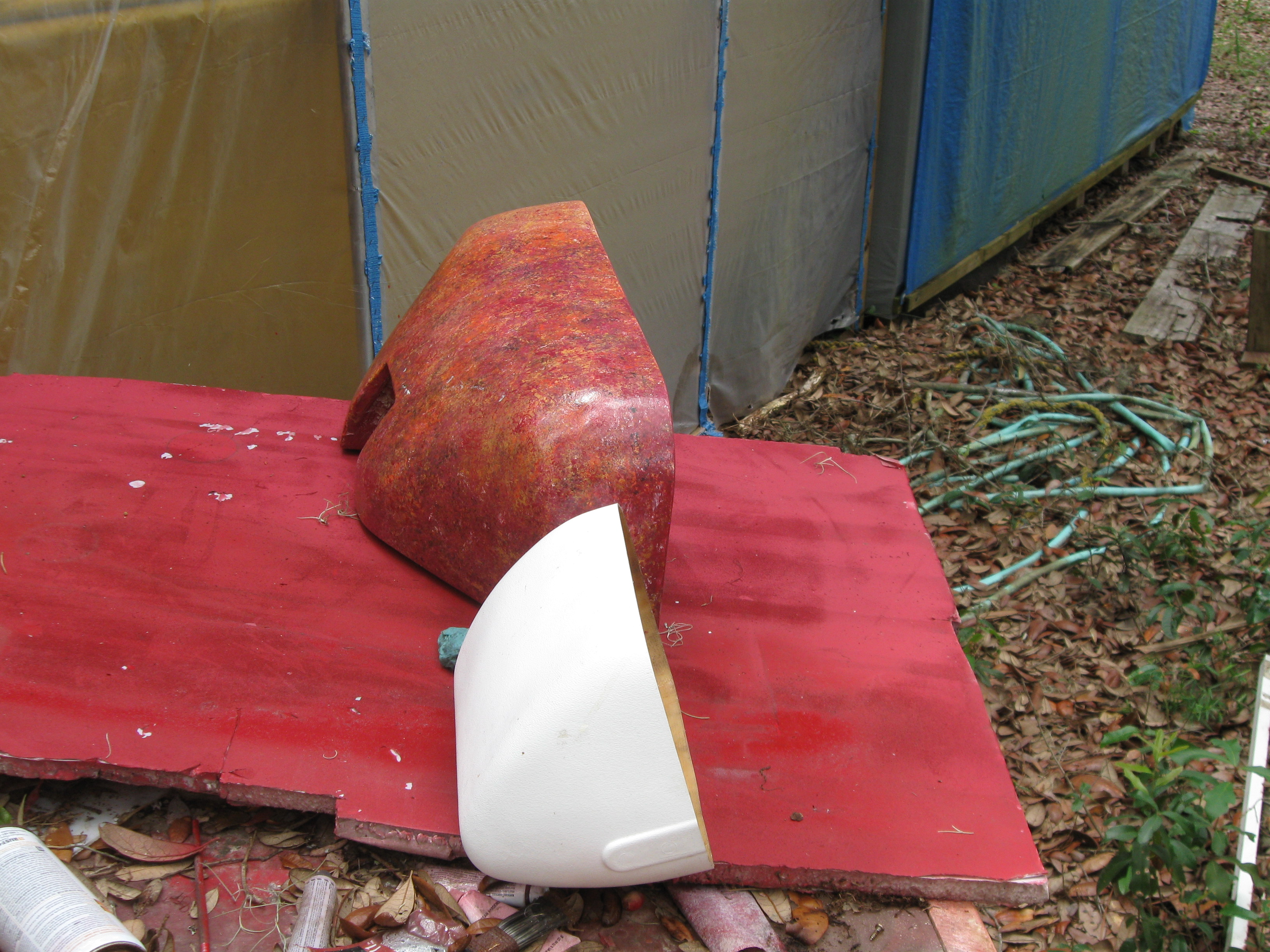

My Firestar SS is setup for a pod similar to the MarkIII. I wanted space for an I-Fly and an Amptronic GX-2 so I built one from fiberglass. I'll attach two photos to this message and a couple to the next

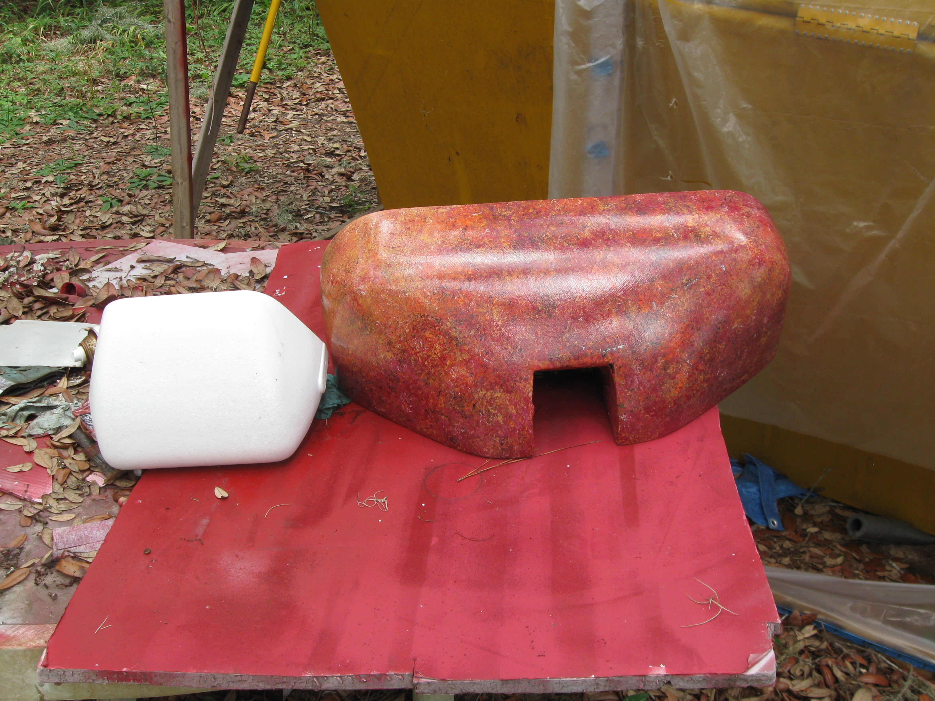

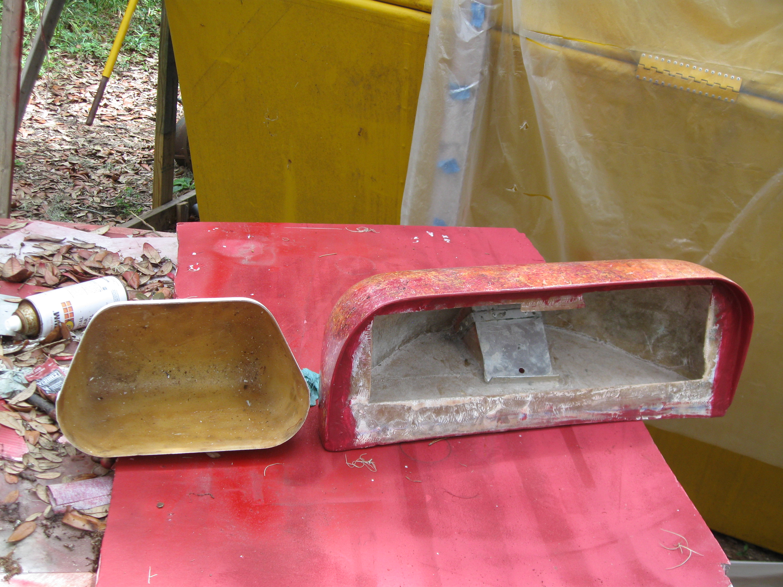

PostPosted: Fri Aug 25, 2017 10:47 am    Post subject: Mark III Classic Dash Reply with quote
more photos
