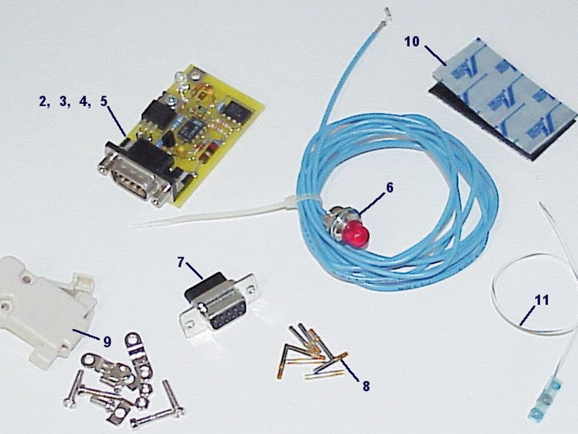

  I've posted a proposed schematic of the controller
  at http://tinyurl.com/ybbtw6dp
  A minimalist approach to packaging would
  look something like this. The fat power transistor
  would be on the bottom, heat transfer surface down.
  This would facilitate using airframe for heat-sinking
  like our schottky e-bus diode did. The connector
  would be 15 pin.  The ECB footprint would be about
  1.25 x 1.75 inches.  The 'kit' would look something
  like this except that the 700-2-7 switch is
  missing.
[img]cid:part2.D1EE81D6.29A720F5(at)hughes.net[/img]

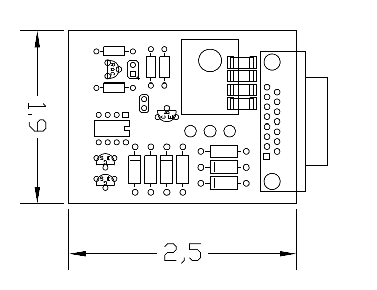

a metallic mounting base is enough. There's a cartoon
of the board layout below . . . the fet is on the bottom
of the board with heat-sink surface facing down to
contact mounting surface. This is something to be
explored in development . . . see if you can deliberately
smoke one!

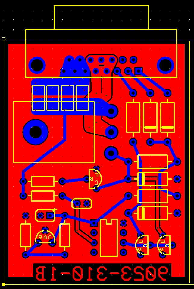

Here's how the board layout shaped up . . .
[img]cid:.0[/img]
 Filesize:  84.19 KB
 Viewed:  220755 Time(s)

I've updated the schematic with pin numbers and chip
labels that conform to the ECB layout below.
ECB files are posted also . . .
See http://tinyurl.com/yby3waw6

PostPosted: Mon Jul 10, 2017 7:11 pm    Post subject: IVO Prop current limiter Reply with quote
I proofed the ecb layout I posted. I'll get some
made. I'll have 5 or so boards to 'share' with
anyone who wants to participate in beta-testing
the hardware/software. Boards should be in
about Wednesday.
