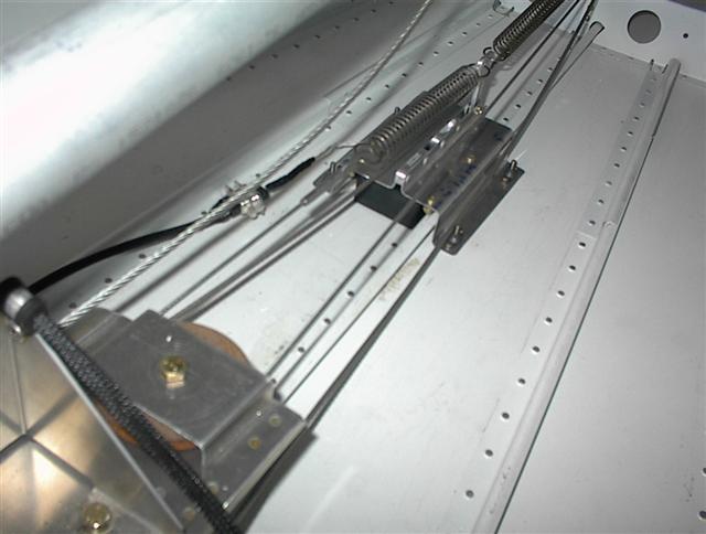

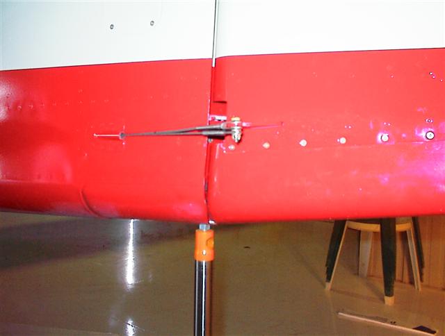

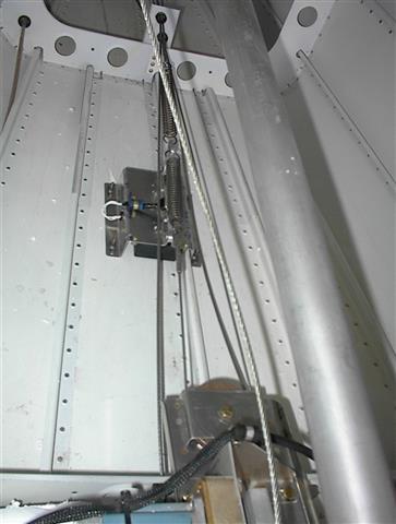

There is another way that's even cheaper. I didn't want to cut my rudder either so I used the stock elevator spring bias system to make a rudder spring bias system.
2 pieces of cable are attached to the rudder at the horn. One goes directly to the spring but the other goes to a pulley and then to the other spring. I mounted the pulley on a bracket bolted to the back of the battery tray/elevator bellcrank box.
The stock elevator spring bias assy is not modified and bolts to the bottom skin straddling a stringer.
In practice right rudder is not normally needed but long, fast descents need some left.
(Another builder uses a spring bias system attached to the rudder pedals.)
