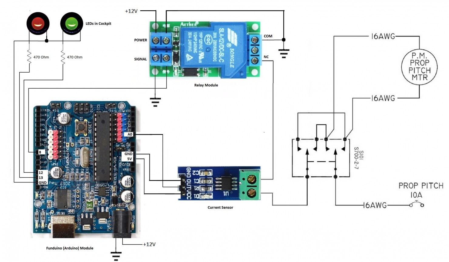

With Bob's prompting to move on to Plan B, I put together an Arduino-based IVOProp "controller."
I bought an Arduino clone, a relay module, and a current sensing module, and wrote a program to monitor the prop current. When the current goes above 9 Amps for a sufficiently long time, the program opens the relay and shuts off the current. The red and green LEDS are triggered to indicate the current flowing and not flowing to the prop. The program leaves the relay open and the red LED on for a few seconds so the pilot gets the message that a limit was reached.
I just ran the engine and put the prop through its paces, and the system seems to work well. There might be additional tweaking to the code needed, but I think it's pretty close to good.
I'll be happy to share the code and links to the components if anyone is interested.

Attached is the Arduino code for, and a diagram of the IVOProp controller.
For the diagram, I used part of one of Bob's drawings, and added the Arduino components.
These are the components I used:
- Funduino ATMEGA328P Development Board
- ACS712 Current Sensor Module 20A
- SLA-12VDC-SL-C 12V 30A relay module
I had never worked with Arduino before, so I just bought what I thought made sense.
The Funduino board might be over-kill for this application; I'm sure there are plenty
of alternatives available. The Funduino board is apparently an Arduino-compatible clone.
All of the components were purchased on eBay.
For expedience, I put the current sensor between the prop adjuster switch and ground.
It would probably be better to have the sensor between the switch and the prop,
on one of the power lines. That would allow the code to see positive and negative readings,
depending on which direction the pitch is changing. You could then prevent further movement
of the prop in the same direction after a limit has been reached. Right now, the code cannot
determine in which direction the blades are moving.
The txt file is the Arduino code. Replace .txt with .ino to open it in the Arduino code editor.

Bob,
I'm open to any of your great ideas.
I had not considered a solid-state switch instead of a relay,
but that does sound like a good way to go.
It would be nice to have this in a small package.
Right now, I have the Arduino (clone) board in an enclosure,
and the other components in the separate enclosure I had
been using for your original circuit.
Doug

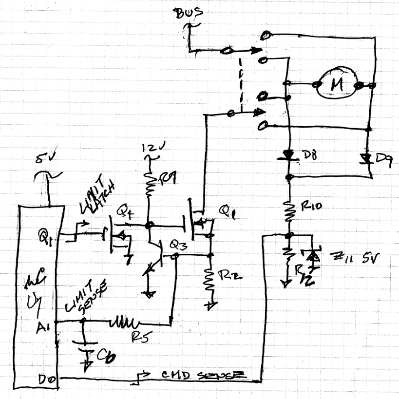

Yup . . . make it work on the bench then
'distill' it . . .
Do I recall correctly that once you have
'golden code' in the silicon, the chip
can be lifted out and dropped into an
embedded controller with minimized
peripherals?
If I were stuffing this functionality into an
8-pin PIC chip, I would explore something
like this . . .
[img]cid:.0[/img]
Set up Q1/R2/Q3 as a classic, ultra-fast current
limiter. Select R2 to target stall motor current
limit. Current limit is approximately
I(limit) = Vbe(Q3)/R1
Vbe(Q3) is about 0.6 volts. Hence, setting
R1 at 0.1 ohms would get you a 6A current
limit. I think we were shooting for 9A so
R1 = 0.066 ohms. I would parallel a number
of resistors on an ECB to achieve 66 milliohms.
Q1 doubles as a motor controller turned OFF
by clamping gate to ground with Q4.
D8/D9/R10/C11/Z12 conditions the COMMAND SENSE
signal to a discrete input.
R5/C6 conditions a CURRENT LIMIT SENSE input
to an analog input.
Q4 is a software driven clamp to remove drive
from Q1 during a LIMIT CURRENT shut down.

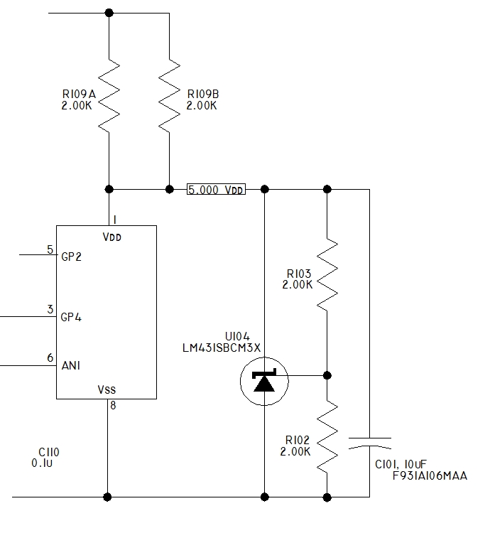

The +12 source in schematic above can be
BUS, a precision 5v source ie easily acquired for
small uC chips with a circuit like this:
[img]cid:.1[/img]
Smartware would read something like this:
Power-up routine SETS a LIMIT LATCH which
drives gate of Q4 HI.
A rising edge on COMMAND SENSE clears the
LIMIT LATCH which removes drive from gate of Q4.
LIMIT SENSE is monitored for input greater
than 0.5 volts for greater than 0.5 second.
  like this . . .
[img]cid:part1.F6F6D007.EBFDB47D(at)hughes.net[/img]
   to an analog input.
   Any excursion below 0.5 volts resets the
   limit timer.
   If limit times out, then the LIMIT LATCH
   is SET, gate of Q4 goes HI and motor power
   is removed.
   This condition is sustained until next
   rising edge on COMMAND SENSE.
to an analog input.
<5a5ac43.jpg>
limit timer.
is removed.

PostPosted: Sun Jul 09, 2017 12:05 am    Post subject: IVO Prop current limiter Reply with quote
I've converted Bob's sketches to a CAD file. Anyone with interest in the project please look over my work (see attached PDF) and post any changes/critiques for the group to consider.  When we're all happy, I'll turn it into a printed circuit board, stuff it with parts and a DIP-8 socket, and send it to Paul so he can add a programmed PIC to test with his code.
A couple of notes:
- I've assumed that the DPDT motor-control relay will be mounted elsewhere (off the PCB).
- I've drawn a notional wiring diagram including a switch and a second relay. If this isn't how the IVO prop works, let me know what to change.
- I guessed at the correct PIC GPIO pins to use.  Paul, let me know if you need something different.
Things to consider:
- For BOM simplicity, I used the same 2k resistors for R1-R8, and 0.1uF for C2 and C3. Any problems with this?
- Any other component substitutions or value changes?
- What's the desired physical envelope (PCB with mounting holes / PCB for a small potting box / something else...)?
- What type of connector(s) should be used (a DB-9 is shown)?
- Are the fuse values on the wiring diagram appropriate?
- What AWG should be specified for each wire run?
Doug (kfav8r), in order to give you credit on the schematic, would you like to send me your last name?
Cheers,
Eric

kfav8r
Joined: 20 May 2012
Posts: 14
Location: Norman, OK
PostPosted: Sun Jul 09, 2017 6:01 am    Post subject: Re: IVO Prop current limiter Reply with quote
The DPDT switch is mounted in the panel (in my case), along with the red and green LEDs.
For the Arduino setup, I have the relay and the current sensing module in a box behind the panel, and the arduino placed nearby.
On my Arduino layout drawing, the right side is from one of Bob's original drawings. He included the 10 Amp circuit breaker there, since that is what is delivered with the IVOProp.
For wiring, I used 16 AWG for any wires handling prop motor current; that is the size delivered with the prop.
My name is Doug Garland, but true credit goes to Dennis Glaeser for starting this discussion years ago, and, of course, Bob.
Doug

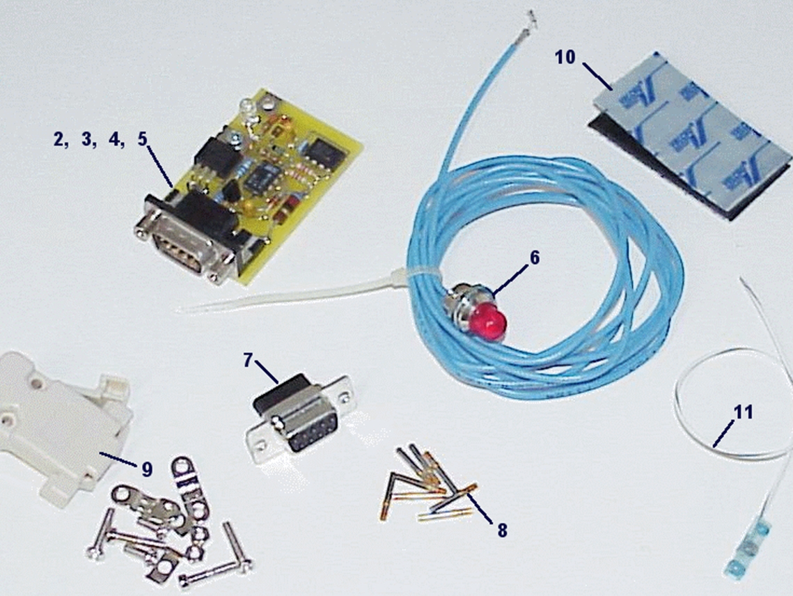

A minimalist approach to packaging would
look something like this. The fat power transistor
would be on the bottom, heat transfer surface down.
This would facilitate using airframe for heat-sinking
like our schottky e-bus diode did. The connector
would be 15 pin. The ECB footprint would be about
1.25 x 1.75 inches. The 'kit' would look something
like this except that the 700-2-7 switch is
missing.
[img]cid:.0[/img]
