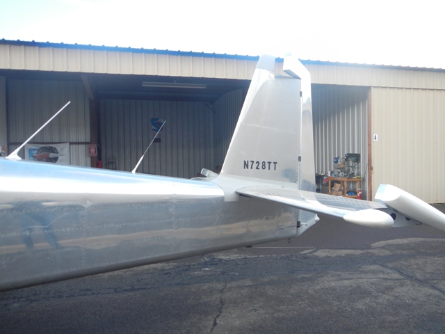

PostPosted: Thu Jun 15, 2017 1:57 am    Post subject: ELT and ELT antenna placement Reply with quote
I installed my antenna on top just in front of the vertical stabilizer per the manufacturer's plans. The ELT is mounted to the sidewall just behind the baggage bulkhead.
My reasoning is that nobody can predict the state of the aircraft once it's back on the ground. It may be upside down, right side up, or any position in between. It may be whole, or it may be torn apart upon impact. I am of the belief that speculation on the final state is an exercise in futility.
With that said, as soon as I declare an emergency, I'm hitting that little red button to set off the ELT. My hopes that whatever time left, it's transmitting my location all the way to the ground. Having it installed per the manufacturere's instructions should yield the most gain out of the antenna so that the signal has a better chance of being heard.

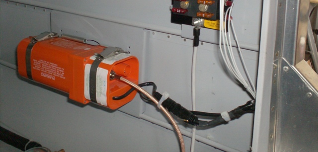

PostPosted: Thu Jun 15, 2017 4:45 am    Post subject: Re: ELT and ELT antenna placement Reply with quote
I put mine where it's supposed to be - 406 ELT on a bulkhead behind the baggage compartment, and the antenna directly above it. Photo (hopefully) attached.
John

I installed mine just like Bob Leffler did. For the ELT I used the mount Van's sells and placed it about a foot behind the baggage bulkhead on the pilot's side.
 Filesize:  75.65 KB
 Viewed:  12935 Time(s)
 Filesize:  160.92 KB
