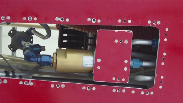

PostPosted: Fri Jun 09, 2017 4:21 pm    Post subject: Fuel filter/gascolator screen advice Reply with quote
After an RV-10 caught fire and was destroyed a few years ago due to fuel
leaking and accumulating in the tunnel I have made it a priority to check
the tunnel more often than yearly. Since it is a pain to remove the carpets,
etc. to gain access from the top I cut an opening in the floor. I left a
section of the original floor that has the filter clamp base on it. I added
some platenuts to hold the cover. I have a short bracket that locates the
section relative to the cover holes when I reassemble it after cleaning. Got
to get down but it maakes short work of filter cleaning and tunnel
inspection.
Albert Gardner
RV-10 N991RV
Yuma, AZ (109 deg today, but not the hottest day so far this year!)
 Filesize:  27.91 KB
 Viewed:  11787 Time(s)
RV-9A N872RV
RV-10 N991RV
