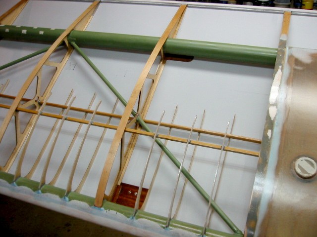

I bought a KF3 a few months back and I have discovered a couple of the ribs have movement in them when gently pressed through the fabric.  Since I did not build the plane I don't know exactly how the inside of the wing is set out, but from the outside it seems there are 2 short ribs between each full chord rib. It is 2 of those short ones that don't appear to be attached to the upper skin,.  I suspect someone has moved it in the hangar and pushed in the wrong place!
Can anyone give me an idea of how the wing is constructed, or even better a photo before covering.

Attached is a picture of how the ribs of a Kitfox wing are arranged and secured.  The smaller false ribs are only attached at two points and could bent sideways slightly between the two attached points with a little side pressure.  They should not move at their attached points.  It is not important that the false ribs be secured to the fabric itself.  Hope this helps.
John King

Many thanks for the information and the photo, it was exactly what I needed to see.
