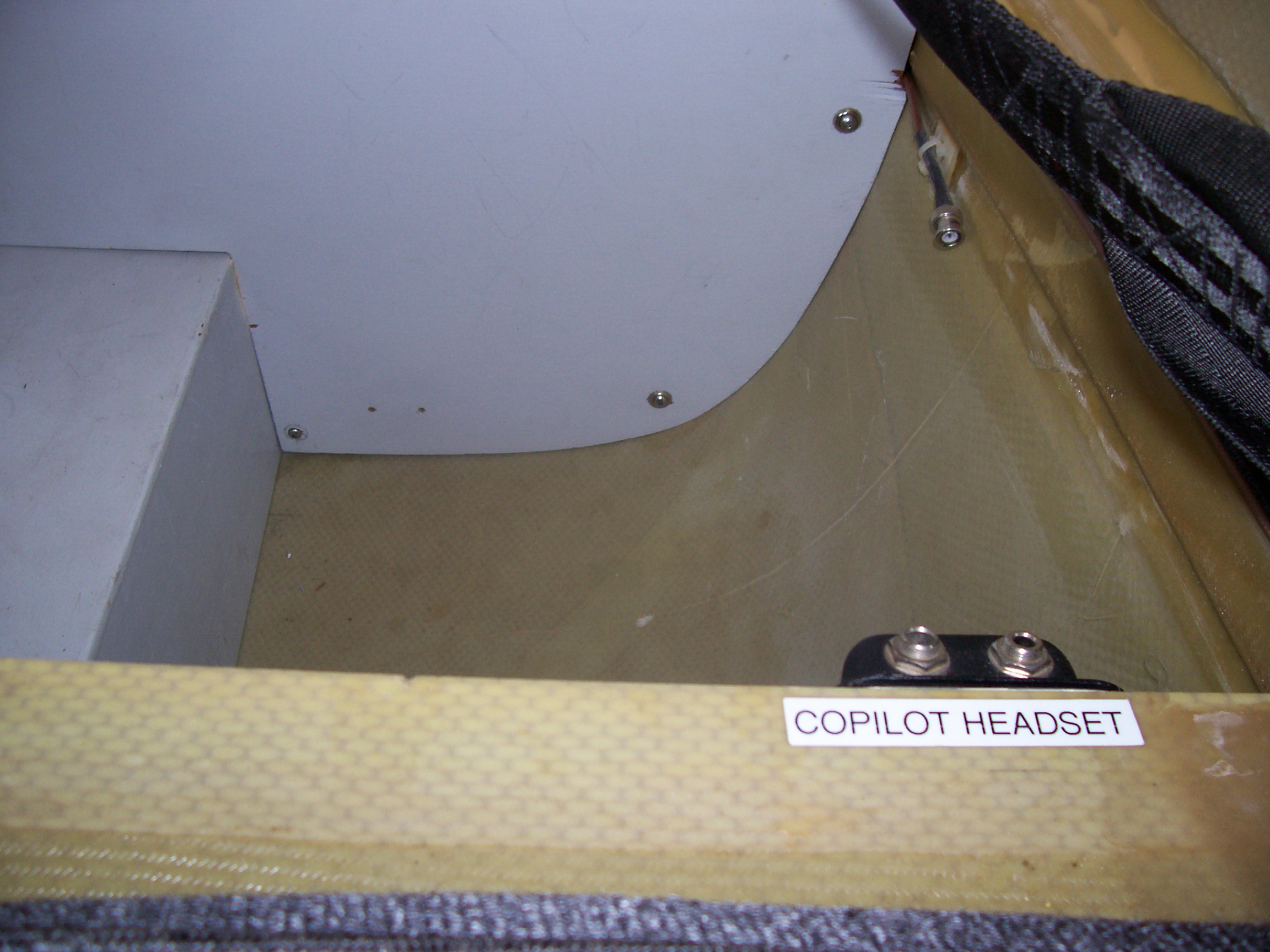

0140.JPG: This photo is looking aft at the rear baggage compartment
bulkhead. The top of the seat back is in the forefront and yes, that is the
copilot's headset receptacles located behind the pilot's seat --why? So the
copilot can both see and reach his headset receptacles while strapped into
his seat. Similarly the pilot's headset receptacles are located behind the
copilot's seat. It took me many years of flying many different aircraft with
many different poorly placed headset receptacles to come up with this
preferred location.##

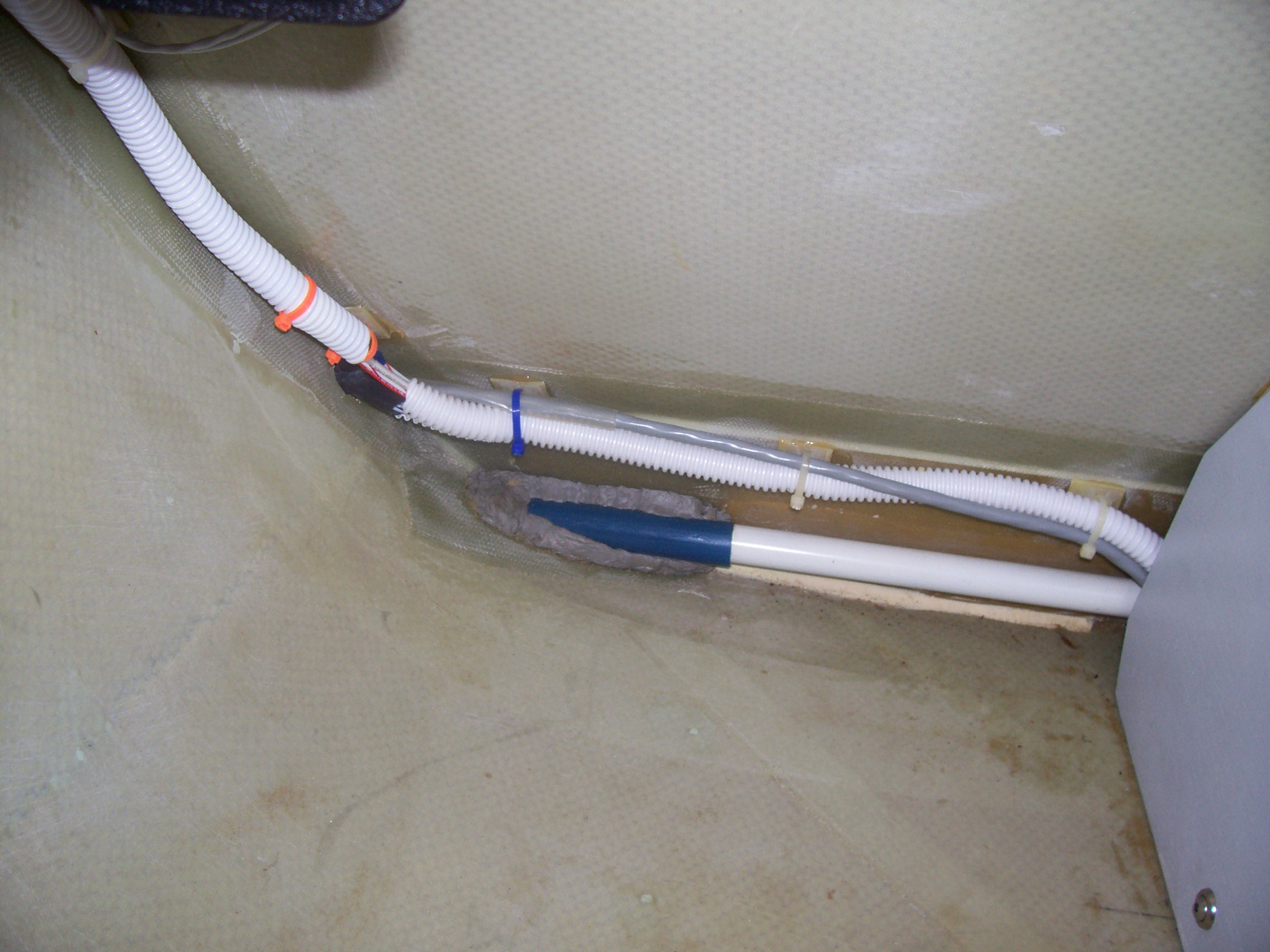

0143.JPG: This photo is looking forward at the aft wing spar at the bottom
of the fuselage interior and the seat back extending upward from the top of
the spar. Notice the items attached to the back of the aft wing spar that
would prevent baggage items from being placed directly against the spar.
