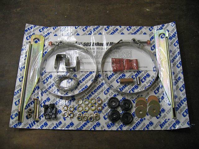

Greetings, I have a 91 Kolb KXP with a Rotax 503 DCDI. The exhaust (Muffler) bracket was mounted to two Lord Mounts attached to 2 head bolts and the other side to the muffler bracket. This is a very poor mount and places a lot of stress on the Lord mounts. It looks terrible and if the mounts broke, well I do not even want to think about that!
How have you guys mounted your Muffler systems? Are there any kits available to purchase for proper muffler mounting? Pictures of your Muffler mounting would certainly be appreciated.
Thanks in advance
I would really like to find this kit (see photo) It used to be produced by CPS in California but they no longer carry this product.
The kit I would like to find.

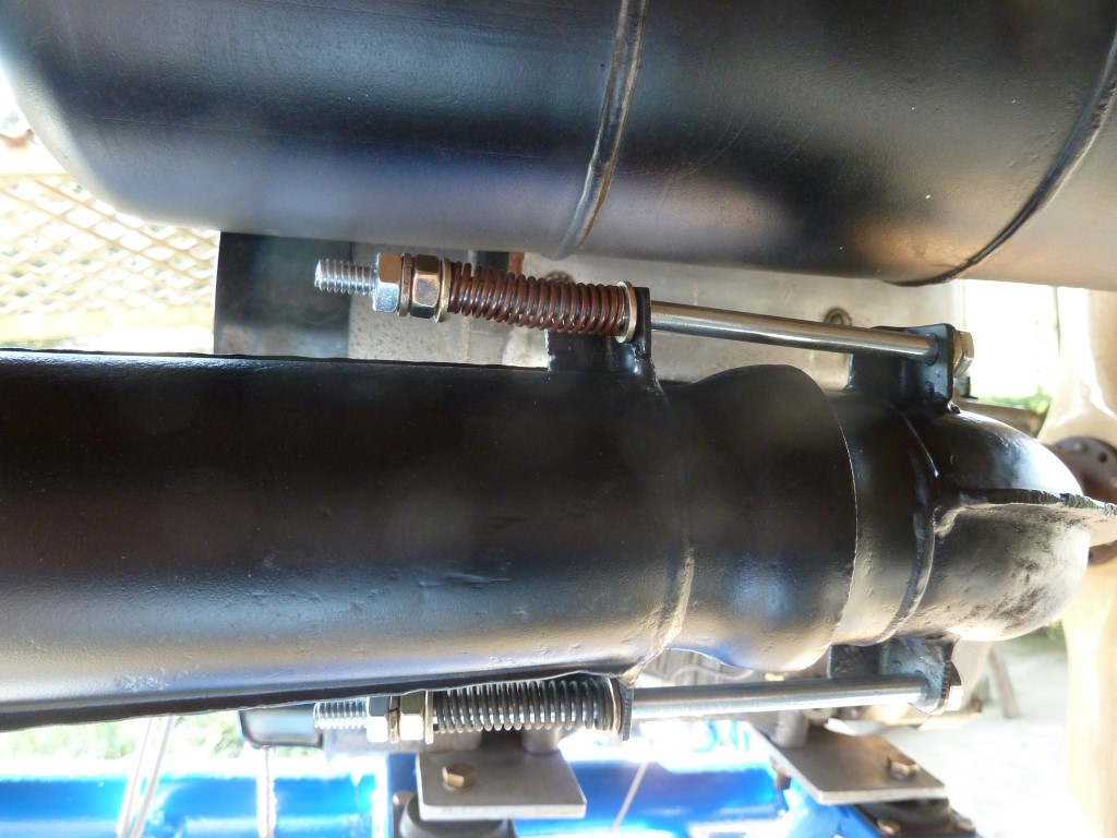

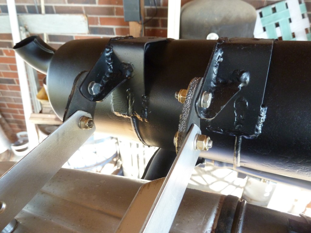

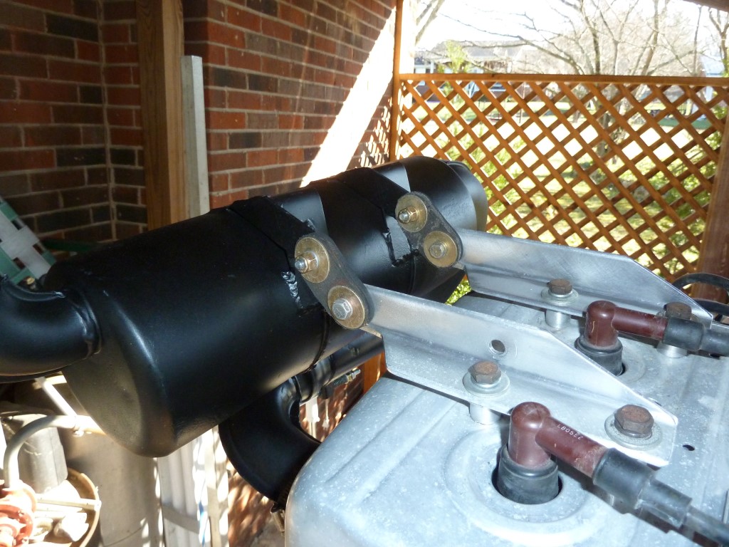

The basis for our FF project started as a Firstar / 447 back in 1985, and while the original muffler bracket system does look terrible, it had held up with no problems. However all the bolts and rubber cushions were shot, and it seemed like a good time to do an upgrade. Here is how we redid it: Get a heavy duty muffler hangar kit from Advance or O'Reilly auto parts and use the rubber hangars. Now you can eliminate one of the original aluminum angles, you do need to weld a braced tab to the original bracket on the muffler.
Also, I have never liked using the standard springs that hold the muffler to the header, so we converted to something less likely to break and go through the prop.

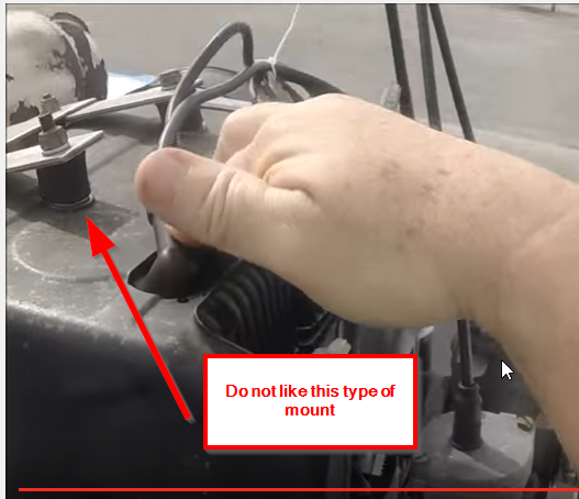

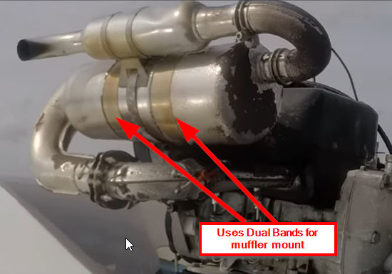

Hey, thanks a lot guys. These photos help. I do not have a photo of how my current exhaust (muffler) was mounted when I bought this plane and it is all apart right now.
They way it was mounted was with two isolation mounts (male thread on each side of a rubber block 3/4" in diameter) screwed into two of the head bolt stand-off nuts and the other end attached to a dual band muffler clamp. This setup was very weak and rested against the shroud of the engine. Put bluntly, it was ugly, weak and concerned me thinking it was going to break off and go through the fan.
Actually, I scraped a couple photos off a video I made of the walk-around of my Kolb Firestar 1

 Filesize:  294.08 KB
 Viewed:  8808 Time(s)
Isolation mounts that are very weak.
 Filesize:  298.2 KB
