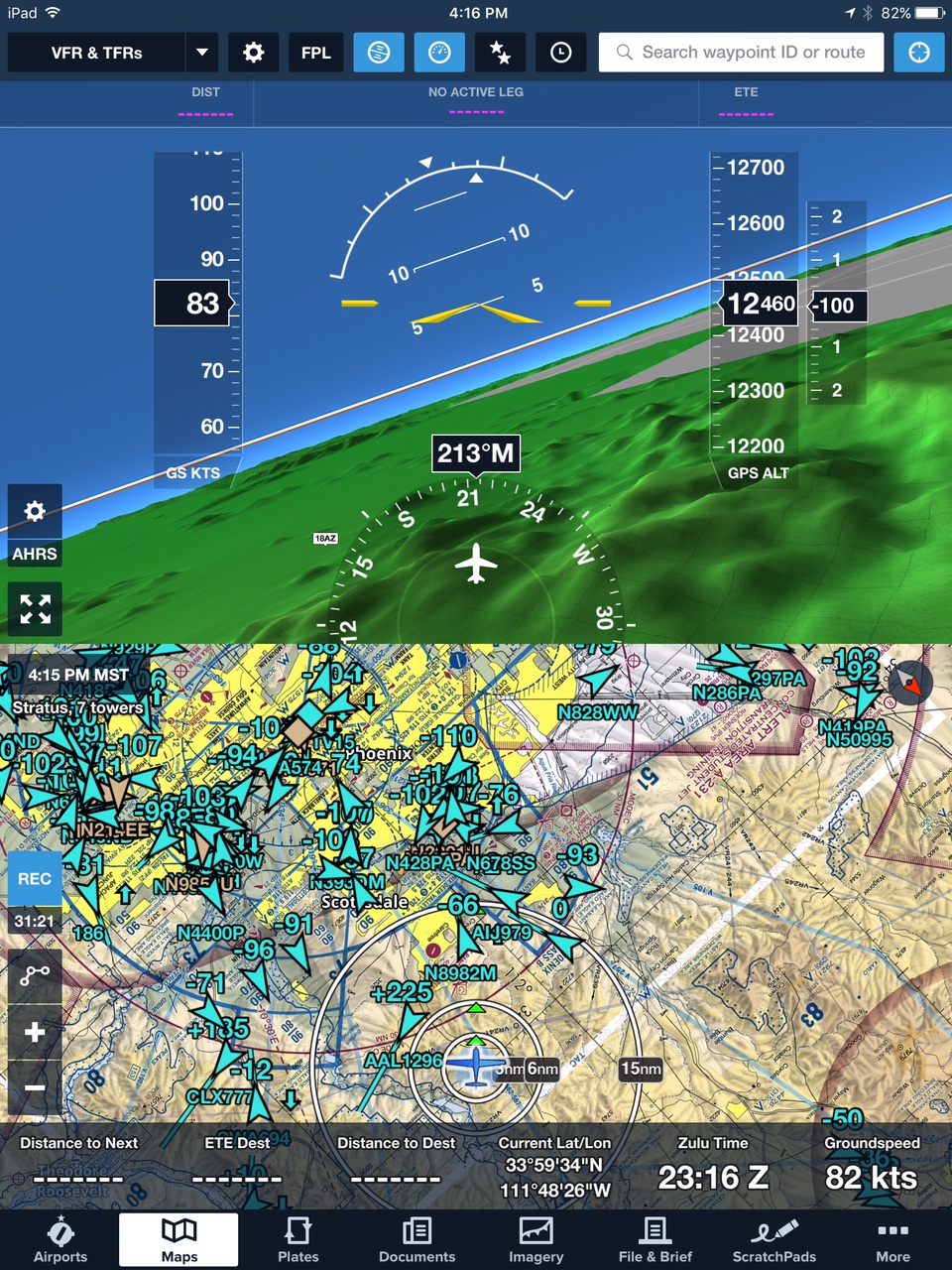

The best part is the ADS-B IN component, which provides traffic and weather on the iPad. The Stratus 2i (basically the same as the 2S but without a battery since it gets power from the transponder) also has an AHRS in it so the iPad can show a Primary Flight Display with synthetic vision. The Kitfox now has fancier instruments than the Turbo Arrow!

The older I get the more I shy away from the bleeding edge but the technology is way past the "up in the air" stage (I assume no pun was intended . The FAA is heavily invested in the technology and the ground infrastructure is completely built-out.
I suspect if the President is looking to save $$$ on airspace he'll move forward with ADS-B since it transfers a big hunk of the cost to users rather than ground-based RADAR that the FAA has to pay to maintain.
For those of us that live in congested airspace, the benefits of ADS-B IN are dramatic.

I envy your AHRS. They're working on it for the Stratux, but it hasn't
worked out yet. I'm sure it will in time.

I've installed the Appareo ESG ADS-B transponder and 2Si because I did not like having the traffic "sometimes". Still not perfect, it does not show non-transponder equipped aircraft, sometimes planes drop out for no reason and sometimes they all drop out when the radio station gets blanked by terrain. But still worth having and has been great when flying with friends, able to track them from any distance.
