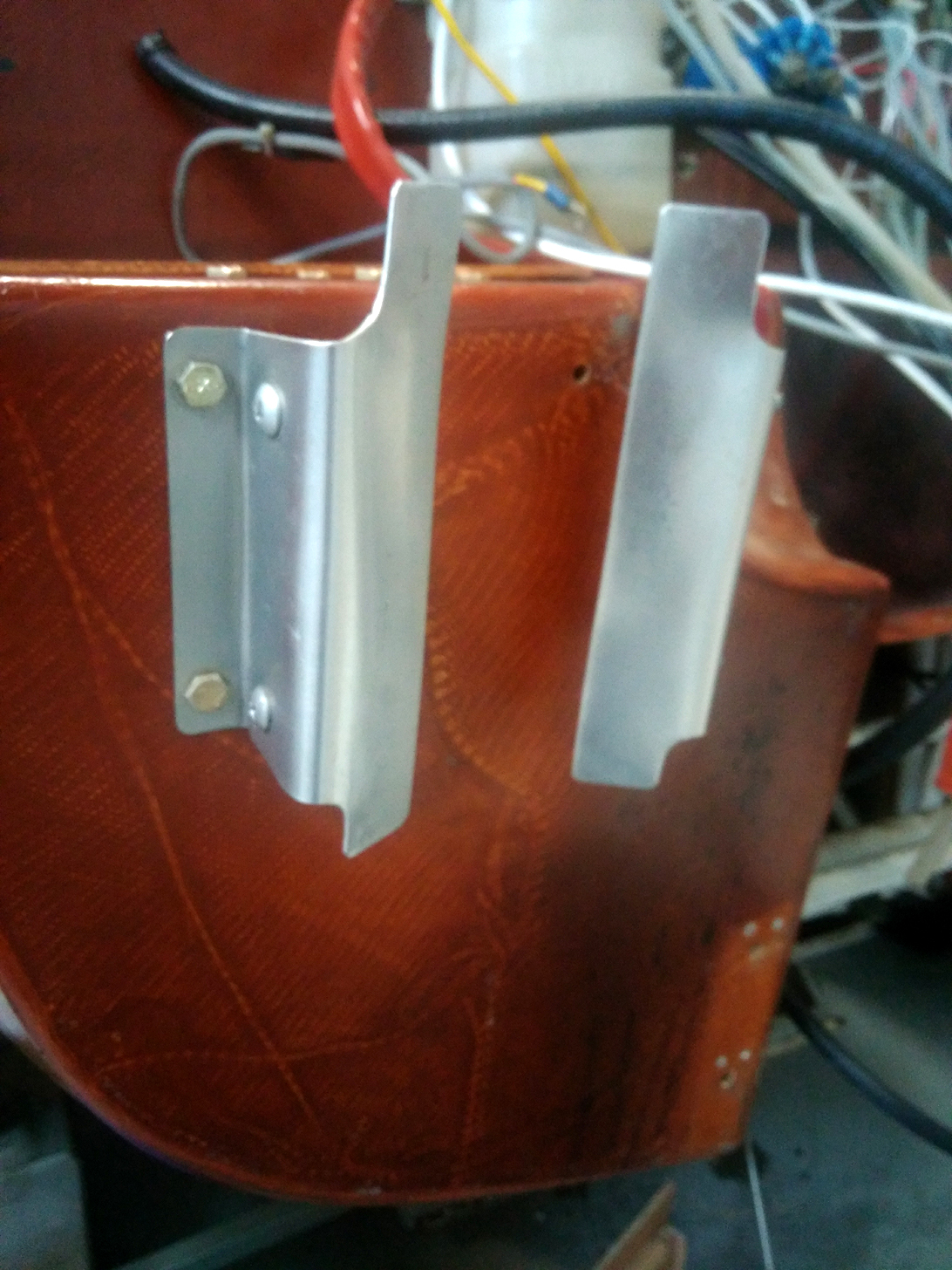

Hello all,
After craks on the original main oil tank bracket, I have made a small mod and now no problems.
Michel AUVRAY
[img]cid:part1.28785E18.7E1CC78F(at)orange.fr[/img]
