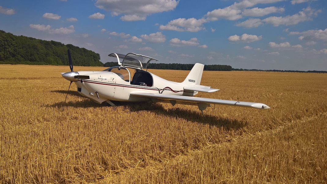

I got both airmaster warp drive and woodcomp 3000 wide blade with smartavionics controller on my Europa XS.
Both are good props, but my preference is on the airmaster. The warp drive blades are really sturdy (more noisy than the other ones and slightly slower), but no way I would land on a field with limited clearance with a woodcomp or a whirlwind blades.
I am happy to be back with the airmaster warp drive. Working, easy, no maintenance and good enough performances!
