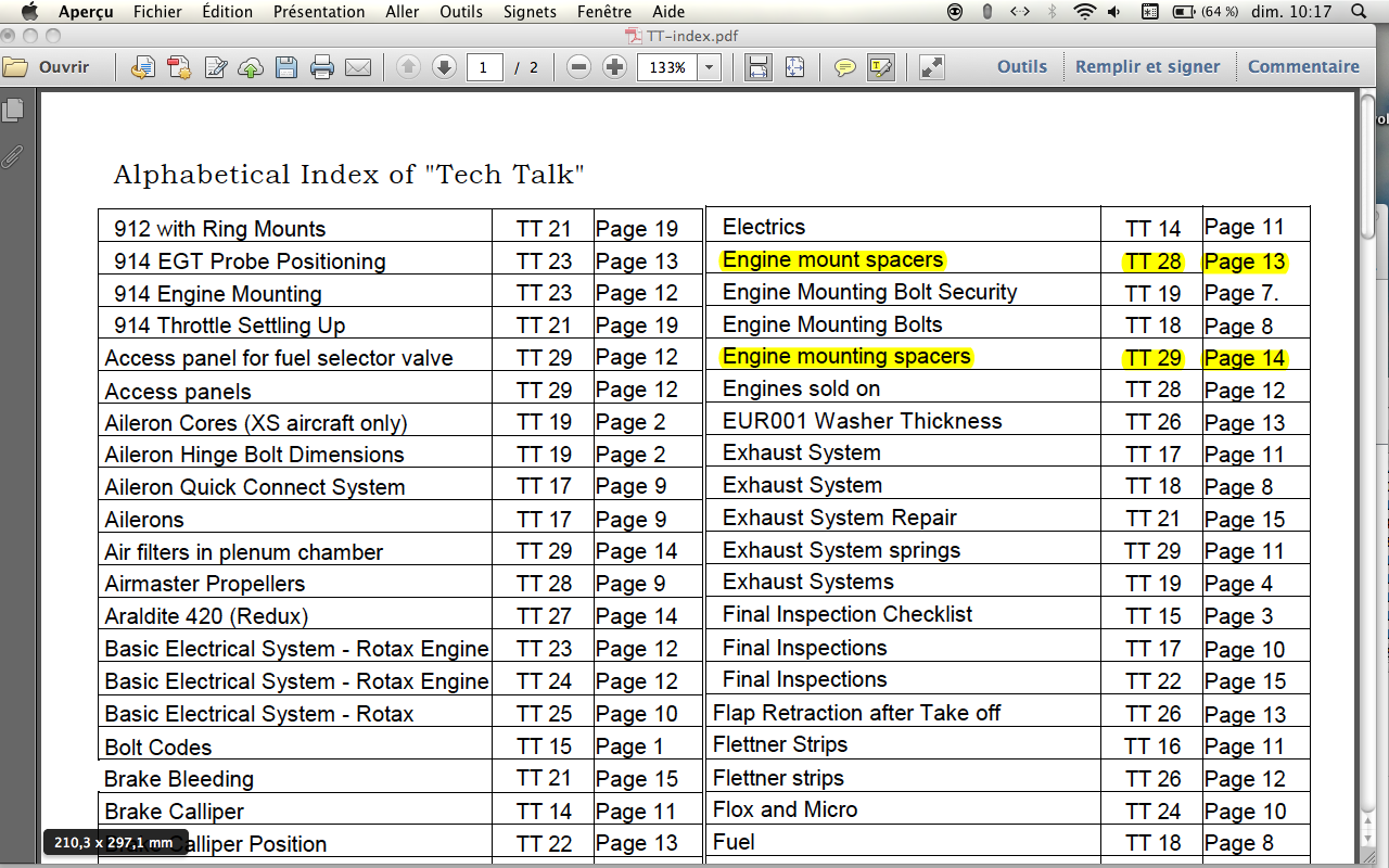

Thanks Dave for the information. I investigated further and found there were a change in 2003 regarding the spacers and bolts length. There should be some details about that in Factory Tech Talk number 28 and 29 (see attached index) . I searched for those issues on both Europa Aircraft and The Europa club websites and could not find them. Could any one provide the relevant pages from those issues of Tech Talk?
Remi

Alfred Buess
Joined: 11 Jan 2006
Posts: 67
PostPosted: Sun Nov 06, 2016 1:57 am    Post subject: Re: Engine rubber mounts Reply with quote
Bonjour Rémi
Attached are the relevant pages of Tech Talk 28 and 29.
Meilleures salutations, Alfred

PostPosted: Sun Nov 06, 2016 2:23 am    Post subject: Engine rubber mounts Reply with quote
Hello Remi,
The only reason the Engine Mount Spacers were mentioned in two Tech Talks
was because of an error in Issue 28
I have attached copies of both so you can see the full story for yourself.
Kingsley in Oz. (Met you at Sywell in May or June 2014)

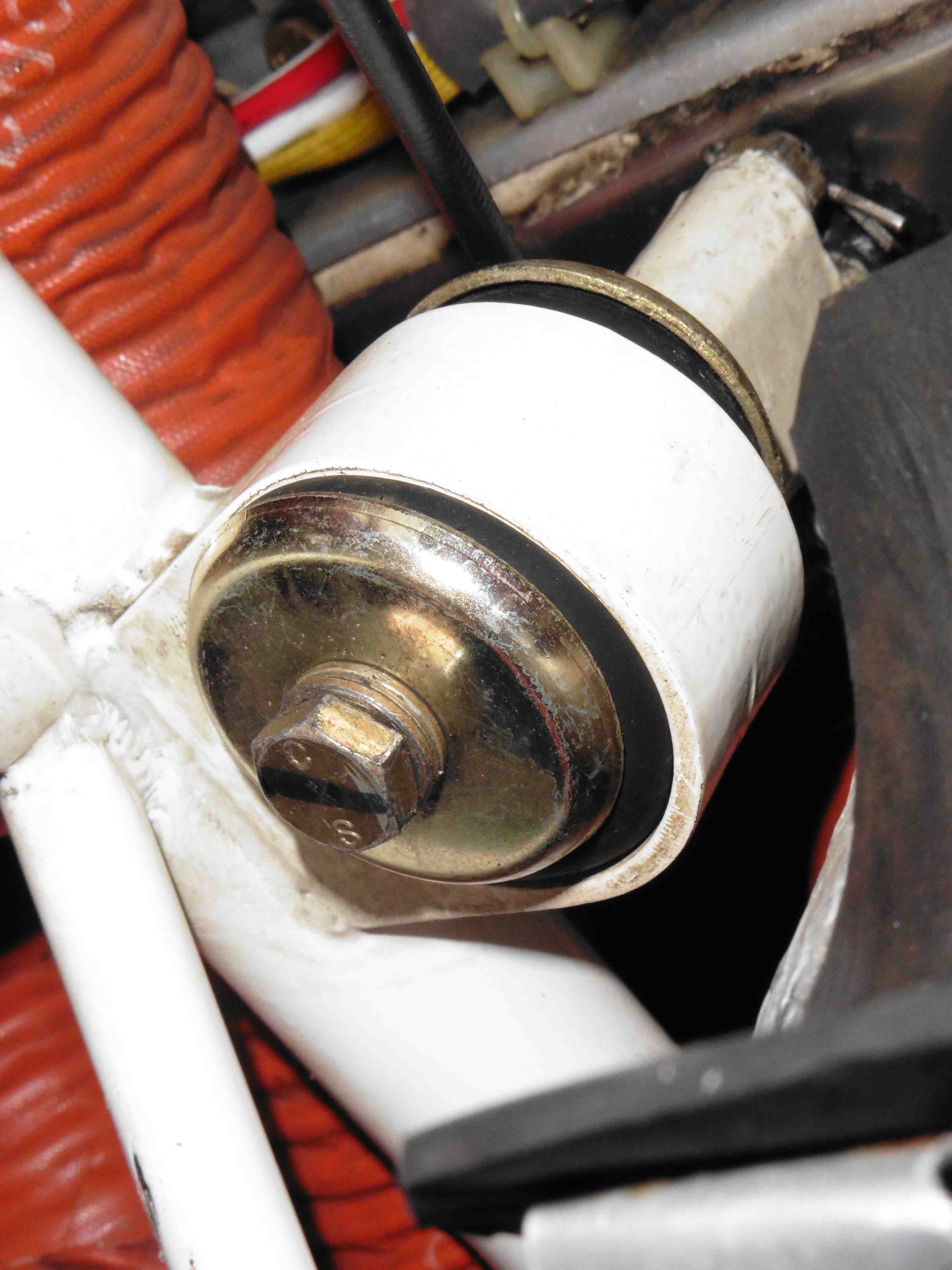

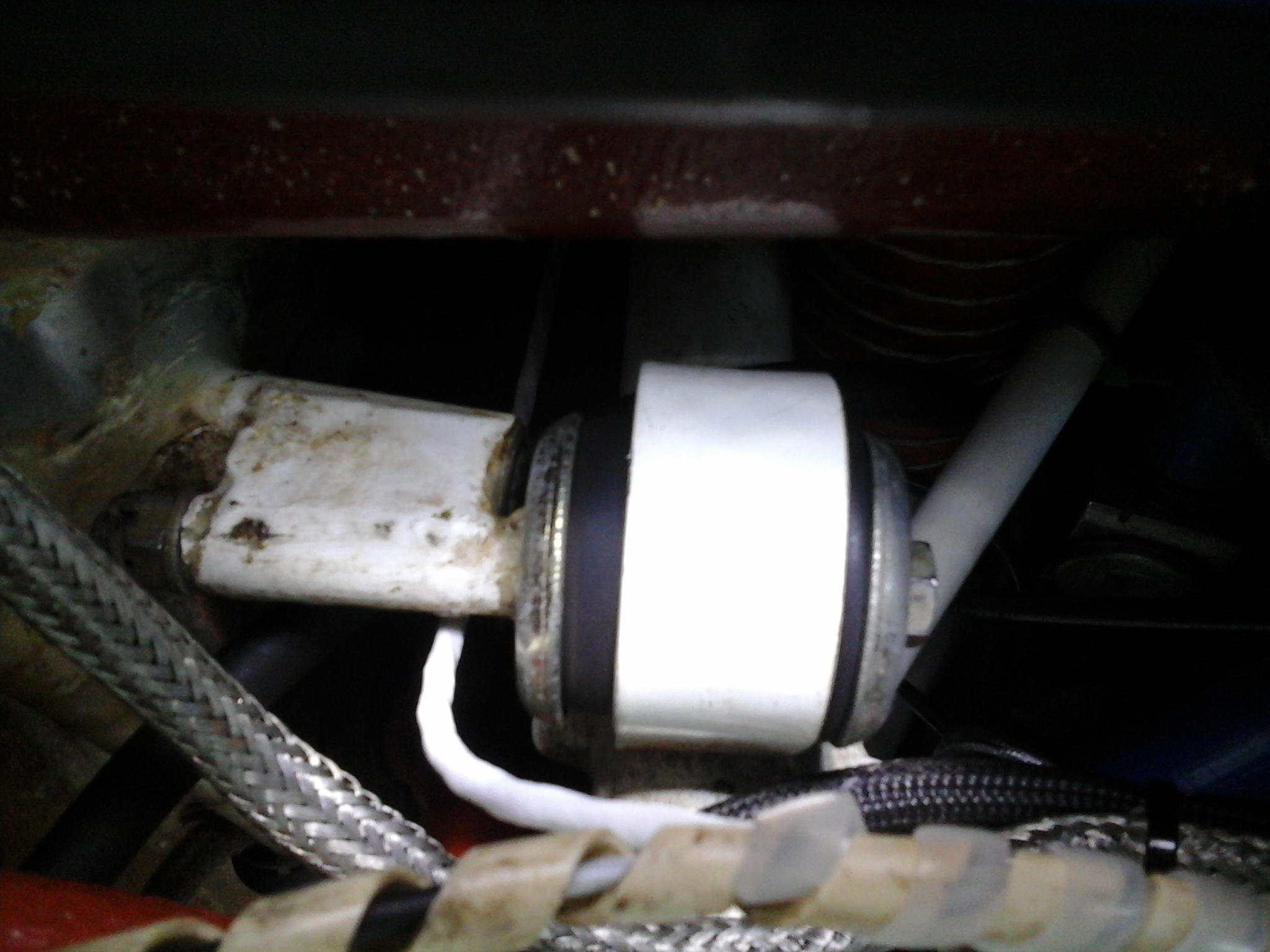

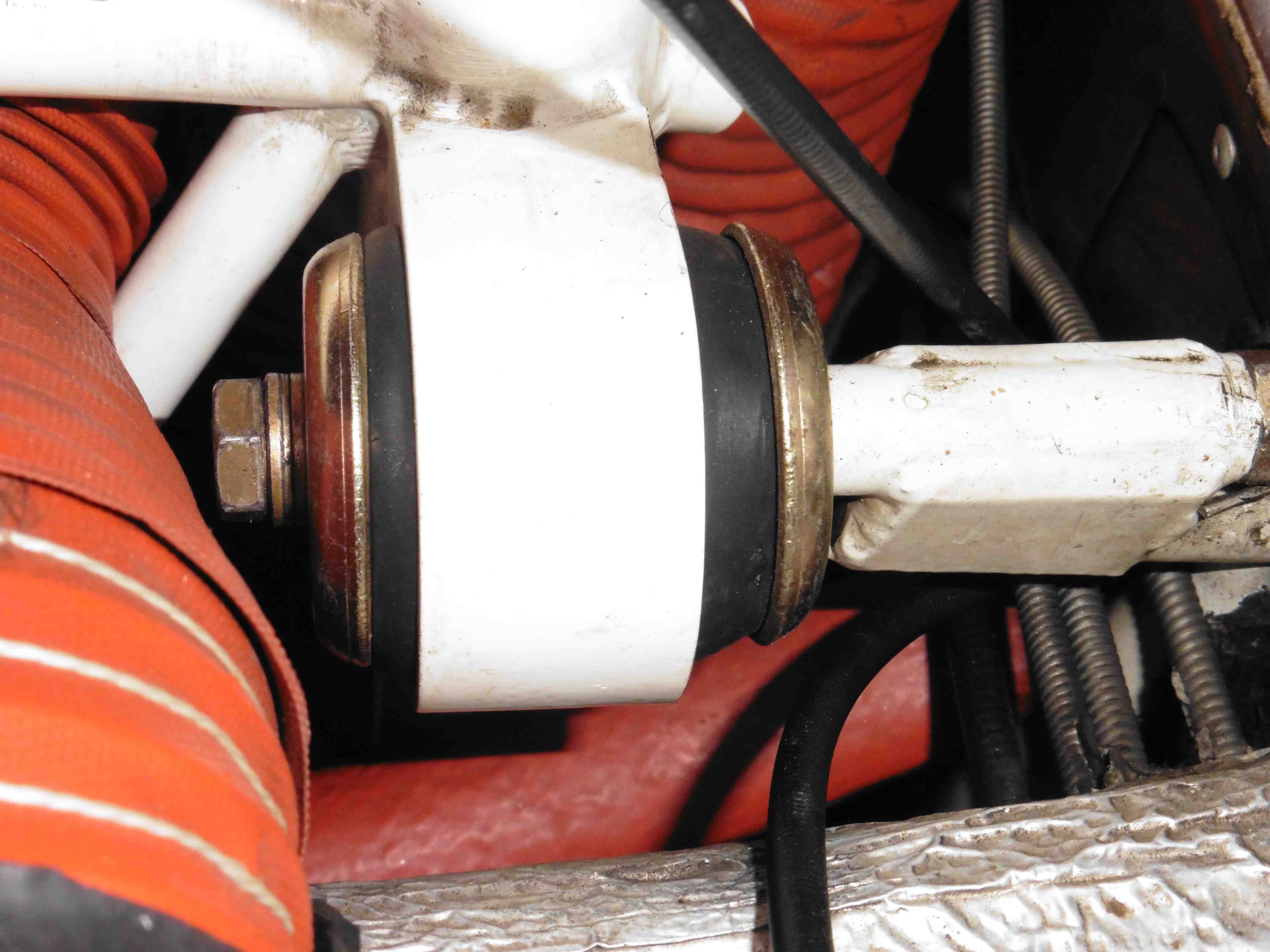

Yesterday I started to remove stuff from the engine compartment with the intention of compensating the sagging using washers to shim the engine mounts. What I saw was worse than expected. See attached pictures. Obviously the new rubber mounts are a lot softer than the old ones. I am even wondering if such a configuration is airworthy and I am looking for advice on that point.
Now what to do? The best would be to replace the rubber mount by the right ones. I questioned Europa-Swift: they keep saying the supplied rubbers are the same as before, so I do not expect a solution from this side. Buying direct from their supplier: does anyone know the supplier name and part number of those rubber mounts?
Remi

Hi Remi,
You show quite a bit more rubber sticking out either side than I see on mine, are you sure the outer large washers are fully clamped between the spacers? The rubber mounts don't seem fully compressed.

Yes Martin, the rubber mounts are fully compressed. I have done further investigation today. I hoisted the engine and surprisingly the rubber mounts did not come back to their symetrical position. Obviously there is a problem with the material (not completely cured?) which leads to a permanent deformation. I will probably re-install the original rubbers which are in very good shape, a lot better after 16 years and 1400 flight hours than the new ones after 10 months/80 hours.

PostPosted: Fri Nov 11, 2016 11:02 am    Post subject: Engine rubber mounts Reply with quote
Hi Remi,
After your eMail this morning with the photos of your rubbers you had me worried.
So when I got to the aerodrome this morning I straight away checked mine, which you will recall I replaced with new in May.
First off my spinner is in exactly the right position, so looking good. Next I removed the cowling and I could see that my rubbers are exactly as they should be. Phew!!!! I'm sorry that this doesn't shed any light on your problem though.
Dave Watts

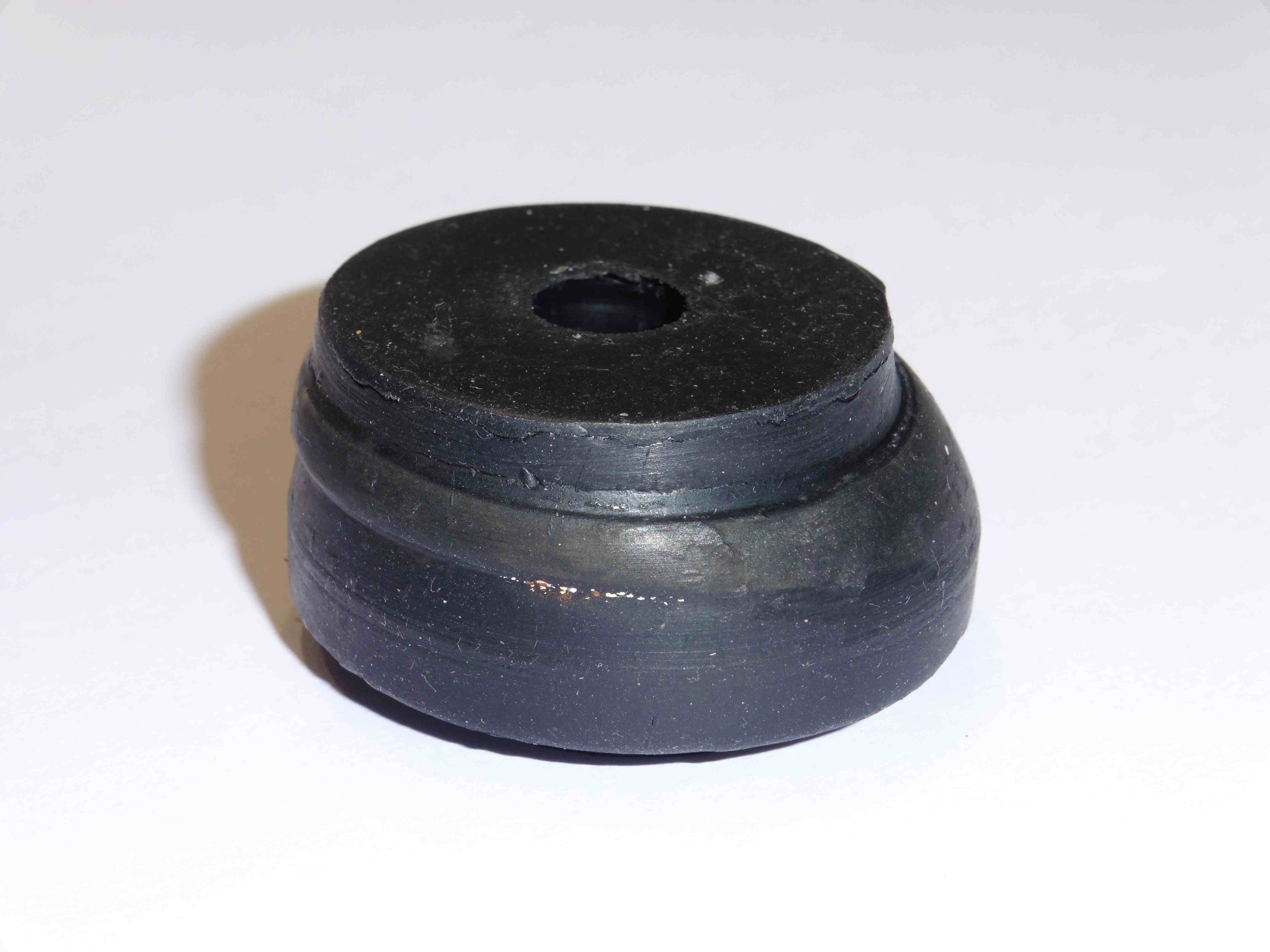

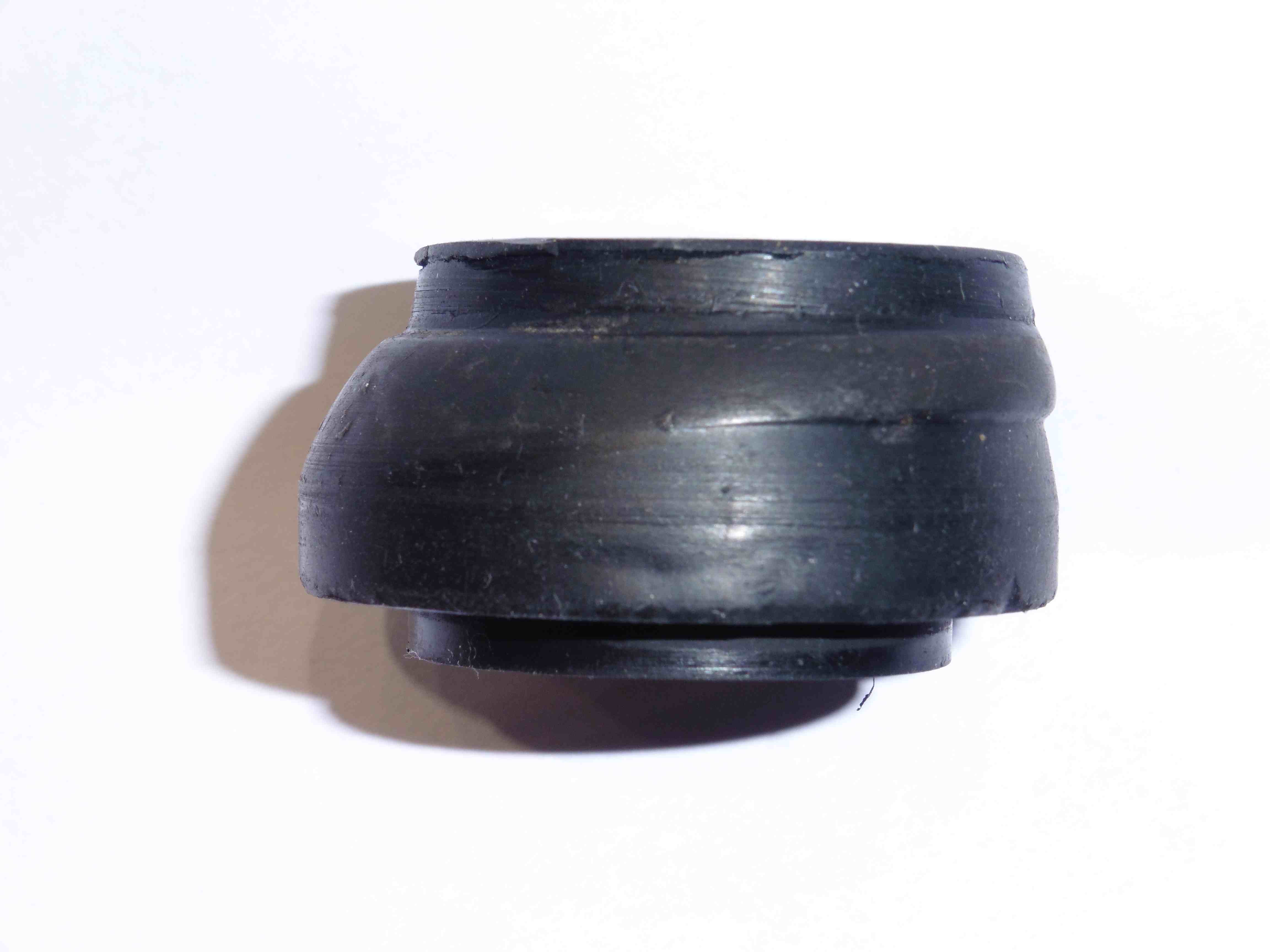

Today I removed those bloody rubber mounts. The attached pictures of one of them show how much they are damaged and out of center. They all are more or less like that. I will return them to Europa for investigation. I re-installed the 16 year old ones (which by comparison are like new) and the engine is back to its normal position.
Remi

PostPosted: Mon Nov 14, 2016 9:07 am    Post subject: Re: Engine rubber mounts Reply with quote
Hi Remi,
I agree with you - there is definitely a problem with some of the MT4s supplied by Europa recently.
My mounts fitted in June 2015 have exactly the same problem as yours and I have had to re-shim the mountings which, as you know, is a heck of a job. Although I managed to restore the spinner to cowl alignment it's evident that the engine is continuing to sag on its mounts and the MT4s will probably have to be replaced in the not too distant future.
The comments on the forum about spacer lengths didn't apply to mine, I have the correct spacer and bolt length - of course the bolts are fully tightened to compress the end caps onto the spacers.
If other Europa owners are not experiencing this problem, there are a few possibilities:
1. They have MT4s from another batch
2. Maybe they haven't replaced theirs recently (which is tempting because it is a heck of a chore every 5 years).
3. Maybe they've not noticed or have noticed but couldn't be bothered to do anything about it. (Unlikely)
4. Only you and I have been unlucky to receive 2 separate rogue sets. (Unlikely).
5. They've removed the spacers or shortened them further (unlikely).
I wonder if anyone on the forum any knowledge of the supplier for these mounts?
In any case I have e-mailed Karen to let her know that I too have experienced exactly the same problem as you. I have asked her if she could investigate if their stock has the correct stiffness and I await her reply.
It's going to be important to resolve this because there's no point in ordering new MT4s until we know they are OK and it could lead to the aircraft being grounded in due course.

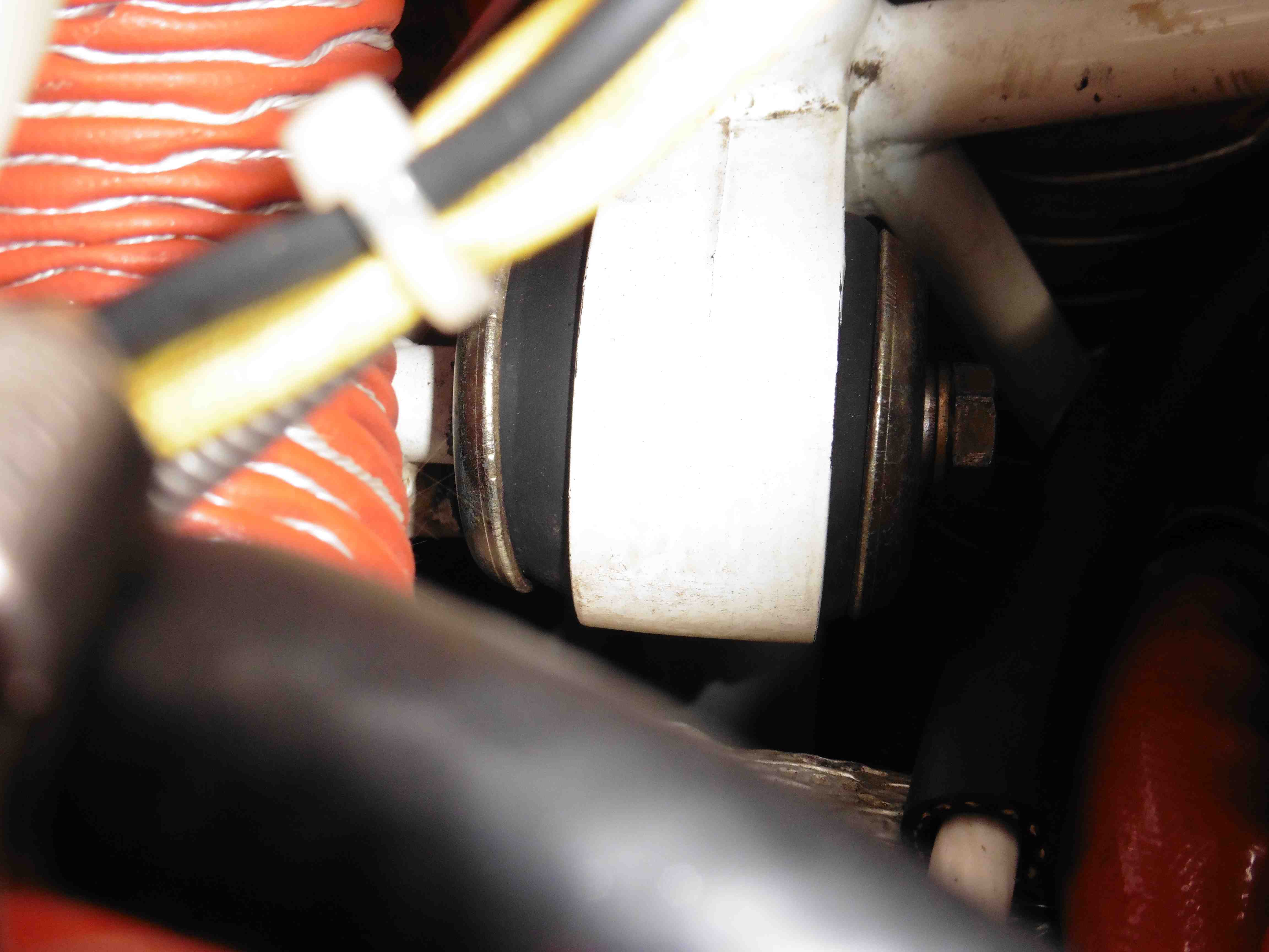

PostPosted: Fri Dec 16, 2016 6:44 am    Post subject: Re: Engine rubber mounts Reply with quote
Hi all,
any news on this?
I seem to have the same problem as Remi but even worse. I've purchased my rubber mounts from Europa in 2012.
I'm also considering to reinstall the old ones - odd enough!
