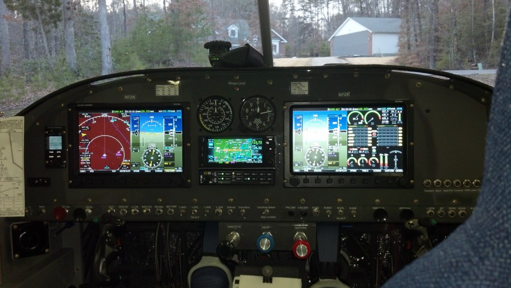

John,
I did not like having the other controls mixed in with the engine and prop
controls. I moved the Engine Alt Air to the left side of the panel apron,
next to the Oil Cooler Air butterfly valve control. The two cabin heat
controls on mid way on the right side of the apron. I replaced the provided
piece of angle for the engine controls with a new piece of aluminum (I bent
a piece of 0.050). In the attached photo the far left red control is for
Engine Alt Air. The black control next to it is for oil cooler air.
One other thing I did was to add a piece of 3/4" x 3/4" .063 aluminum
between the apron (near the engine controls) and the firewall. I did not
link the apron flex when moving the controls - the angle provides a much
more solid feel.
Note - this is the second panel in the RV-10. The first one lasted about 18
months. Since this photo the panel has again been twice modified to add the
Dynon Knob Panel (I don't know how I lived without it) and breakers and
light for a B&C aux alternator. My point being make sure you plan on panel
changes and modifications. You will not know what you want until after you
have some hours in the plane. For me replacing a panel is a new $27 panel
blank from Van's, cutting some holes and paint. If you get one of the really
nice custom panels your may find a modification harder to perform.
