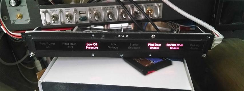

Mission accomplished!
The analyzer alarm LEDs will go out before the others at around 15% brightness. But above that, those LEDs are the same brightness as the others. I played around with different resistance values and determined that 18K between the source and gate provide the widest range and relative brightness.
Thanks all!!!
 Filesize:  40.76 KB
 Viewed:  8653 Time(s)
